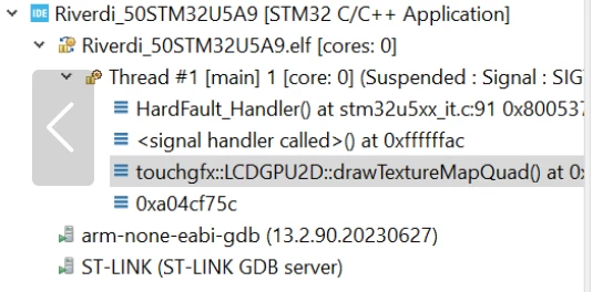

Everytime when the fault hits, there is no proper stack trace and the stack trace doesnt show the issue origin. The fault analyzer is showing PRECISERR in the window.

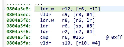

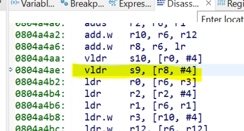

When I debugged further in assembly instructions, one time it faulted in vldr execution and next time it faulted in ldr execution.

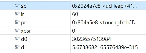

I am using STM32U5A9 processor from built-in RiverDI 5 inch display. I was able to see the Fault Analyzer's BusFault address, but I could get anything from that address in the memory view. All the data was in ?????
When I debugged further, I saw like this in the debugger.
Disassembly hit in this command:

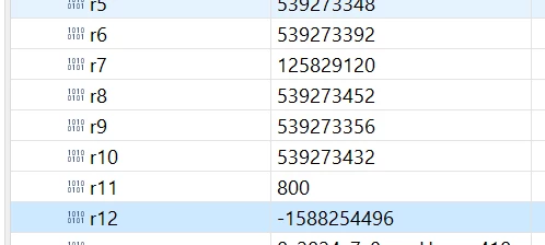

When I checked the registers r6 and r12, r12 seems to be an invalid memory location:

Could you please provide full screenshots on the call stack and the other errors?
