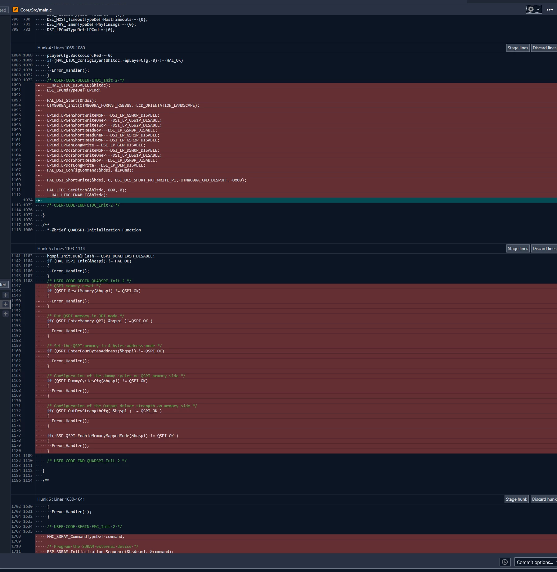

Hi, I'm going to necro-bump this topic because I somewhat randomly came across it again. I think this happens because for some reason when you check the peripheral pair box and regenerate, CubeMX removes code within User Code labels, including that which is responsible for setting up DSI, LTDC, QSPI and FMC in certain TouchGFX application templates, fyi @Martin KJELDSEN​ .
Here's my Git diff after checking the box, generating, and then unchecking the box then generating again. Red lines denote removals that occurred after the first generation, and persisted after the second. The whole list is about twice as long as shown in the screenshot. @Imen DAHMEN​ this is a fairly serious issue with CubeMX that should get another look. Using CubeIDE 1.6.0 with CubeMX plugin Version: 6.2.0-RC3.0693W00000BdJuFQAV.png

That looks scary. I haven't come across this issue in Stand alone CubeMX. Have you tried CubeIDE 1.6.1 plugin? It probably uses CubeMX 6.2.1 (latest official).

Just tried it with standalone CubeMX 6.2.1 and it does the same thing.

Check that you are setting the QSPI in Memory-mapped mode in the USER CODE section right at the end of the MX_QUADSPI_Init().
It needs to be set immediately at the end of MX_QUADSPI_Init(), not earlier, and not later.
It was some issues before where "generate peripheral initialization as a pair of '.c/.h/' files per peripheral" would not generate the USER CODE section at the end of the MX_QUADSPI_Init(). But it seems that it is fixed in the last CubeMx version.
You should also check that MX_QUADSPI_Init() is called before MX_TouchGFX_Init();
