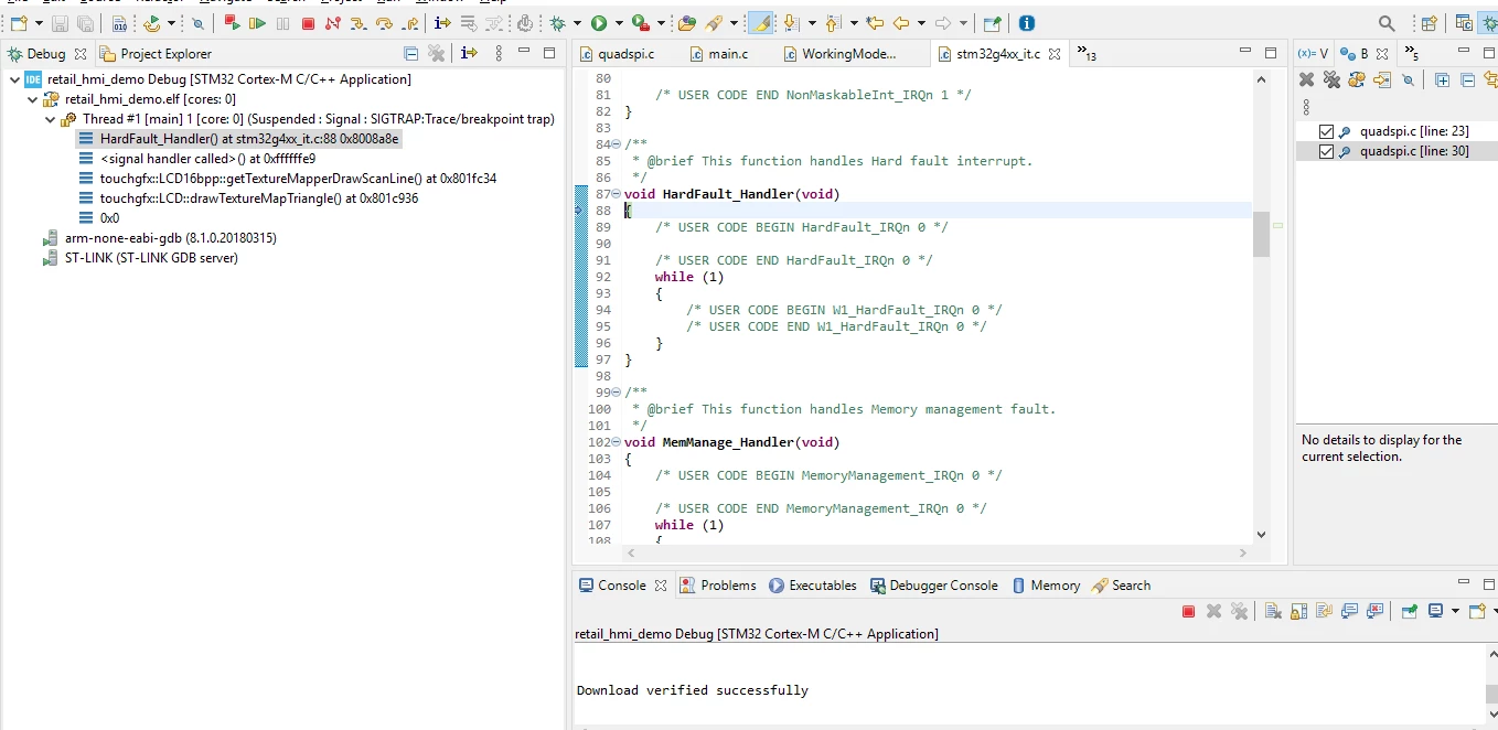

Hard Fault while accessing external flash memory configured in memory mapped mode

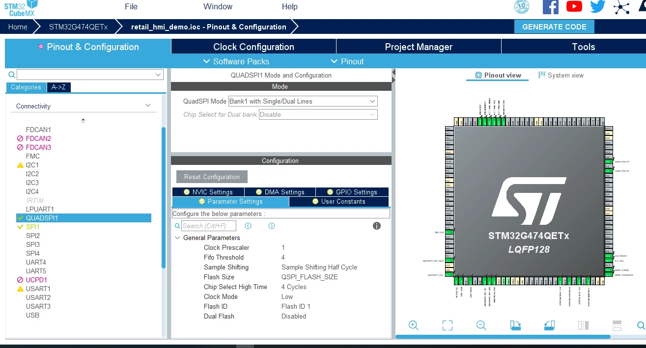

I have been working on implementing external flash driver integration with TouchGFX on STM32G474-eval board, in memory mapped mode.
I have configured the QSPI in Bank 1 with Single/Dual lines. I have attached an image of my CubeMx configuration.
I am getting hard fault while accessing any memory area of external flash. But, while in debug mode, I am able to access the memory address, for example: 0x90000000.

Could you provide some screenshots of the error ? Have you started your project from scratch ?

What make/model of flash part?
Whilst executing code or moving data?
Show a register dump and code at fault.​

External flash model is MT25QL512ABB-Micron. I want to configure QSPI in single/Dual mode, not in Quad mode.

Ok, but that's the Hard Fault Handler, not the site of the fault itself.
You need to go unpack what was happening in the getTextureMapperDrawScanLine()
Why do you erase the memory in the initialization code, won't that break things? ie pointers loading as 0xFFFFFFFF ?
The initialization code makes little sense. You shouldn't need to write enable
Look at the STM32G474-EVAL BSP code
