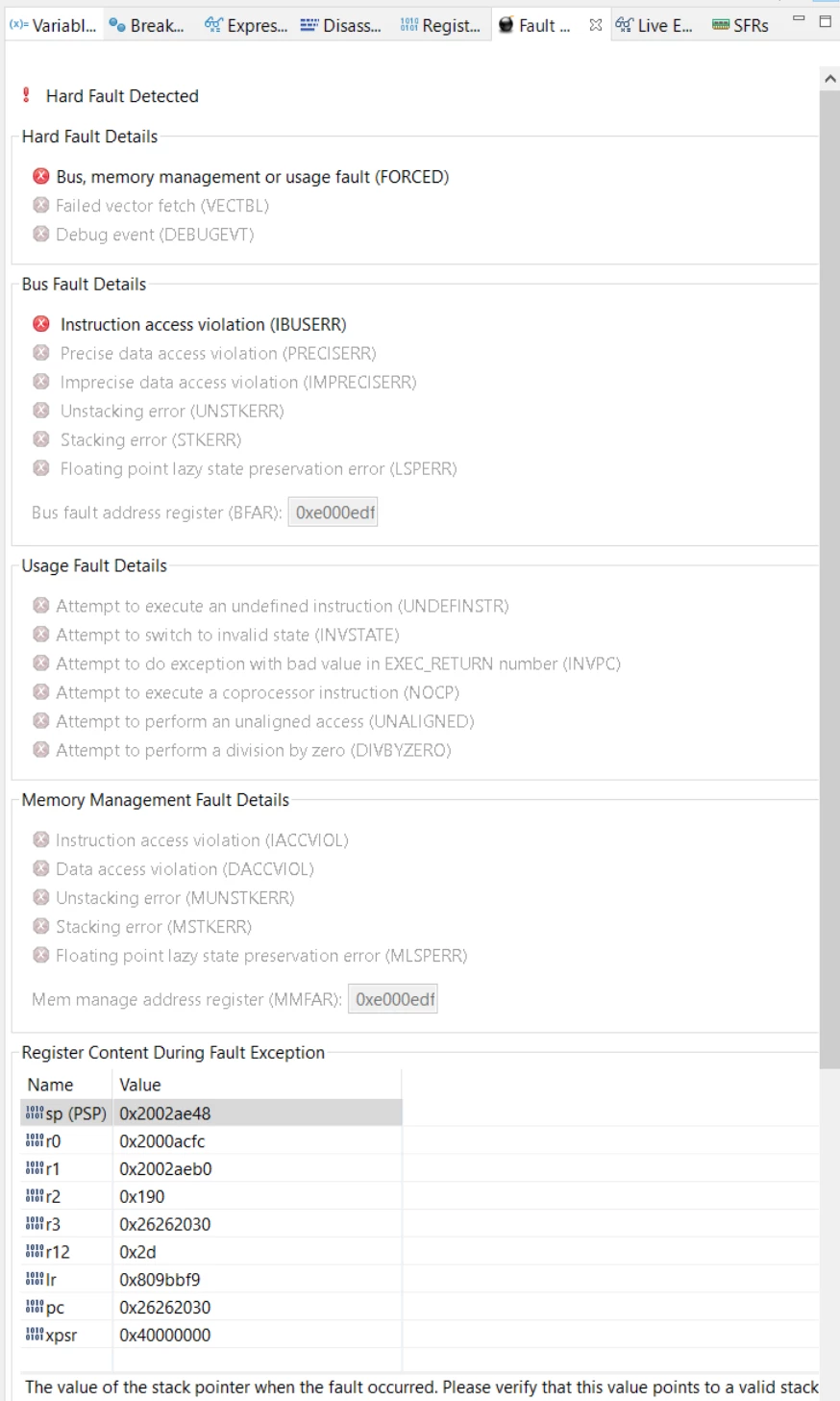

When entering the Hard Fault handler, the fault analyzer gives us the following flags:
0693W00000Ho0wwQAB.pngSo, by looking at the flags, I believe that this was a Bus Fault which transformed into a Hard Fault although it does not mention if the data access is precise or not. The address stored in BFAR seems to not have been updated and does not help to locate the fault's origin.
The SP register points to the address 0x2002ae48 which is within the scope of the stack of the TouchGFX stack which, along with all the other tasks I've set up, does not seem to have otherflown (lots of 0xA5A5A5A5 default values still present in all stacks). I can also add, by looking at the value of "pxCurrentTCB", that the Hard Fault seems to have occurred while the TouchGFX task was on.
The PC register is pointing to the address 0x26262030 which is outside the scope of the internal RAM which stops at 0x20050000.

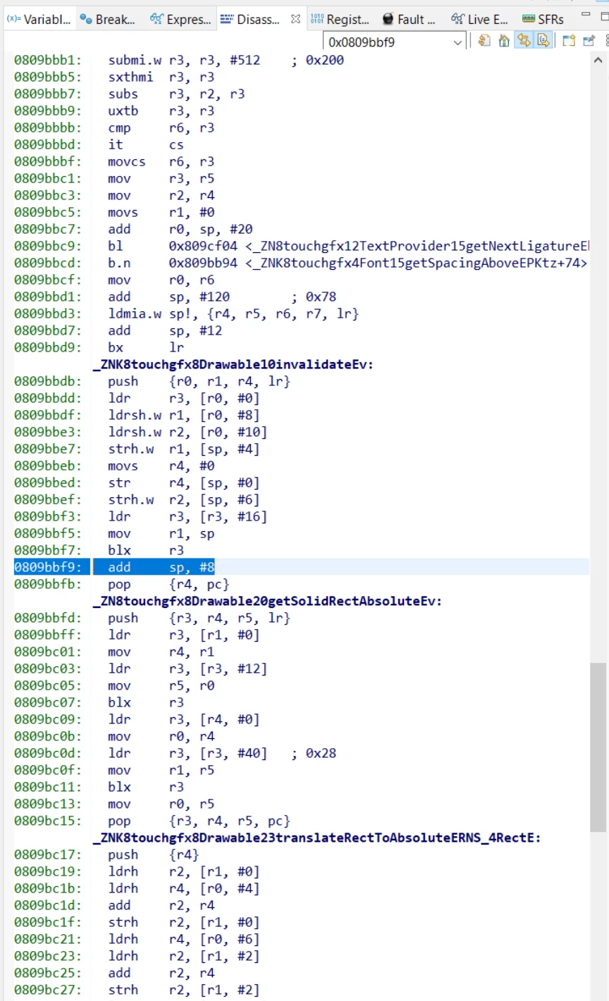

Finally, the LR register points to a Flash address at 0x809bbf9. Going into the disassembly, we can see the following instructions around that address :
0693W00000Ho17uQAB.pngThe Hard Fault thus seems to be triggered by the function "touchgfx::Drawable::invalidate()" called before the screen transition. However, for me, the trail stops there since putting any breakpoint into the source/assembler code within the invalidate() function stops the process of the code and is thus never reached.
