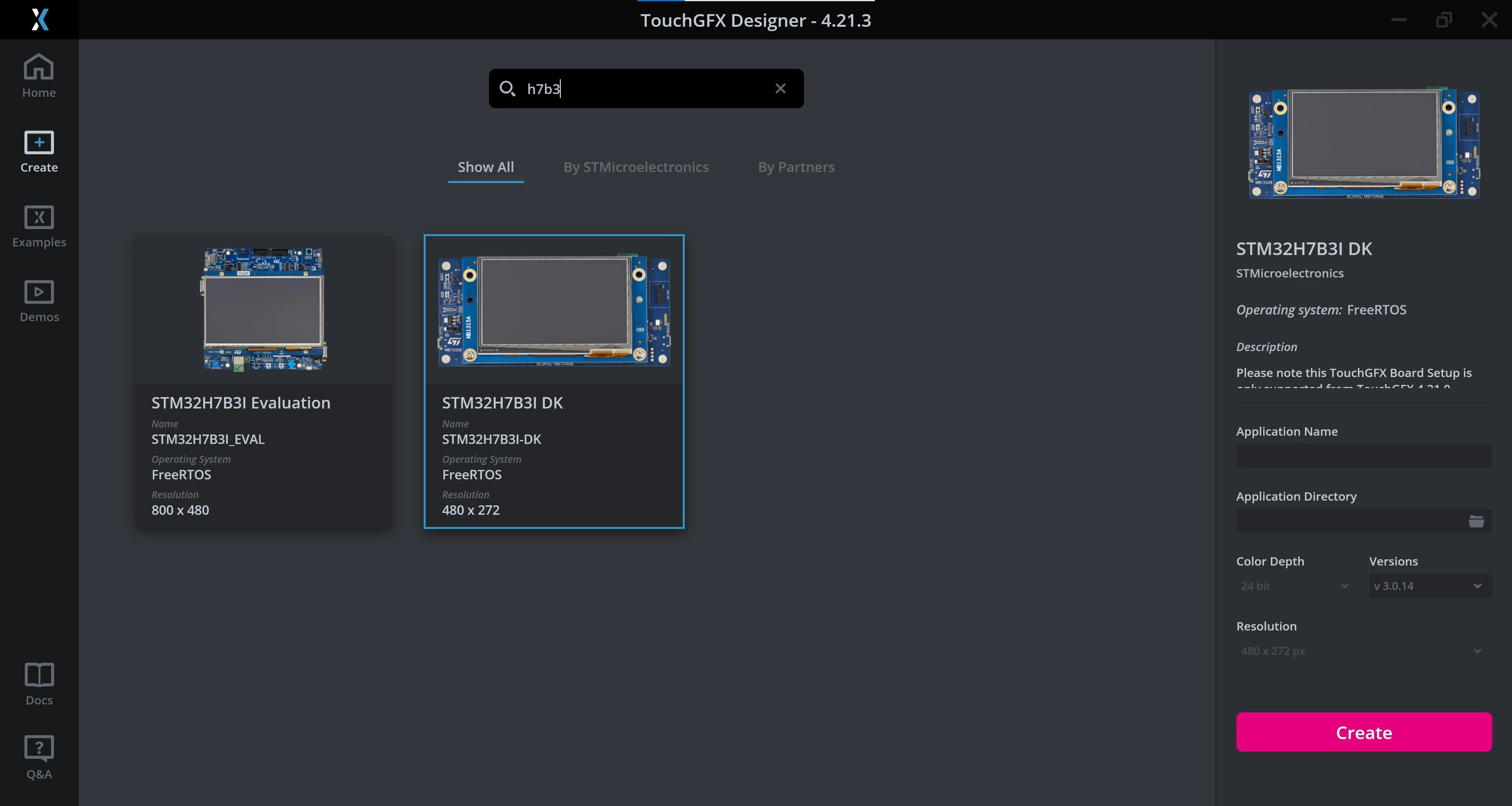

    Jan 29, 2024 9:11 AM UTC
    Hello @Ayoub_Bnina ,
    Are you working on a custom project that you have made in STM32CubeMX and trying to enable TouchGFX on it?
    Or are you using a TouchGFX Board Setup and you are facing the issue?
    TouchGFX provides Board Setups for users to develop GUI for their applications easily and download it onto the board.
    STM32H7B3I-DK Borad SetupSTM32H7B3I-DK Borad Setup
     You can see an example of how it is done here .
    I hope this helps
