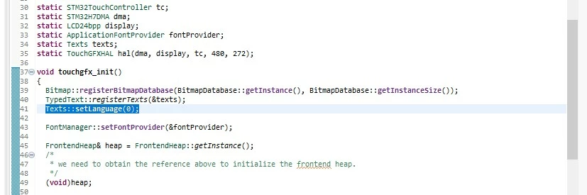

Hi Touch GFX team,
Throwing a hard fault error after the,
Texts::setLanguage(0);
0693W000008GdW5QAK.jpgCube ide version 1.5.0
Cube MX version v6.1.1
Please suggest a solution

Where is that line of code ? Did you start a project from scratch or from one of the application templates for ST dev kits available from TouchhGFX Designer ?
The setLanguage function expects a Language ID, not sure if the 0 makes sense.
I would advise looking at the UI template "Custom Trigger Action Example" or the "Demo 1" to understand how the setLanguage function is set and used. You can use the generated code as inspiration for your project.

hi, i have no idea about GFX but, maybe setLanguaje expects a pointer as an argument?
Texts::setLanguaje(nullptr);

Look at the instructions that are faulting, and the registers at the fault.
All memories initialized?​

thanks,
I went through demo1, which helped me.
/megh
