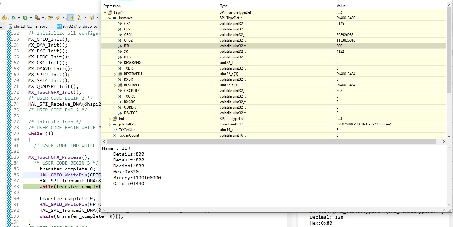

HAL_SPI_TxCpltCallback not getting called from HAL_SPI_Transmit_DMA
I am using the STM32H745XIH6 board and I have setup SPI using CubeMX in CubeIDE and for some reason, the HAL_SPI_Transmit_DMA never calls the HAL_SPI_TxCpltCallback unless I put a HAL_Delay after the function.

const uint8_t TX_Buffer[] = "Chocolate";
uint8_t RX_Buffer[512];
uint8_t RX_Buffer_cpy[512];
volatile int transfer_complete;

// HAL_SPI_Receive_DMA(&hspi2, RX_Buffer, sizeof(RX_Buffer));
 /* USER CODE END 2 */
 /* Infinite loop */
 /* USER CODE BEGIN WHILE */
 while (1)
 /* USER CODE END WHILE */
 MX_TouchGFX_Process();
 /* USER CODE BEGIN 3 */
 transfer_complete=0;
 HAL_SPI_Transmit_DMA(&hspi4, TX_Buffer, sizeof(TX_Buffer));
 //HAL_Delay(1); //Needs to be inserted so that transfer_complete = 1
 while(transfer_complete==0){};
 /* USER CODE END 3 */

 hqspi.Instance = QUADSPI;
 hqspi.Init.ClockPrescaler = 1;
 hqspi.Init.FifoThreshold = 1;
 hqspi.Init.SampleShifting = QSPI_SAMPLE_SHIFTING_HALFCYCLE;
 hqspi.Init.FlashSize = 26;
 hqspi.Init.ChipSelectHighTime = QSPI_CS_HIGH_TIME_3_CYCLE;
 hqspi.Init.ClockMode = QSPI_CLOCK_MODE_0;
 hqspi.Init.DualFlash = QSPI_DUALFLASH_ENABLE;
 if (HAL_QSPI_Init(&hqspi) != HAL_OK)
 Error_Handler();
 /* USER CODE BEGIN QUADSPI_Init 2 */
 initBspQuadSpi(&Error_Handler);
 /* USER CODE END QUADSPI_Init 2 */

Krautermann
Senior
Jul 10, 2023 11:06 AM UTC
Certainly. Please find file attached.
As for EOTIE, I can see it is not set to 1 for some reason while I debug it...
But when I run it, it seems that the HAL_SPI_TxCpltCallback is getting called because I inserted HAL_GPIO_TogglePin(GPIOI, GPIO_PIN_13); inside it and I can see the LED blinking...
Somehow the result from debug is different from Run...what is the reason for that?
