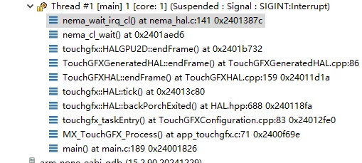

I made a custom board with STM32H7S7 , Touchgfx without OS, 2 framebuffers in psram(aps256xxn). At first ,after start
the debugging ,the display is normal,but after a while (random time),display is  freezing. Then I pause the program,I found
it stuck at nema_wait_irq_cl.
This is my screen:
This is information when stuck:
This project is a test project,the touchgfx code is simply rotate textureMapper1 and move red box on each frame

Hello ​@amb.
It sounds like the GPU is trying to execute incomplete commands from the command list. There can be several causes for this, one of which is an incorrect MPU configuration. I would highly recommend re-enabling the MPU and comparing your configuration against the TouchGFX Board Setup available in TouchGFX Designer, or referring to this section of the TouchGFX documentation: https://support.touchgfx.com/docs/development/scenarios/running-graphics-on-stm32h7r#mpu-configuration. Pay special attention to region 6, which covers the GPU2D command list. It is e.g. important to disable caching for the command list region. Otherwise, you risk not having all commands written to the command list before execution starts, which could result in an incomplete command list.
Which version of TouchGFX are you using?

I noticed the GPU2D have error callback fired,So I placed break point in this function:
val in first line is 464 every time,what dose this value means?What kind of error I am facing?
Can I ask some @ST support to help me out?

ambAuthor
Aug 19, 2026 2:40 AM UTC
hello ​@JohanAstrup
 Sorry for the late response.
During these days, I made a new pcb for H7R7 and APS256XXN,and carefully wired HSPI.
It finally works right(with Icache and Dcache and MPU all disabled ).
I will look into the cache and MPU later.
