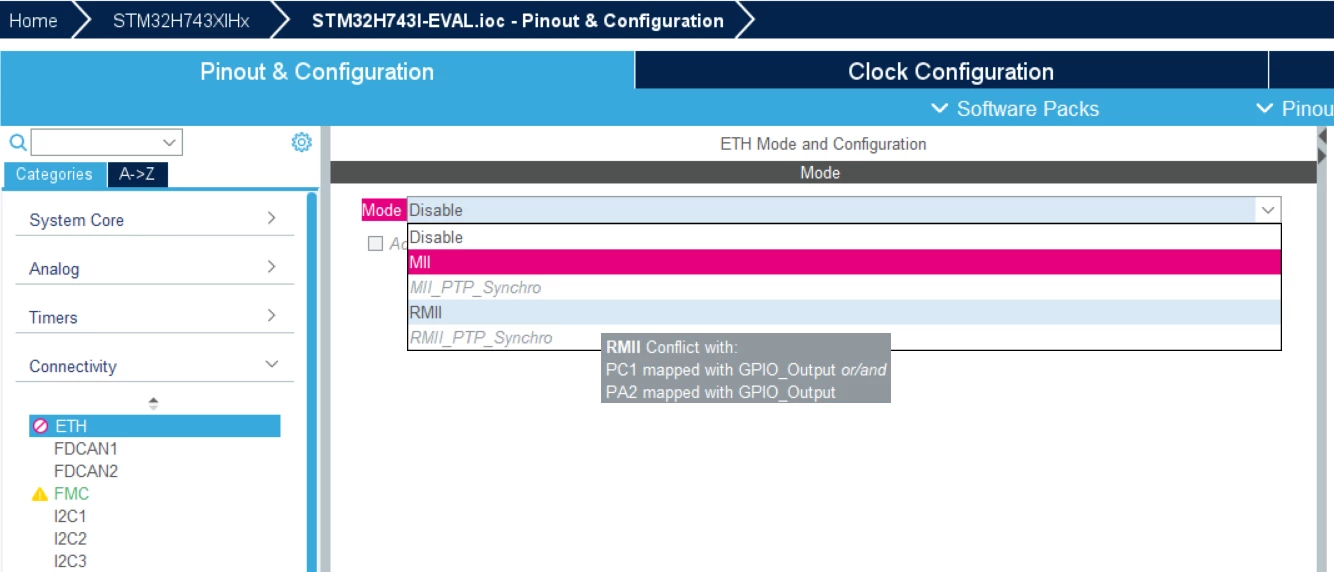

I use H743I Eval2 board , able to build application with TouchGFX to display data. I am trying to activate ETH with lwip middleware with CubeIDE. have enable CORTEX_M7 (Icache,Dcache) but can not select any mode (MII, RMII) in ETH, (a forbidden mark is showing) ,as result, lwip is also unable to select. please advice, thanks

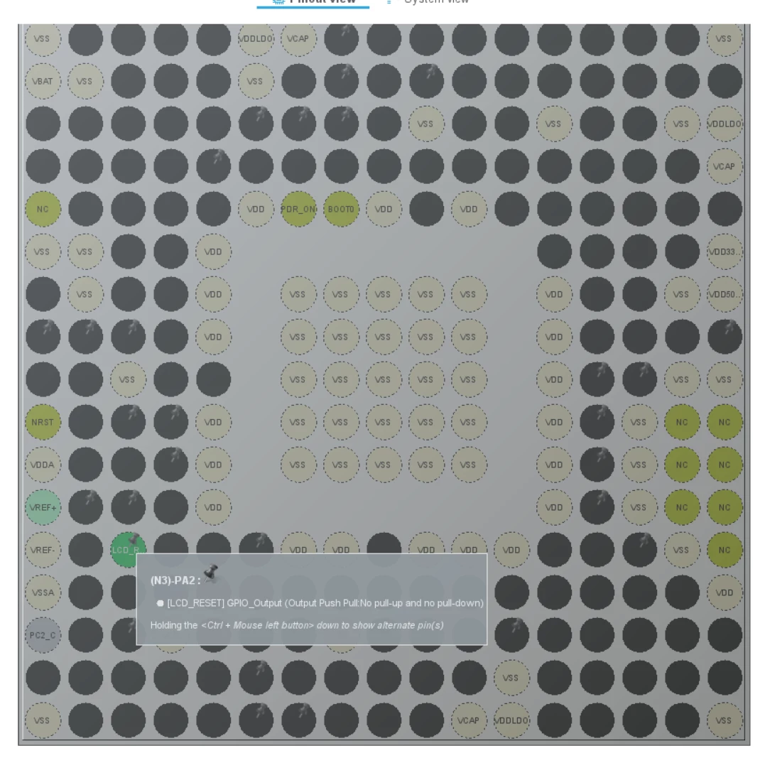

When creating a touchgfx application, it occupy lots of gpio such as ETH MII pins.
The solution is to try to change these pins to the alternate pins to solve conflicts, as shown in the screenshot.

Hello ET.2
Indeed, in STM32CubeIDE it's not possible to select natively ETH with the TBS we provide because apparently ETH uses PINS that are already used.
I guess what you can try to do is to change the used pins to something else and try to see if that solves your issue.

Indeed, I notice there are pin conflict issue , I have tried to simplify my app ,
1, use TouchGFX to create 2 box progress , 2 text area and 2 text progress
2, generate code with CubeIDE, compile is ok, thats all
3, open ioc , in ETH tab, it just appears forbidden sign
4, if select clear pin out, whole bunch of error occur (as expect) as below

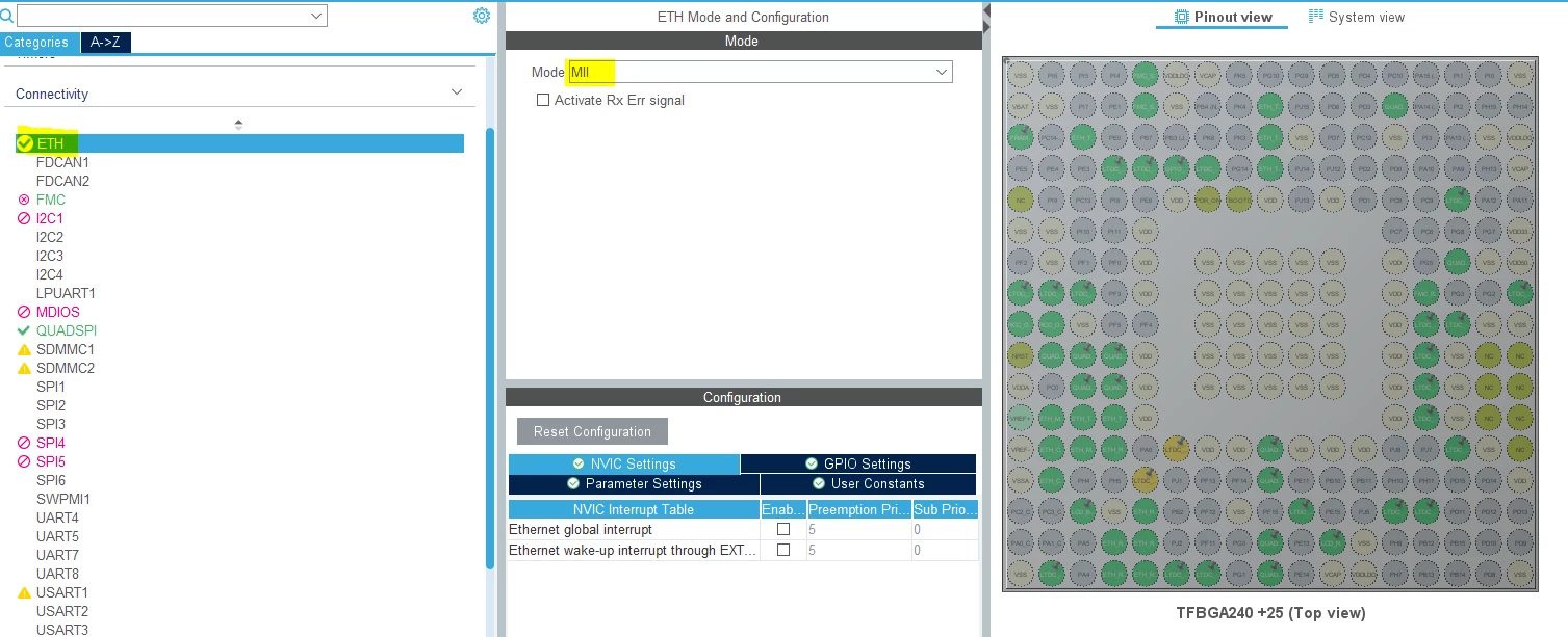

Hello @ET.2​ ,
At first, let me thank you for reporting this issue.

Mar 24, 2023 12:57 PM UTC
I fixed it, thanks for the reply.
