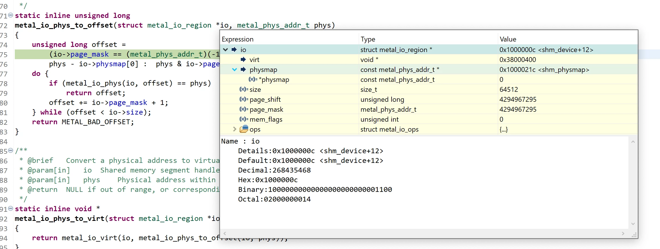

So this is with a TouchGfx Cube v6.7.0 generated project with FW 1.11.0
I have added OpenAmp via Cube and based the code I am adding on the old PingPong example.

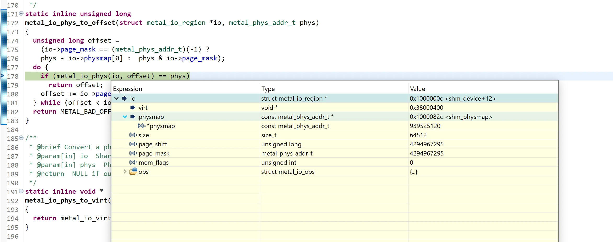

The following line fails with -2005 (RPMSG_ERR_BUFF_SIZE):
int32_t status = OPENAMP_create_endpoint(&rp_endpoint, RPMSG_SERVICE_NAME, RPMSG_ADDR_ANY, rpmsg_recv_callback, NULL);
This is due to the metal_io_region being incorrect, physmap as far as I can see should be 0 but it is 939525120 (0x38000400).
This first image is the values in the working PingPong example:0693W00000aPN5rQAG.png
The second image is in the non working code:
This can be tracked down to OPENAMP_shmem_init() in openamp.c.
In the working PingPong example openamp.c is from 2019 and we have:
static metal_phys_addr_t shm_physmap[] = { 0 };
 metal_io_init(&device->regions[0], (void *)SHM_START_ADDRESS, shm_physmap,
 SHM_SIZE, -1U, 0, NULL);
 shm_io = metal_device_io_region(device, 0);
The openamp.c from the cube project is from 2023 and in there we have:
static metal_phys_addr_t shm_physmap;
 shm_physmap = SHM_START_ADDRESS;
 metal_io_init(&device->regions[0], (void *)SHM_START_ADDRESS, &shm_physmap,
 SHM_SIZE, -1, 0, NULL);
 /* USER CODE BEGIN PRE_SHM_IO_INIT */
 /* USER CODE END PRE_SHM_IO_INIT */
That code to me looks wrong, if I change the code to:
shm_physmap = 0;
Now everything works, the call to OPENAMP_create_endpoint() now works.

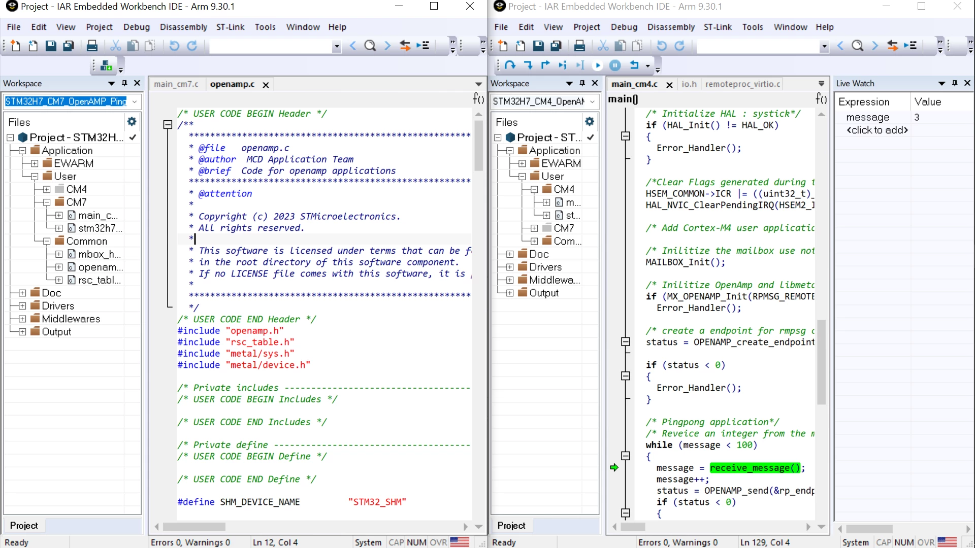

Could you please, provide more details about your software configuration. I guess you generated the code with CubeMX v6.7.0. Do you confirm the same issue with the latest version v6.8.0? If yes, could you please share your IOC file?
The test works for me on an STM32H747I-DISCO using the Cube firmware example as it is.

Hi @F.Belaid​ , yep the example works as it is using openamp.c from 2019, openamp.c from 2023 doesn't work though.
Using CubeMX 6.7 or 6.8 is adding openamp.c from 2023.
The ioc is attached.

Hi @ACapo.1​,
I tried to execute the example provided with openamp.c from 2023 and it worked.0693W00000bhHZCQA2.png
