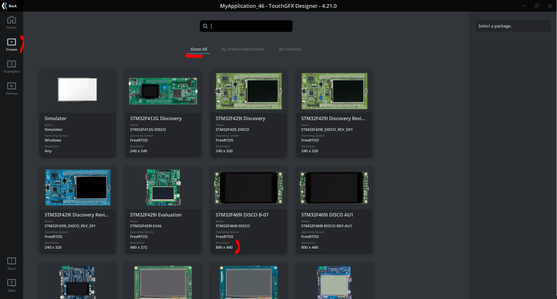

I am new to STM products. I want to start a GUI project and I have 2 questions before I start with STM kit.
  1. My project will involve 2 size of touchscreen. they are 800x480 and 1024x600. any one out of the two would be finalised after prototype.
  1. which kit would be good to start prototyping to evaluate and develop using touchgfx ?
  1. I have one more question that can we change the display which is available on kit from 4.3 inch to 7 inch or 10 inch to evaluate our app? what expertise level is required for that?

Romain DIELEMAN
January 17, 2023
You can find in the create section of TouchGFX Designer 4.21 all the boards and their display resolutions we have made pre configured projects for , as you can see in the screenshot below.
There are 7 ST board examples with a 800*480 resolution. For example the STM32F469dk has a MIPI DSI display with a 800*480 and 16bpp resolution. For 1024*640 resolutions, our partners Riverdi and EDT both have boards and examples available in TouchGFX Designer as well. All those boards are good for prototyping. Select the hardware as well based on what you want to do as they do not all have the same connectivity and capabilities.
0693W00000Y8MoZQAV.pngChanging a display to another can be more or less complicated depending on the display interface. Personally parallel RGB displays (LTDC) are the easiest to set up as you have almost no code to do yourself thanks to the TouchGFX Generator. You just need to follow our guideline in the online documentation. Badreddine has also made a video guide on the ST youtube channel on how to change displays on an STM32H7B3dk (going from an LTDC display to another).
