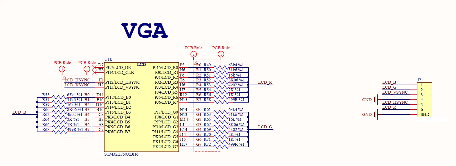

Hi everyone
I am working on a project with STM32H750 chip. I use internal flash for run application. I want to use vga display. So for this, I disabled touch controller and configured LTDC for vga. I fixid the erros and load tha aplication in chip.
When I try to run application, code goes to "hal.taskEntry()" but never go to "setupScreen()" funtion. I debug code until "OSWrappers::waitForVSync()" function. When in this function never returned back. Then code gone "vApplicationIdleHook" continuously.
I created project with TouchGFX designer with by choosing STM32H750 Disco board. Then I configured project with CubeMX. I use TouchGFX 4.15 software.
I completely stuck in here. Thanks for your opinion in advance.

For the additional information my used VGA circuit scheme is here;0693W000006EjbYQAS.png
Best answer by Yunus ARI
I did it step by step like you said and found the problem. My problem root cause is in external crystal. Probably hardware is wrong assembled. I select HSI clock an all problem is solved.
Thank you for helping.

Edit;
