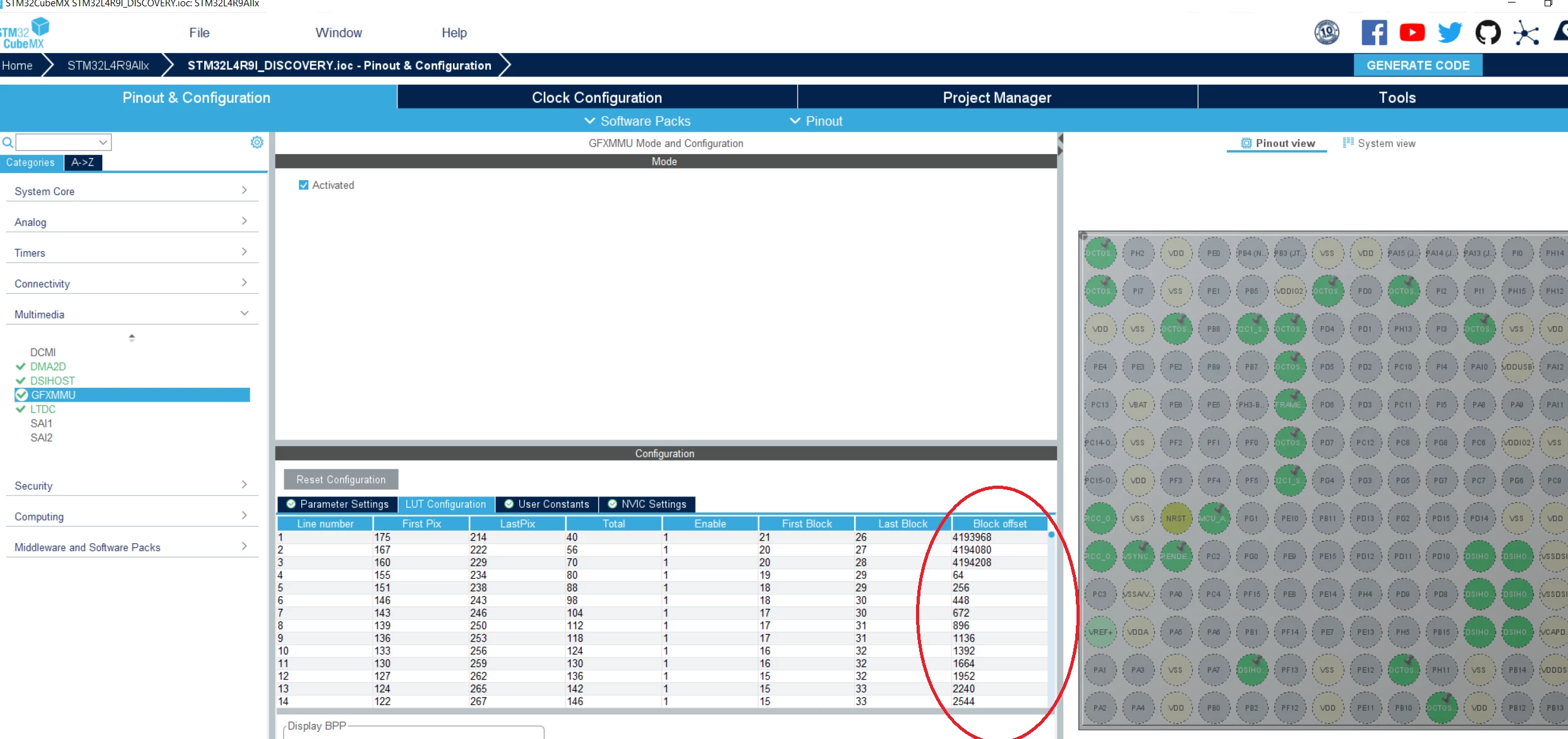

If you want to investigate more, I invite you to try to modify the gfxmmu_lut_config_touchgfx[] in gfxmmu_lut_touchgfx.h file. What we want to change is the address values here :
_legacyfs_online_stmicro_images_0693W00000bjb7vQAA.pngThese values are written in the table at each GFXMMU_LUTxH position like here :
uint32_t gfxmmu_lut_config_touchgfx[2*GFXMMU_LUT_SIZE_TOUCHGFX] = {
 0x001A1501, //GFXMMU_LUT0L
 0x003FFEB0, //GFXMMU_LUT0H <------------
 0x001B1401, //GFXMMU_LUT1L
 0x003FFF20, //GFXMMU_LUT1H <------------
 0x001C1401, //GFXMMU_LUT2L
 0x003FFFA0, //GFXMMU_LUT2H <------------
 0x001D1301, //GFXMMU_LUT3L
 0x00000040, //GFXMMU_LUT3H <------------
 0x001D1201, //GFXMMU_LUT4L
 0x00000100, //GFXMMU_LUT4H <------------
 0x001E1201, //GFXMMU_LUT5L
So If you take the value at the bottom and you place them at the top instead, then you'll have a vertical flipped display in theory (maybe you'll need to mirror it as well because the pixels will be placed from right to left in that case, you'll need to put it back from left to right).
