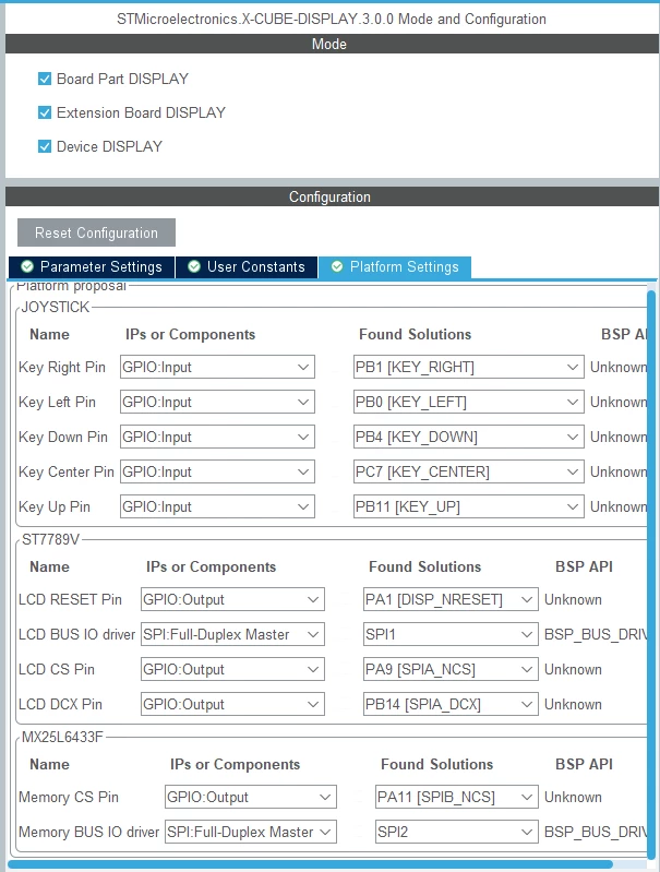

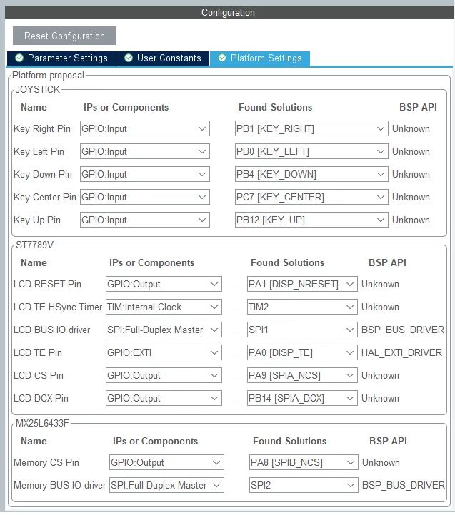

    Hi Gaetan. I have a couple of questions regarding the F303RE and the G071.  I'm specifically trying to 'match' the F303 to the G071 .ioc files in CubeMX.  There are differences in the pinouts of the MCU's, most of which I have managed to resolve however, I notice that in the X-CUBE-DISPLAY V.3.0.0 middleware (in the 'platform settings' tab), the configuration options are different on both despite being the same ST7789V driver as can be seen in the screenshots I have attached below.  Can you help me out with this?  I would like to know if there is a solution.
    The screenshot on the right is from the G071*.ioc file.  The LCD_TE and the LCD_TE HSync Timer options are unavailable to the F303RE (on the left).
    Thanks for your time.

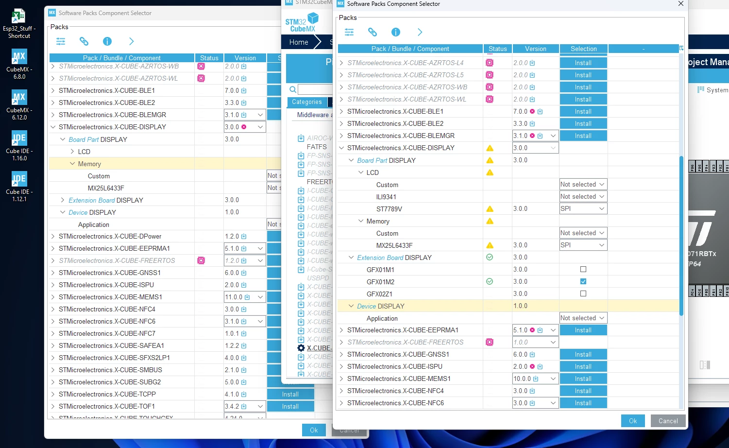

    Hi Gaetan.  Which version of the IDE/CubeMX are you using?  To have compatibility with X-CUBE-DISPLAY v.3.0.0, I think the latest versions of each you can use is v6.8.0 for CubeMX and v1.12.1 for CubeIDE.  At least this is what I believe to be correct (and is what I am using). Is the option 'greyed-out'?  I found that by clicking X-CUBE-DISPLAY, I have the option to configure access to the relevant display expansion boards, drivers etc. Once configured there will be a green tick against the X-CUBE-DISPLAY option and further configuration can be accessed by the tabs in the .ioc interface.
    Hope this helps.  Thanks for helping me out!

    ...first, you would need to download and install the X-CUBE-DISPLAY pack via the Help menu in the IDE.  Find the pack under 'Manage Embedded Software Packages' menu item.  Sorry, I forgot to mention this in my post.

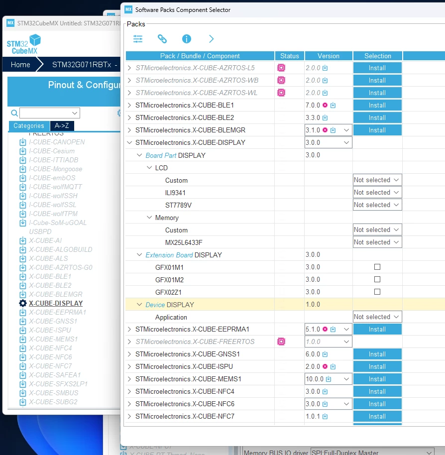

    Hello @Al-E-Bags ,
    STM32CubeMX version : 6.12.0
    TouchGFX version : 4.24.0
    Here is what I have done in order to try to have a working example to get inspired from :
    1. Create a new project directly from TouchGFX Designer
    2. Select STM32G071RB + GFX01M2
    3. Generate code from TouchGFX Designer
    4. Open folder
    5. Open .ioc file
    From there, the X-CUBE-DISPLAY is greyed out.
    I install it directly from STM32CubeMX.
    Then it is still greyed out, I look at what is selected and this is what I see :
    I do not understand how you managed to have a working example that uses X-CUBE-DISPLAY.
    The example created directly from TouchGFX Designer is a working example and it doesn't seem to use X-CUBE-DISPLAY.
    SO my questions are
    How did you end up with a working example that uses X-CUBE-DISPLAY for the STM32G071RB + GFX01M2 ?
    Shouldn't you just not use X-CUBE-DISPLAY?
    Regards,
    Gaetan GodartSoftware engineer at ST (TouchGFX)
