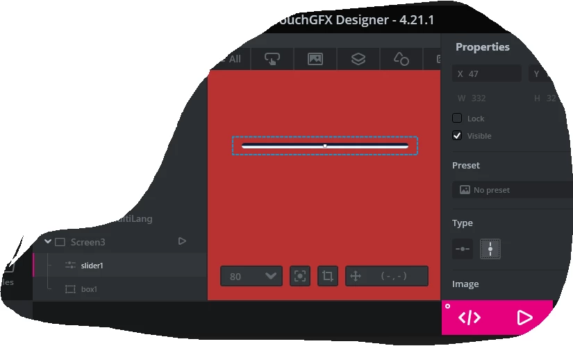

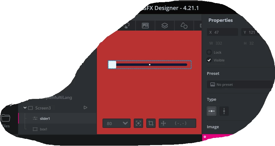

when I place a slider on screen i see this - horizontal by default:
0693W00000YAgzgQAD.png Then I change to vertical and this is shown:
 Is this a bug ?

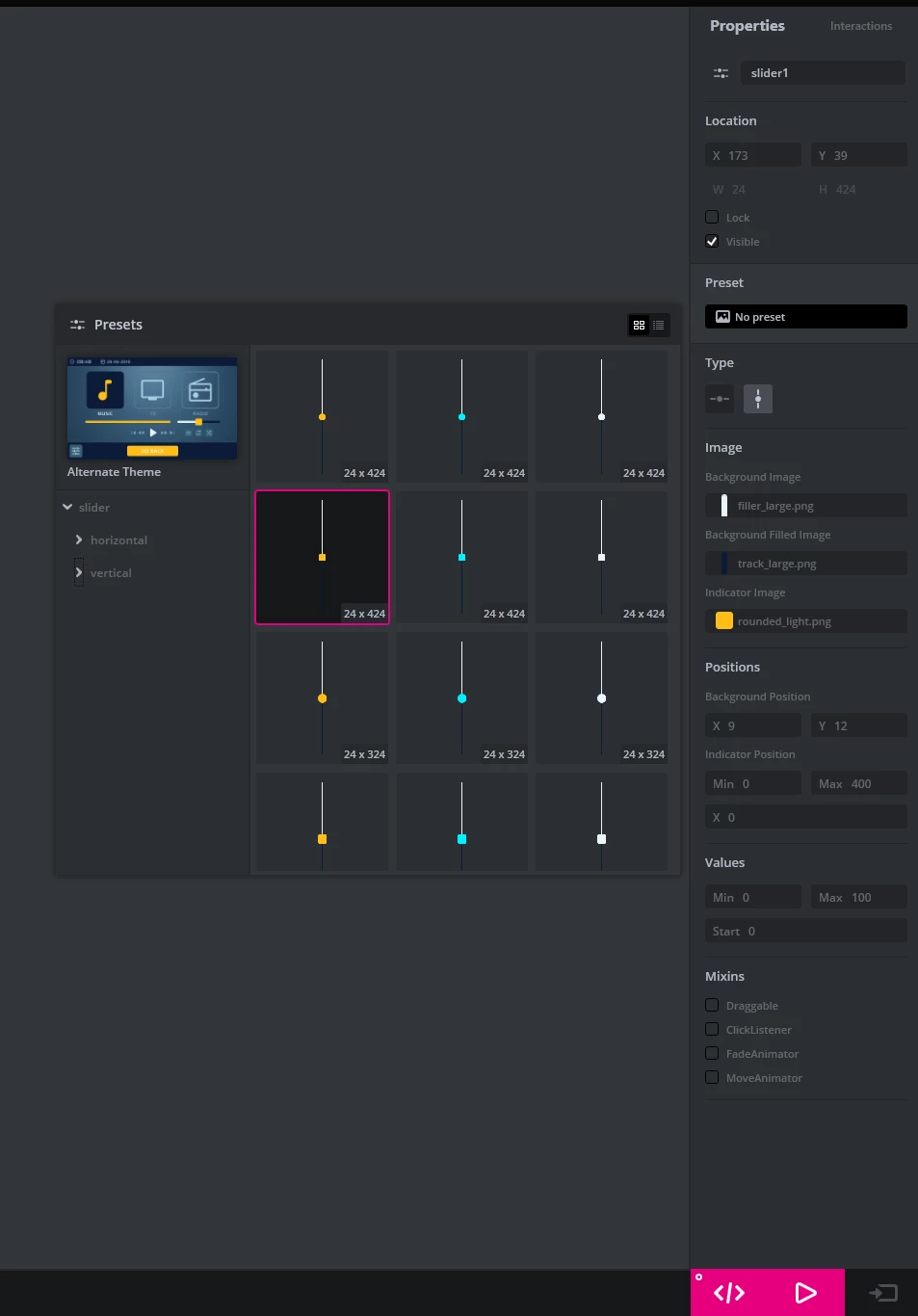

For the moment the image you are using for the slider does not change automatically depending of the orientation you choose for your slider. So, if you want to display a vertical slider, you have to change it manually yourself inside the "Preset" tab, here:

"change it manually yourself inside the "Preset" tab"
The "Preset" tab is good enough. Only now I noticed this tab - after more than a month working with Designer.
