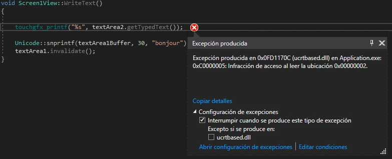

0690X000006DcnzQAC.pngHello,
I'm trying to retrieve the text string of a textarea widget with the function getTypedText() but I get an access error. No wildcards are used in the textArea2, the propery "Text"is just filled in with a short text in the designer.

Hi guys,
Allow me to clear up a few things. The TypedText class is a container for both Typography and Text, so you cannot use it directly in a printf statement. A TypedText does however have the getText() method.
Even then, Texts in touchgfx are 16-bit unicodes and cannot be used directly either.
typedef uint16_t UnicodeChar;
A TypedText contains a pointer to a UnicodeChar array.
Here's a small example i wrote that prints TypedText texts (Unicode::UnicodeChar*) through a small conversion method. You can also use this directly on the Unicode buffers for TextAreas with Wildcard.

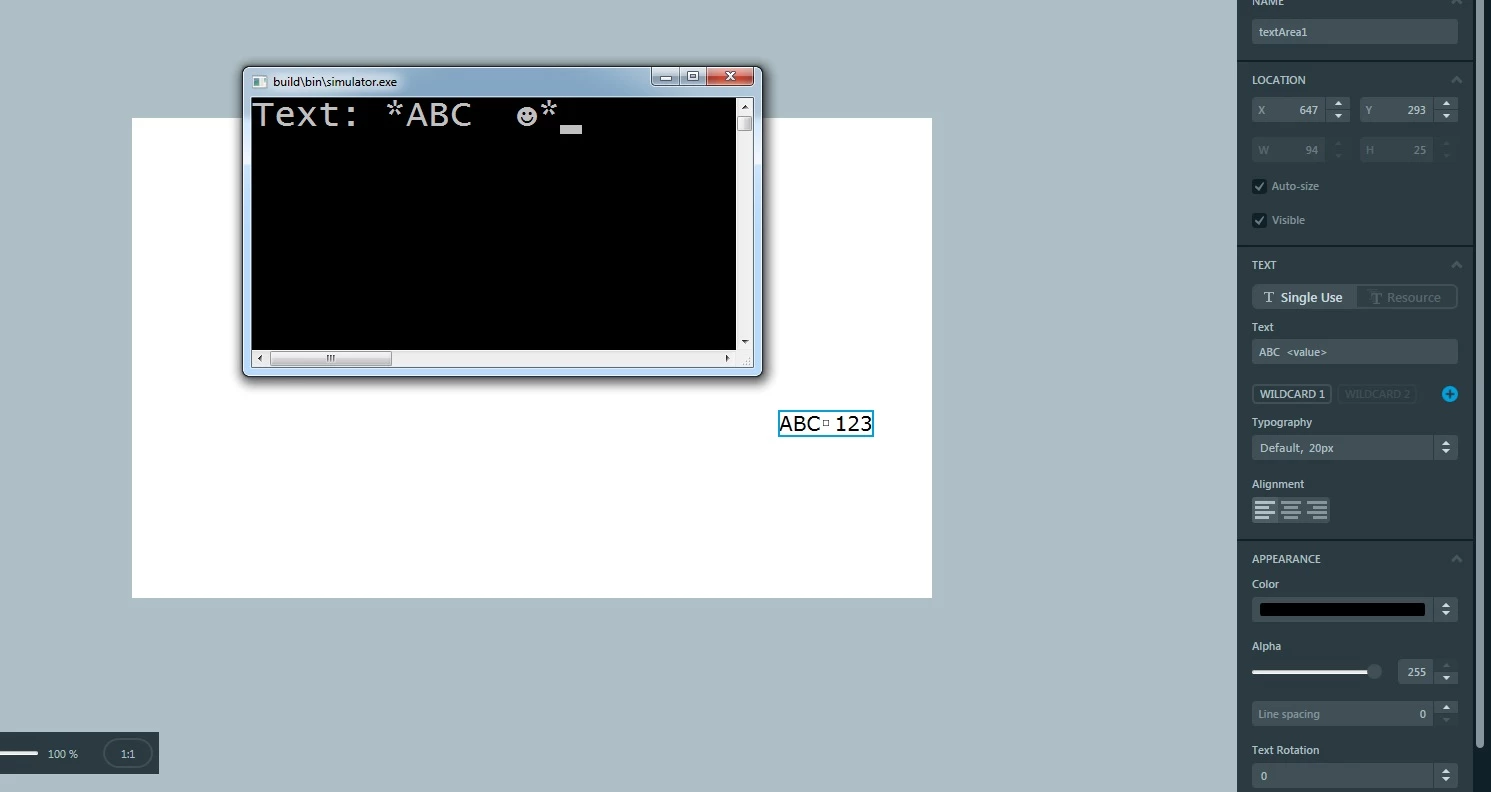

February 2, 2020
Hi Mr Martin KJELDSEN
above code work fine. but when add wildcard text, output show unknown character.
Please guide me to use this function "const Unicode::UnicodeChar* getWildcard()const"
touchgfx_printf("Text: *%s*", output );
