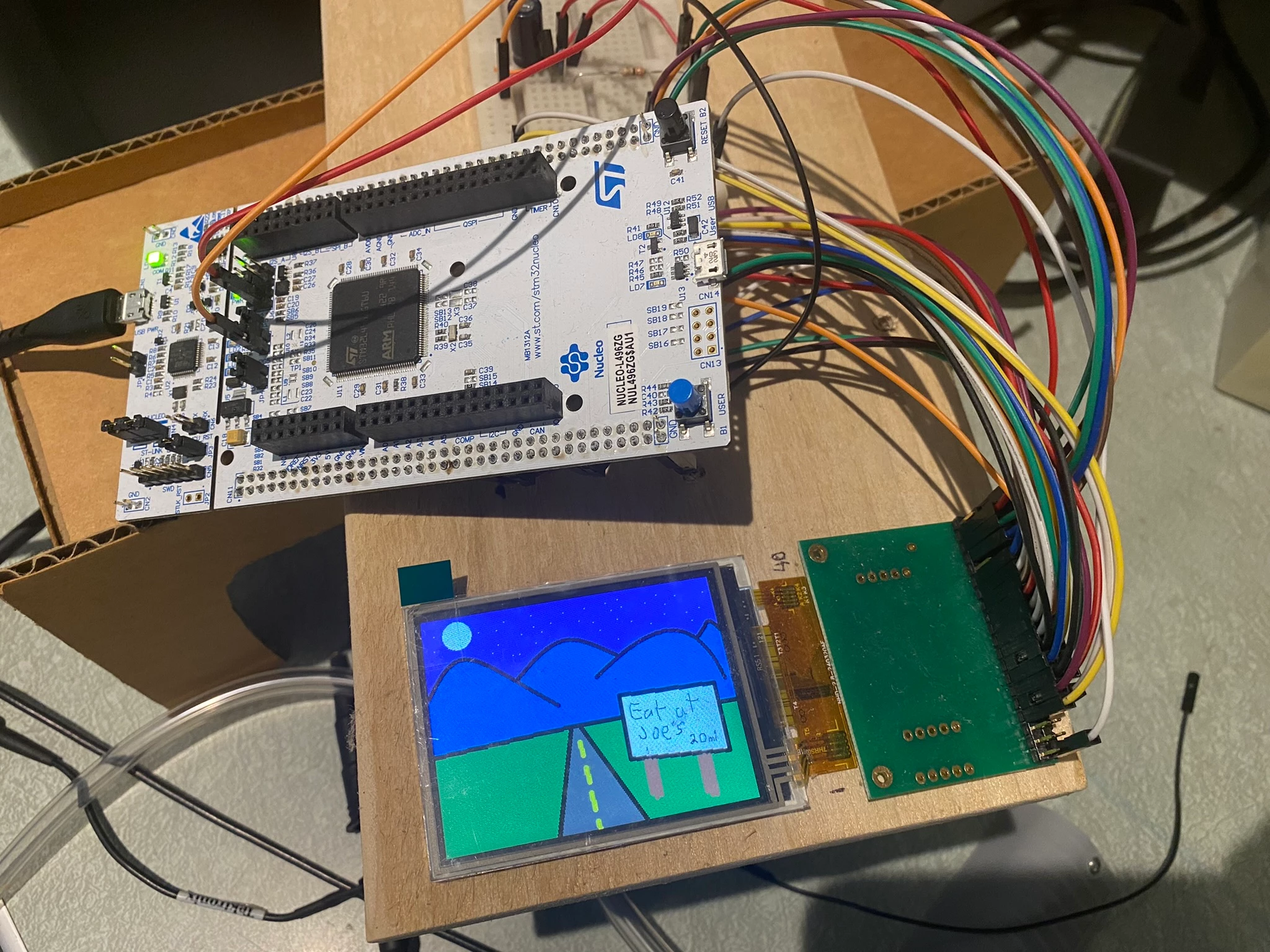

Hi All,
I'm trying to get started with TouchGFX.
I'm currently working with a NUCLEO-L496ZG eval board connected to an NHD-2.8-240320AF-CSXP-FT (320 x 240 TFT LCD with ST7789 internal controller.)
I've successfully connected up the display via FMC and been able to display colors and images and such to the screen, just using statements like
*(__IO uint16_t *)(0x60000000) = command;
*(__IO uint16_t *)(0x60020000) = data;
to send data to the command and data registers, and everything seems to be working well.

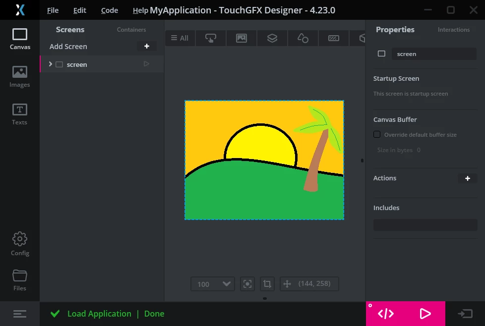

Now I'm trying to bring in TouchGFX into the mix and I'm having a difficult time. I've read through the board bring up process, and where I think I'm having trouble is knowing which functions to modify from the generated code to integrate the ST7789 driver code I've written.
To give you an idea of what I've tried and what my setup is, here's what my TouchGFX setup looks like in the IOC:

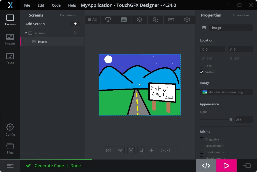

After generating the code, I used TouchGFX designer and opened the ApplicationTemplate.touchgfx.part file and then added a simple splash bitmap to the default screen:
(I know, I could quit being an electrical engineer and draw pictures in paint for a living, right?)
I then generated code, went back to STM32CubeIDE re built with no errors.
On first debug session, nothing happened on the LCD, which makes sense since I hadn't modified any of the generated code. Based on the example here FMC and SPI Display Interface | TouchGFX Documentation I realized I was probably supposed to modify flushFrameBuffer in the TouchGFXHAL.cpp file, so I did so like this:

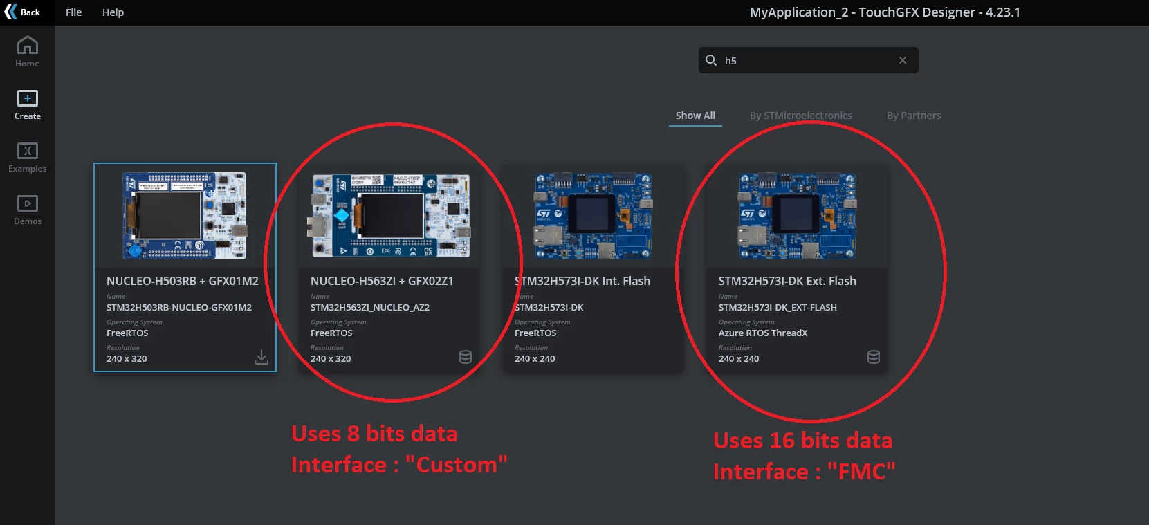

You can create projects using the H5 boards.
Some uses FMC 8 bits with custom interface, others uses FMC 16 bits with FMC interface :
You could get inspired by those and look if they have something different than yours.

I'm using STM32CubeIDE Version 1.14.1, and I'm using TouchGFX Designer 4.23.0. I created my project, ioc, etc using the CubeIDE, and then opened the .part file in Designer to add that bitmap. I see what you mean about the launch button not being clickable. I'll take a look at the sample projects that you sent and try starting a new project from Designer.
To give you a little more detail on how I'm able to communicate with the display using the FMC without using TouchGFX, I've got the FMC setup like so:
Specifically, i'm using 16 bit mode.
My hardware connections are as follows:
To communicate with the display via FMC, I've defined two helper macros:
#define TFT_writeCommand(command) (*(__IO uint16_t *)(0x60000000) = command)
#define TFT_writeData(data) (*(__IO uint16_t *)(0x60020000) = data)
I initialize my display in the setup portion of void main() like so:
HAL_GPIO_WritePin(DISP_RES_GPIO_Port, DISP_RES_Pin, GPIO_PIN_RESET); // Activate Reset (Reset = Low)
HAL_Delay(100);
HAL_GPIO_WritePin(DISP_RES_GPIO_Port, DISP_RES_Pin, GPIO_PIN_SET); // Reset line to HIGH
HAL_Delay(100);
TFT_writeCommand(SLPOUT);//exit SLEEP mode
HAL_Delay(100);
//MADCTL: memory data access control
TFT_writeCommand(MADCTL);
TFT_writeData(MX+MV);
... etc
(i'm happy to provide the full code if that helps, but its just fairly standard ST7789 driver stuff)
And then I can color the screen blue (for instance) by doing something like this:
//X address set
TFT_writeCommand(CASET);
TFT_writeData(0);
TFT_writeData(0);
TFT_writeData(0x01);
TFT_writeData(0x3F);
//Y address set
TFT_writeCommand(RASET);
TFT_writeData(0);
TFT_writeData(0);
TFT_writeData(0);
TFT_writeData(0xEF);
TFT_writeCommand(RAMWR); // Memory Write
const uint16_t colorWord = 0x001F; // RGB565 Blue
for (unsigned long b = 0; b < 320*240; b++) {
 TFT_writeData(colorWord);
I've attached my IOC file.

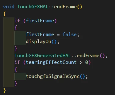

The flashFrameBuffer is used when a certain area of the screen has to be redrawn (basicaly when you invalidate something, change to a different screen, run an animation, etc).
What you should care about is that TouchGFX send a endFrame callback when it is done updating the whole screen. After that you are ready to update a new frame so you should send a vsync signal (do not use a timer for that):
The TouchGFX process is constantly waiting for a vsync signal.

@GaetanGodart I hope you have been well! I'm finally getting back to this, and have managed a little success in that I am now able to finally get a screen I have designed in touchGFX to compile and display on my prototype setup. The bad news is I cheated and did what you told me not to do - I setup a timer and I've been calling OSWrappers::signalVSync() 10x a second.
I tried to implement the code your recommended in your previous post with TouchGFXHAL::endFrame(), but I wasn't certain what tearingEffectCount was, and further, It doesn't seem like TouchGFXHAL::endFrame() gets called unless OSWrappers::signalVSync gets called first.
So my question, or maybe request, is could you clarify how I should be triggering vSync? Many Thanks!

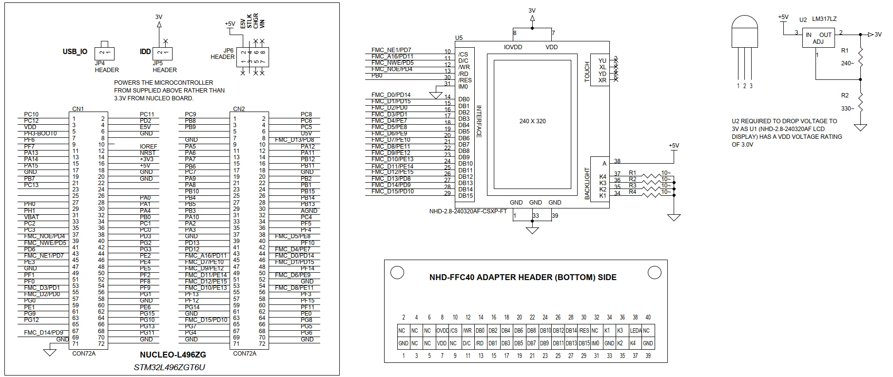

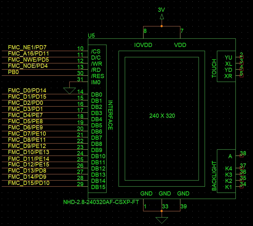

Hardware Summary:
Processor: STM32L496ZGT6U (On a NUCLEO-L496ZG Dev Board)
Display: NHD-2.8-240320AF-CSXP-FT (ST7789VI Driver)
Schematic:

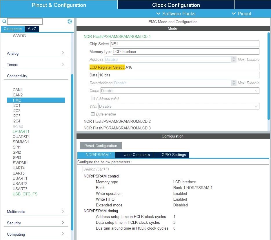

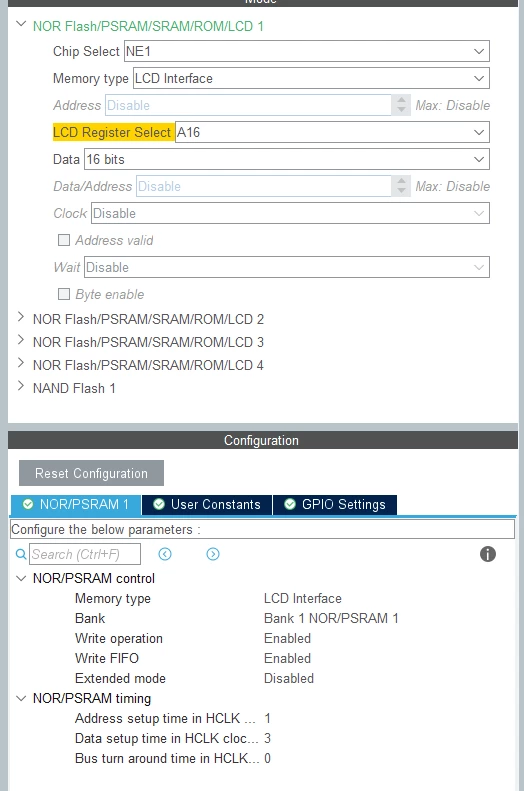

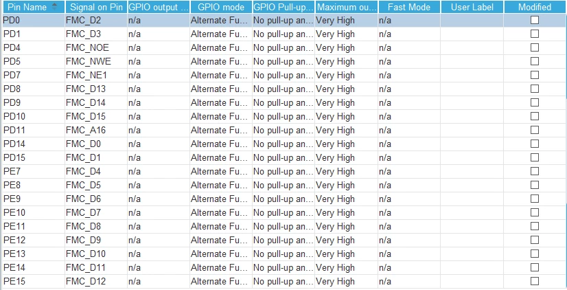

The GPIO pins were configured as follows:
    • PB0 was set to GPIO_Output, User Label “DISP_RST” (Display Reset line)
The FMC was enabled and configured:
Then the corresponding GPIO Pins configured for use with the FMC:

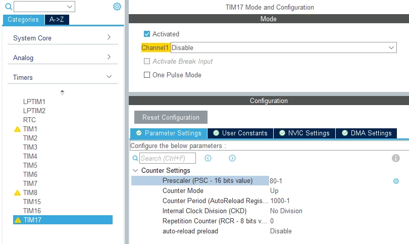

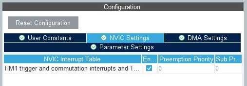

I also activated TIM17 to provide 1 millisecond interrupts for general periodic tasks.
The interrupt was also enabled within the “NVIC Settings” tab.
The timer was started in the User Code 2 Section of main.c:

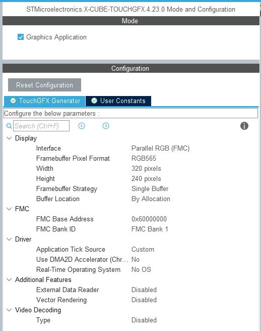

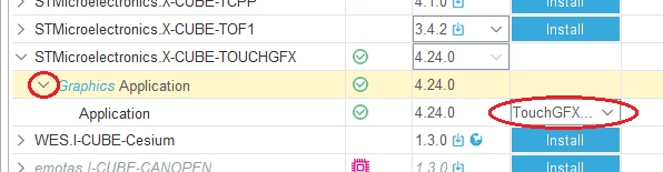

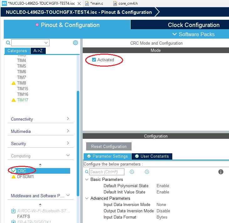

With all that verified and the display operating, I opened the ioc file and clicked on “Middleware and Software Packs” à “TouchGFX”
In the Software Packs Component Selector, I had to click the arrow next to the “Graphics Application” to expand it, then select “ToughGFX Generator.

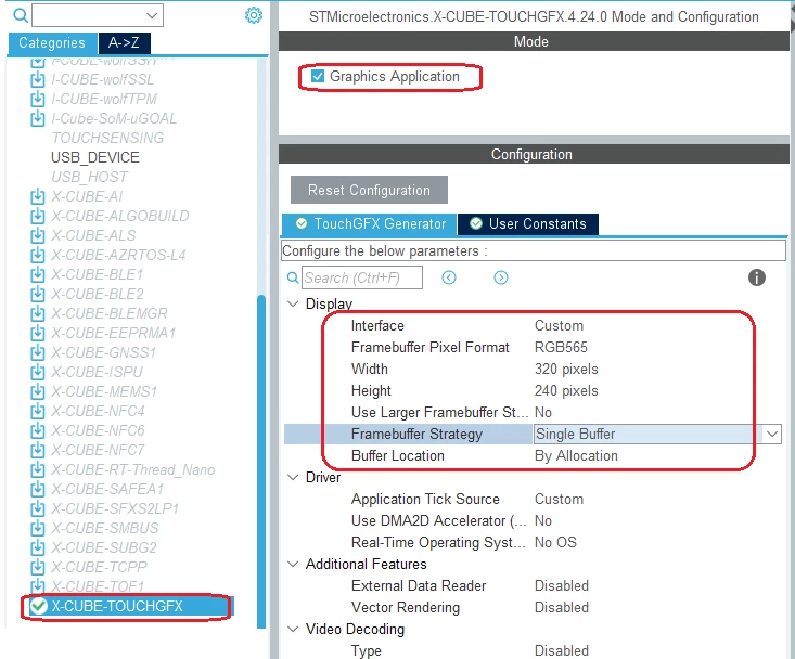

In order to enable TouchGFX, I then had to enable the CRC module:
Back at the X-CUBE-TOUCHGFX item, I clicked the “Graphics Application” and configured TouchGFX:
After generating code, I got a bunch of errors related to TouchGFX files that were not found, so I then opened TouchGFX Designer, navigated to the projects associated “ApplicationTemplate.touchgfx.part” file, opened it, generated code using the BWKidd_10-1722629133480.png button. I had to repeat this process again (rebuilt the code in STM32CubeIDE and regenerated the code in TouchGFX Designer), and then build the code one more time. I’m not sure why but it worked.
Next, I needed to integrate my ST7789 driver code into the TouchGFX generated code. This is where I had been stuck for several months. First I moved my ST7789_DRIVER.h/c files into the <Project Folder>/TouchGFX/target/ folder. Then I modified TouchGFXHAL.cpp file (in <Project Folder>/TouchGFX/target/) as follows:
At the beginning of the file, I added #include for the ST7789 driver files, then added my initialization functions to the TouchGFXHAL::initialize function:

void TOUCHGFXHAL_1msTimerTick(void) {	// used for simulating vSync from display
	static int countUp = 0;
	countUp++;
	if (countUp >= 100) {
		OSWrappers::signalVSync();	// Trigger vSync
		countUp = 0;				// reload counter
void TouchGFXHAL::initialize()
I put a prototype for this function in ST7789_DRIVER.h:
ST7789_DRIVER.h
void TOUCHGFXHAL_1msTimerTick(void);
I then added a call to this function in my timer callback in main.c:
main.c
void HAL_TIM_PeriodElapsedCallback(TIM_HandleTypeDef * htim) {
	// Check which timer triggered interrupt
	if (htim == &htim17) {	// Timer16
		// Run code that should occur every 1 millisecond
		TOUCHGFXHAL_1msTimerTick();
Generating the code in TouchGFX Designer, and then building and running the code from STM32CubeIDE, I now get the image I added to TouchGFX Designer! Victory! Well, small victory anyways, but I’ll take it.
I've attached my main.c, ST7789_DRIVER.h/c files, modified TouchGFXHAL.cpp, and project IOC files.
