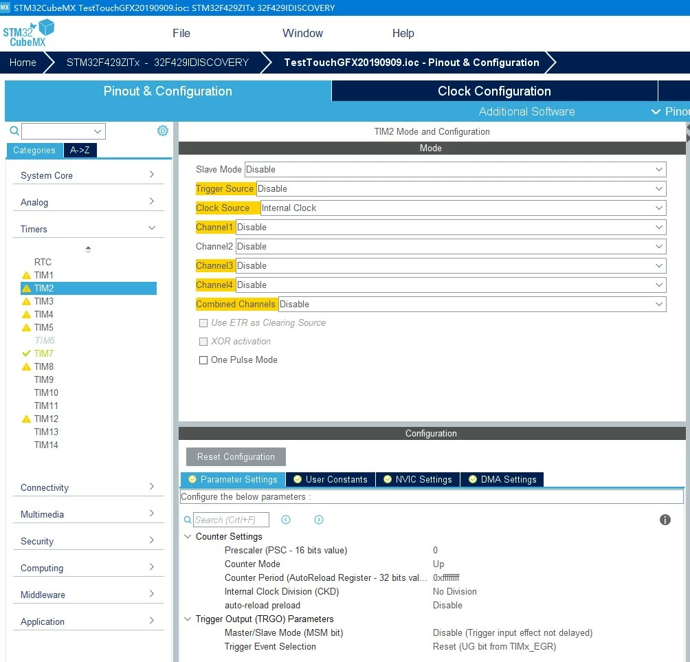

HCon
Visitor II
Sep 19, 2019 2:34 PM UTC
The Tim1 is 16-bit, The Tim2 is 32-bit.
So Timer selection Tim2.
In file STM32F4Instrumentation.cpp:
#include "stm32f4xx_hal.h"
#include "stm32f4xx_hal_tim.h"
#include <touchgfx/hal/HAL.hpp>
#include <STM32F4Instrumentation.hpp>
/* USER CODE BEGIN user includes */
/* USER CODE END user includes */
namespace touchgfx
static TIM_HandleTypeDef htim2;
void STM32F4Instrumentation::init()
  RCC_ClkInitTypeDef clkconfig;
  uint32_t uwTimclock, uwAPB1Prescaler = 0U;
  uint32_t pFLatency;
  __TIM2_CLK_ENABLE();
 TIM_ClockConfigTypeDef sClockSourceConfig = {0};
 TIM_MasterConfigTypeDef sMasterConfig = {0};
 htim2.Instance = TIM2;
 htim2.Init.Prescaler = 0;
 htim2.Init.CounterMode = TIM_COUNTERMODE_UP;
 htim2.Init.Period = 0xffffffff;
 htim2.Init.ClockDivision = TIM_CLOCKDIVISION_DIV1;
 htim2.Init.AutoReloadPreload = TIM_AUTORELOAD_PRELOAD_DISABLE;
 if (HAL_TIM_Base_Init(&htim2) != HAL_OK)
  Error_Handler( );
 sClockSourceConfig.ClockSource = TIM_CLOCKSOURCE_INTERNAL;
 if (HAL_TIM_ConfigClockSource(&htim2, &sClockSourceConfig) != HAL_OK)
  Error_Handler( );
 sMasterConfig.MasterOutputTrigger = TIM_TRGO_RESET;
 sMasterConfig.MasterSlaveMode = TIM_MASTERSLAVEMODE_DISABLE;
 if (HAL_TIMEx_MasterConfigSynchronization(&htim2, &sMasterConfig) != HAL_OK)
  Error_Handler( );
  /* Get clock configuration */
  HAL_RCC_GetClockConfig(&clkconfig, &pFLatency);
  /* TIM2 is on APB1 bus */
  uwAPB1Prescaler = clkconfig.APB1CLKDivider;
  if (uwAPB1Prescaler == RCC_HCLK_DIV1)
    uwTimclock = HAL_RCC_GetPCLK1Freq();
  else
    uwTimclock = 2 * HAL_RCC_GetPCLK1Freq();
  m_sysclkRatio = HAL_RCC_GetHCLKFreq() / uwTimclock;
  HAL_TIM_Base_Start(&htim2);
//Board specific clockfrequency
unsigned int STM32F4Instrumentation::getElapsedUS(unsigned int start, unsigned int now, unsigned int clockfrequency)
  return ((now - start) + (clockfrequency / 2)) / clockfrequency;
unsigned int STM32F4Instrumentation::getCPUCycles()
  return __HAL_TIM_GET_COUNTER(&htim2) * m_sysclkRatio;
void STM32F4Instrumentation::setMCUActive(bool active)
  if (active) //idle task sched out
    cc_consumed += getCPUCycles() - cc_in;
  else //idle task sched in
    cc_in = getCPUCycles();

Sep 19, 2019 2:42 PM UTC
STM32CubeMX :
HCon
