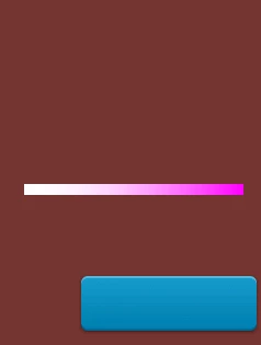

I'm trying a palette that goes from white to red and red to green. Following this article https://support.touchgfx.com/docs/development/ui-development/scenarios/creating-dynamic-l8-images, I could make the columns colored. But I couldn't make it 3 colored.
BitmapId dynamicBitmap1 = Bitmap::dynamicBitmapCreate(200, 10, Bitmap::L8, Bitmap::CLUT_FORMAT_L8_RGB888);
	imageDynamic.setBitmap(Bitmap(dynamicBitmap1));
	if (dynamicBitmap1 == BITMAP_INVALID)
		touchgfx_printf("Unable to create dynamic bitmap\n");
	else
		uint8_t* data = Bitmap::dynamicBitmapGetAddress(dynamicBitmap1);
		uint8_t* pixel = data;
		//make colored columns
		for (int y = 0; y < 10; y++)
			for (int x = 0; x < 200; x++)
				*pixel++ = x;
		uint32_t byteSize = 200 * 10;
		byteSize = ((byteSize + 3) & ~3);
		//Palette starts four bytes after the pixels
		uint8_t* pal = (data + byteSize + 3);
		//Make palette with 256 colors from white to red, red to green
		for (int i = 0; i < 256; i++)
			//BGR
			pal[i * 3 + 0] = uint8_t(255);
			pal[i * 3 + 1] = uint8_t(255);
			pal[i * 3 + 2] = uint8_t(255 * (cosf(i*2.0f / 255)));
This is what I got

Never tried it to be honest and I do not know what you are aiming for, but could you potentially divide the palette into 2 palettes ? One from white to red and the other from red to green, and since you put them side by side the user cannot see/know that you use two palettes instead of one.

Maybe you miss in color coding white to red is started with BGR FFFFFF and end with 0000FF . Your code differ.
Next Your x is only to 200 then not full RED end.
Too your framebuffer need be RGB888 for best result.

So you say, my x should be to 256 to see the red end? But my image should be this size. How could I see the red end in this size?
MM..1
April 20, 2021
*pixel++ = x; // x is used as indexed color then need correction to width when 200
*pixel++ = 255*x/200;
