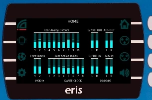

  4. How would I go about making a meter like this , taken from the GFX site, could I do this with the box progress ? I could imagine so but how to do the peak portion of the meter,and set the ballistics ? Maybe I really need programming to be able to do what I want?

4) Yes you could do that with the box progress. But, yea, you won't get far without being able to write some code.
