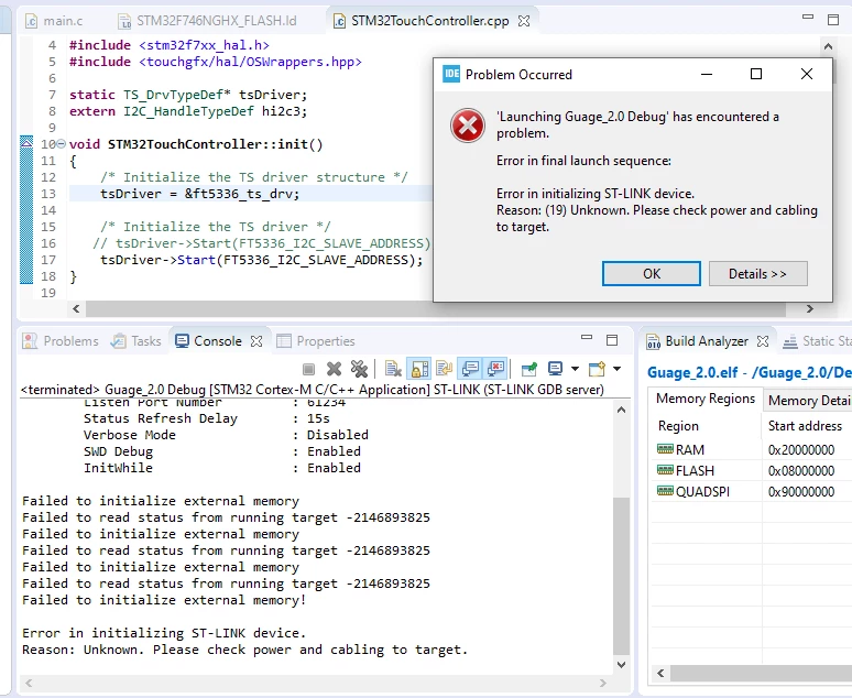

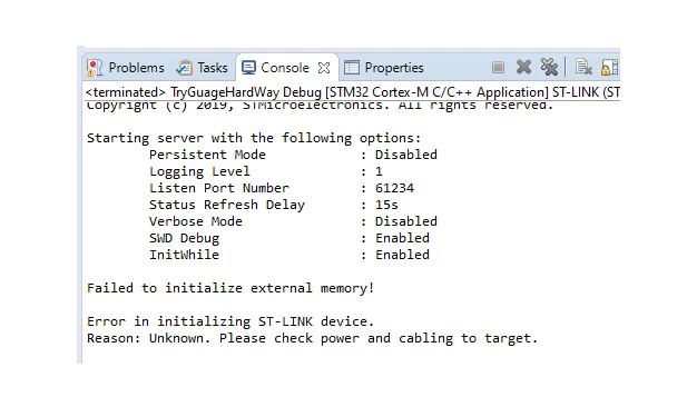

Finally got it working in designer (thanks for your help), but when i try and add RTOS communication from main.c file it wont download to board correctly, so i tried to do it the 'hard way', and everything complies ok, QUADSPI is set up fine but when i add the external loader (N25Q128A) in the debug configuration, when i ttry and debug it fails to initialise external memory, i have checked the linker file to ensure correct address and this seems fine,
any ideas on this error.. i reinstalled st link hoping this might help but no joy
regards
Barry

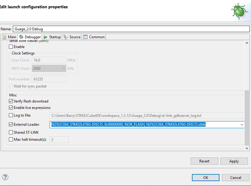

I think you have to configure the flashloader from your debug configuration. You can "scan" and select the right one for your ST display kit.
/Martin

February 19, 2020
hey Martin,
i have configured the flashloader for my board 746g disco, pics below. i can flash the board if i disable the external loader but everything is saved to external memory so ! i started a new project just to do one step at a time and the same issue this morning?
