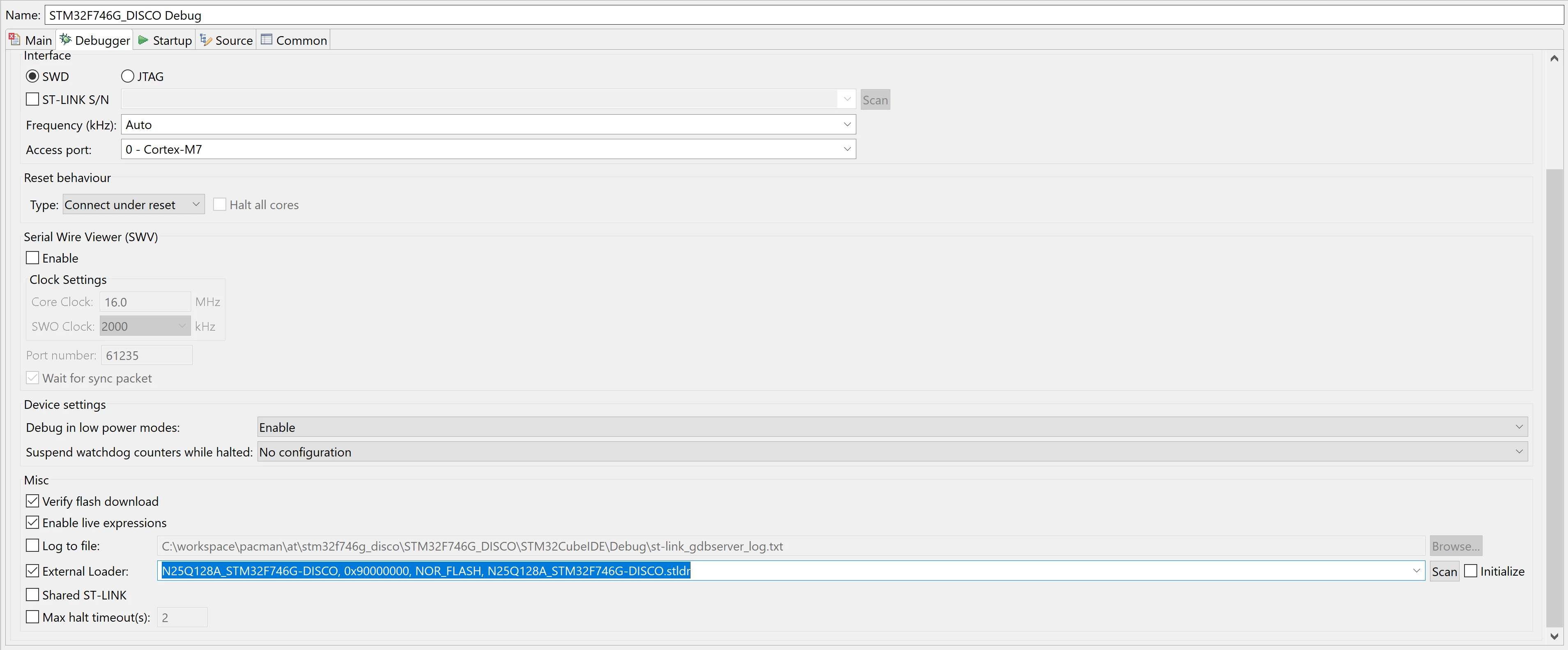

It looks like you can build the project correctly but you cannot download the binary file and debug (correct me if I'm wrong). It seems to me that it's a problem related to your ST-Link or your launch configuration.
Can you check your launch configuration (right-click on project > Properties > Run/Debug settings > Edit) ?
/Alexandre
Rohit.1
Rohit.1Author
April 20, 2020
This is my debug setting.
This setting works with my other projects.
Alexandre RENOUX
Visitor II
April 20, 2020
The Debug probe should be ST-LINK (ST-LINK GDB server) and then enable external loader and select the correct one as shown below.
You can also uncheck "Verify Flash Download" to accelerate the download process.
/Alexandre

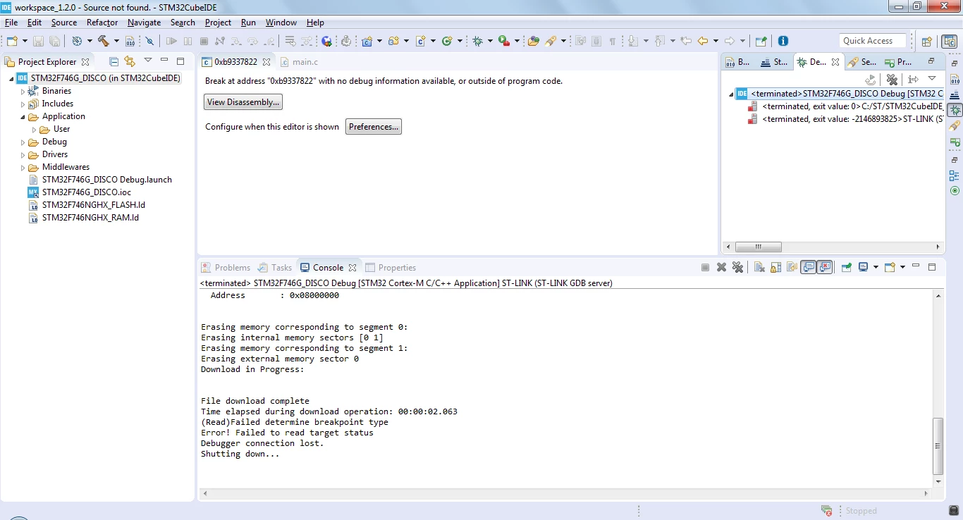

Now followed the exact steps mentioned by you.
Following is the problem:
Rohit.1
Rohit.1Author
April 20, 2020
I think I have figured out the solution for above mentioned problem.
Added startup_stm32f746nghx.s file from gcc folder to Application/User folder in the STM32CubeIDE.
But now we are again at the initial stage. Screen on which Gauge widget is added is not responding and the whole application freezes after loading this screen.

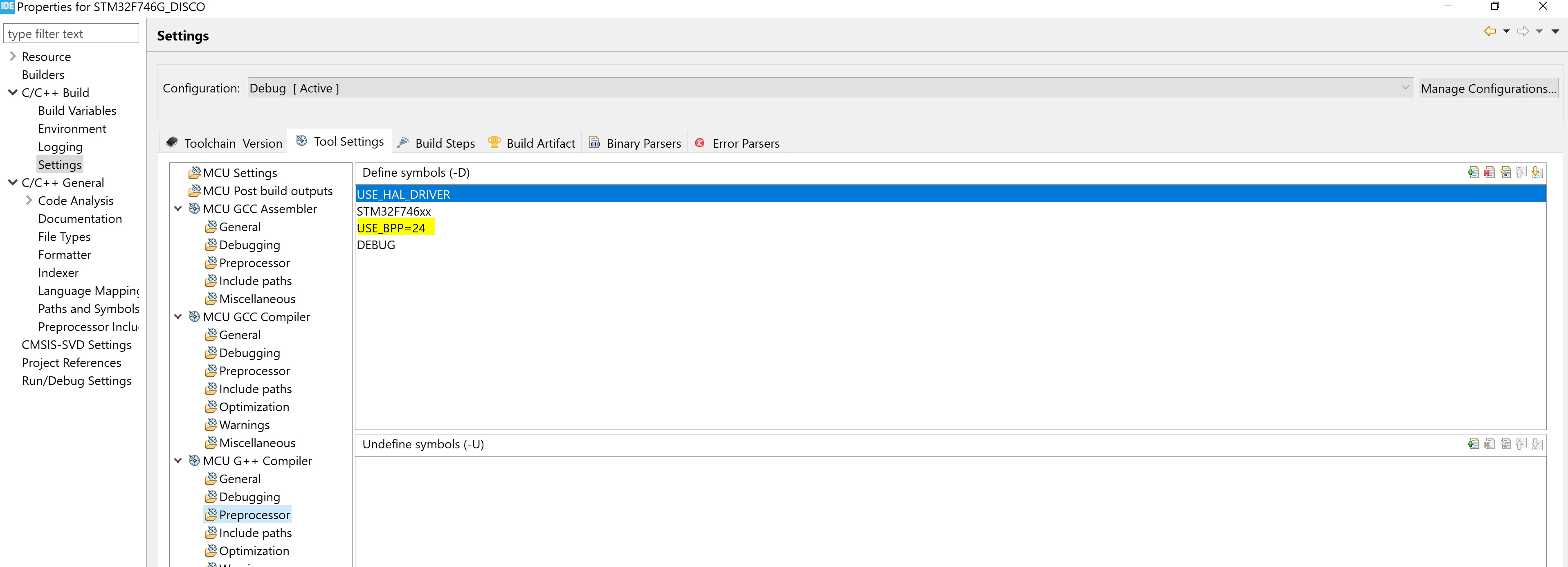

Can you also check if you have the following USE_BPP=24 in your project ? If not please add it
/Alexandre
Rohit.1
Rohit.1Author
April 28, 2020
After adding the USE_BPP=24, TouchGFX Demo 1 worked through STMCubeIDE.

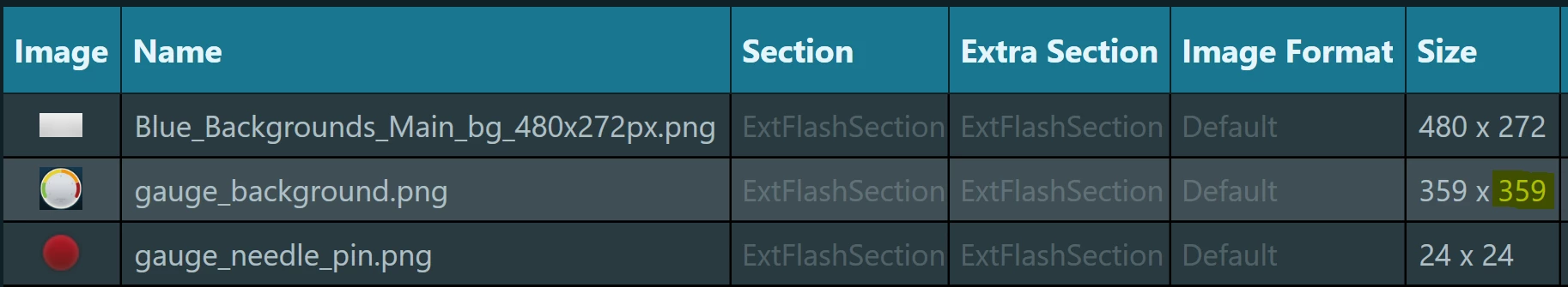

There were a few problems in your project.
First, the assets of the gauge were not the right size. You have a screen 480*272 and you want to fit a picture 359*359. Not possible.
