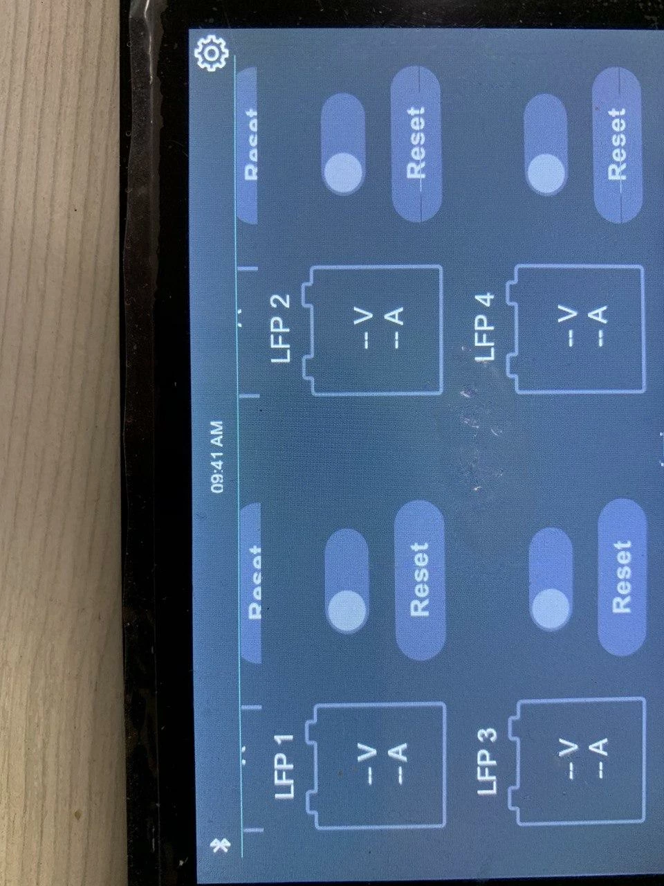

Good afternoon to everyone!
I have some problem with flushing or rendering.
My settings:
  • partitial framebuffer, 4 bloks, 16bpp, 32000 block size;
  • internal RAM for framebuffer;
  • use DMA2D and DMA2 for FMC (STM32F469);

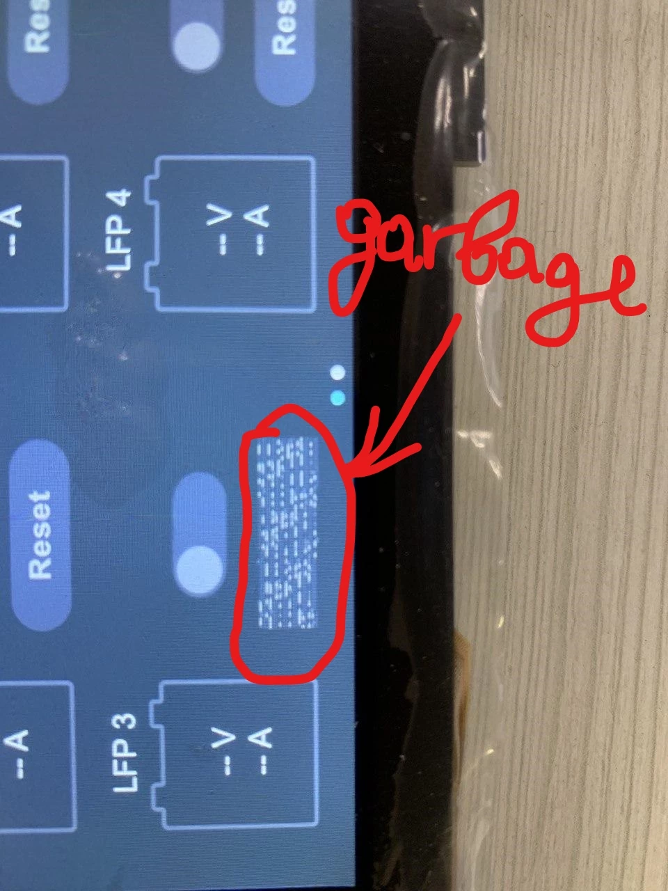

Problem - after start UI if we press "Reset" UI button, release image button is corrupted. I am check bitmap and bitmap in framebuffer - they very difference. Result in pic.
After two click this corruption disappears. But similar problem in swap container(upper text label "LFP1") never disappears.
0693W0000059JZ8QAM.jpg0693W0000059JZ3QAM.jpgThank you in advance!

I am add code in function transmitFrameBufferBlock delay before start DMA for FMC:
void transmitFrameBufferBlock(uint8_t* pixels, uint16_t x, uint16_t y, uint16_t w, uint16_t h)
 _isTransmittingData = 1;
	uint32_t _data_length = w * h;
 for(uint32_t i = 0; i < 21300; i++)
 asm("nop");
 SSD1963_Set_Work_Area(x, y, w, h);
 HAL_DMA_Start_IT(&hdma_memtomem_dma2_stream0, (uint32_t)pixels, FMC_DATA_ADR, _data_length);
Garbage is disappear but flushing very slow. This method is wrong.

I find out that framebuffer allocator working with issues. If we use 4 bloks, counter sendingBlock or drawingBlock lags and we draw another blocks. TouchGFX engine marks another block. markBlockReadyForTransfer() we call in flush method. How fix it?
