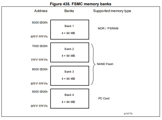

FSMC on STM32F407xxxx According to the datasheet and the picture .. Is That mean that I can interface an external SRAM of 256 MB and a NAND Flash of 512 MB as a maximum size ?

No, it means you can have at least two NAND devices, which access blocks like a hard drive and can be VERY large, ie hundreds of GB if you find the right parts and write the drivers.​

One could also sub-divide the decoding within the bank to allow for more devices.
Current trends however are towards using eMMC devices via the SDIO/SDMMC interfaces, which both reduces the pin count, and standardizes the land pattern for the memory devices. It also simplifies/offloads the complexity of block management, correction, etc to the eMMC controller on the memory chip.

Ok Thanks. I need to add a 16 Gbyte NAND memory for my PCB that contains STM32F407VGT6
to use it to store data in an industrial application.
