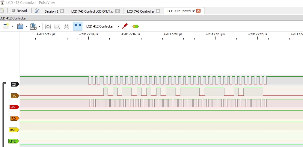

I have a LCD display working on a nucleo F412 using FSMC. I'm trying to move to a nucleo F746. I have moved the code and includes from the 412 to the 746 project and connected the display to the correct pins for the 746. The 746 pin out is a little different than the 412 for the default connections. I have the same clock speeds and settings. I compared the FMC init function line by line between the two and all the setting match, but I can't get the display to work using the 746. Using a logic analyzer and comparing the two boards running the same code I can see there are differences on the FMC A18,FMC_NE1,FMC_NWE and FMC_NOE pins. The logic analyzer is sampling at 24MHZ. I've moved the display jumpers for the display back to the F412 and it works, back to F746 making sure to adjust for the differences in the pins a few times now. Any idea's where or why the display works on the F412 but the same settings, clock speeds and code won't work on the F746?

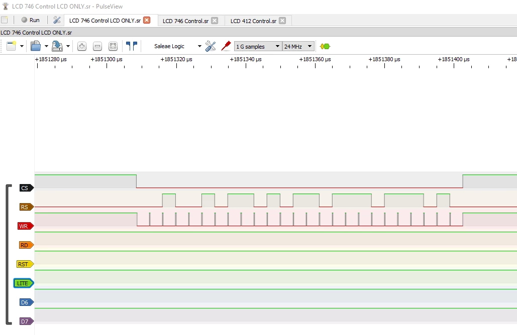

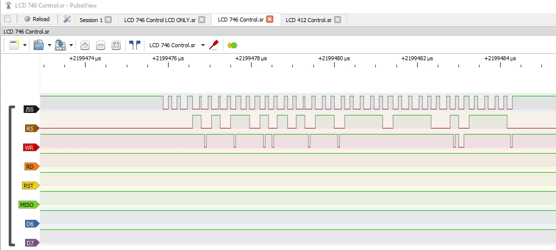

I started a new project and only enabled the FMC for the F746 to make sure I didn't have some other interrupt or code getting in the way. I maxed out clock setup times to slow things down also. I'm not sure why NE1 signal would change from a toggle during communication at faster speeds to staying low during communication at a slower speed. The LCD still doesn't work when connect to the F746. I ordered a new probe with 16 channels so I can capture all the signals and timing and decode the data. Some screen shots below for the same command. Let me know if you have anything I should look at.
Thanks
