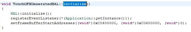

I placed my double framebuffer to other address:
Set framebuffer in LTDC start:
And add line to FrontendHeap.hpp:

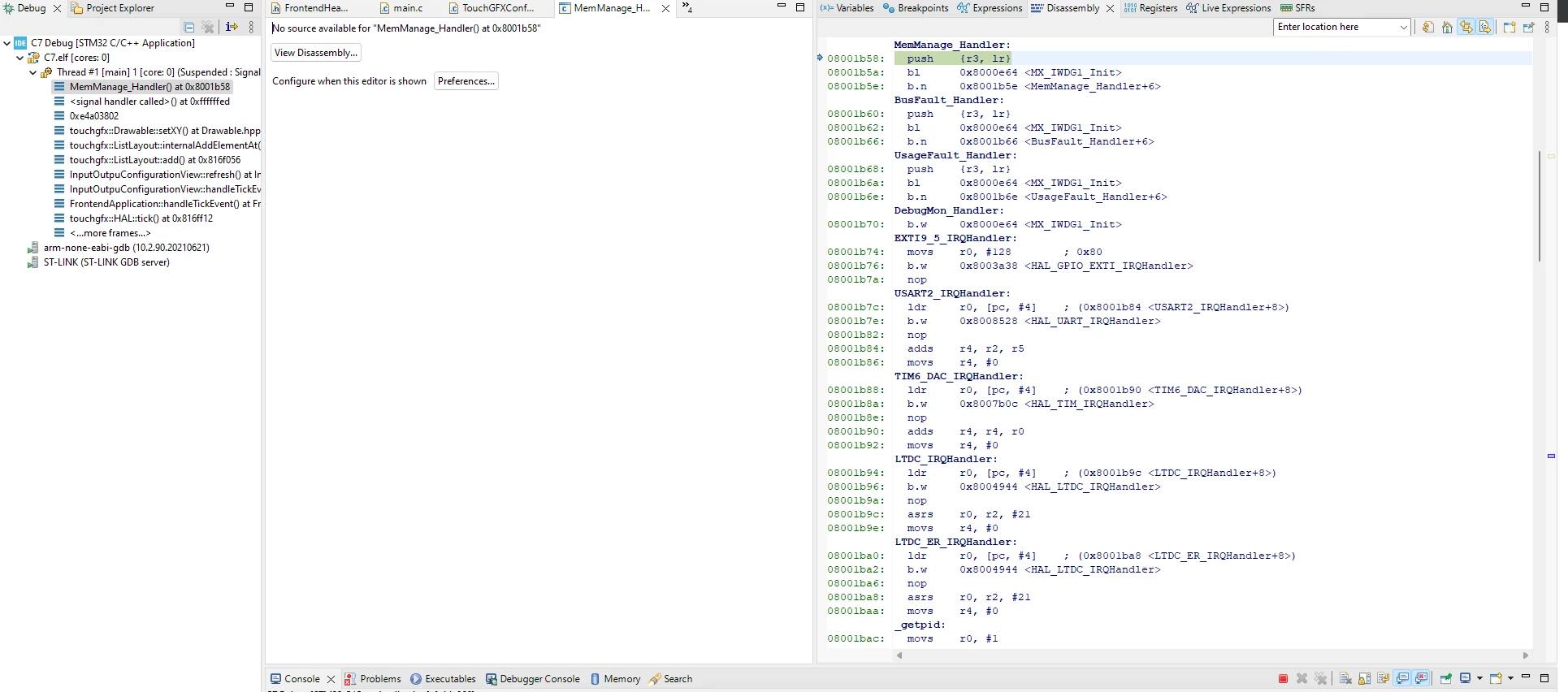

And I always get hardfault at : (__attribute__ ((section (".sdram_section")))) .Maybe someone see the mistake and can help? Thank you.

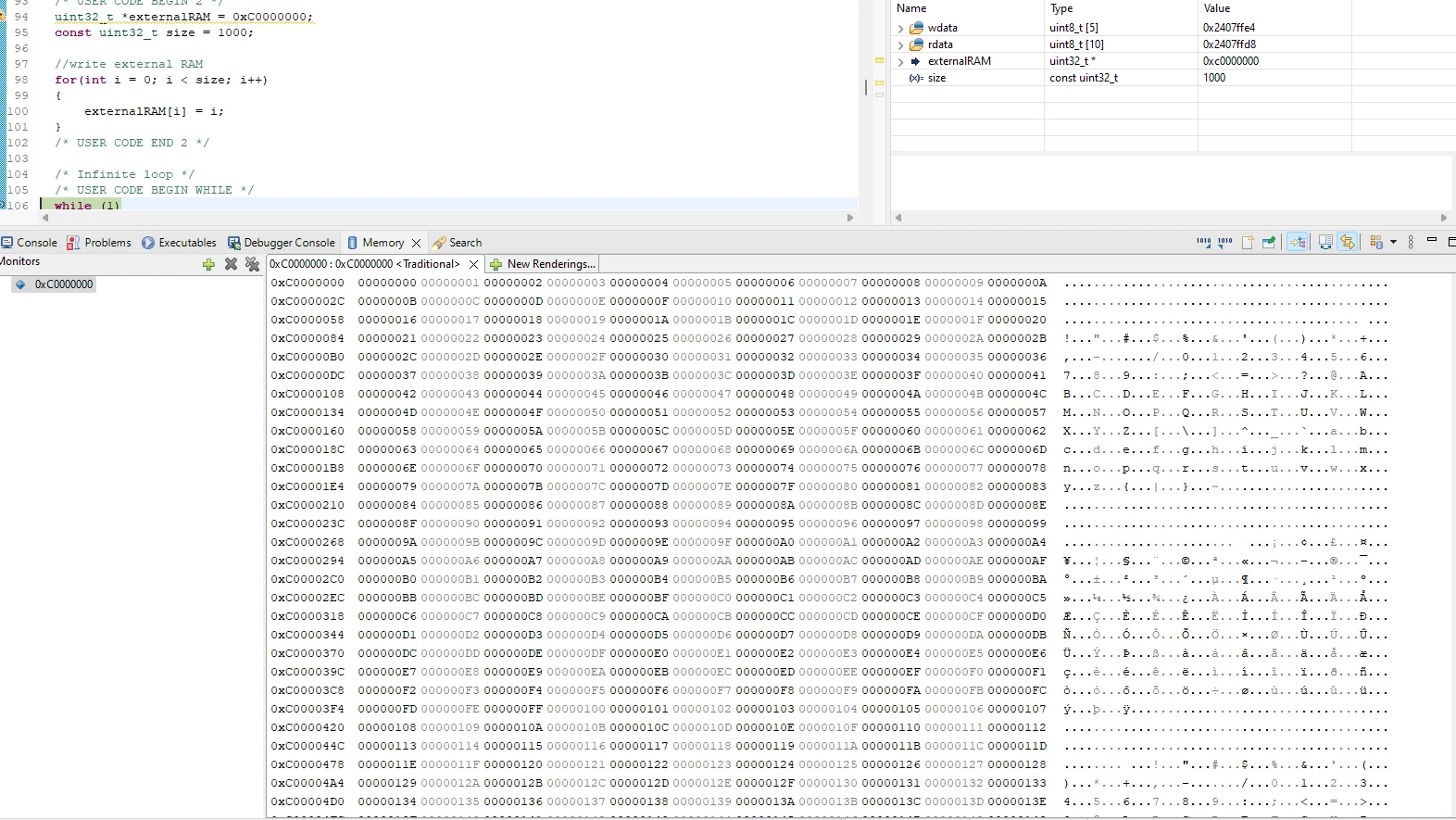

Only if you have enough internal RAM memory, and it will not affect your application, no is not an obligation.
To know it, you need to calculate the size of your frame buffer. "framebuffer is width * height * color depth in bits / 8 bytes." This link is nice to check it https://support.touchgfx.com/docs/basic-concepts/framebuffer#memory-consumption
Another tip, if you are using an external SDRAM, make sure you are able to write and read it.
It may be that your FMC peripheral is wrongly configured, and that is why it is generating these faults.

Likely Hard Faults because you fail to initialize the memory interface before the C/C++ constructors are called.
Should enable the memory in SystemInit(), and in startup.s this should be called before __libc_init_array
Look at the code that's actually faulting to understand why.. the code the MCU is executing at and immediately prior.

The framebuffer is not initialized by C++.
Could you provide a stack trace when you get the fault? and also disassembly of the code.
In some cases it is a wrong configuration of SDRAM. The DMA2D and LTDC performs block access to the frame buffer, but the code may use byte access to the heap.
Can you test that byte access is working. Try reading and writing all 4 bytes in a word in SDRAM.
Flemming Gram CHRISTENSEN
June 30, 2023
BTW, what is the reason to move the heap to SDRAM? How big is your heap?
Maybe you can move just one big element to SDRAM. E.g. if you have a big array in Model.

It looks like my SDRAM is working correctly:
I have a lot of arrays in model.hpp. It would be great to store frontend heap to my external SDRAM cause in RAM_D1 left only 100KB
Now I get MemManage_Handler:

You should start by testing your SDRAM. Write a program that write bytes, shorts, and words to different addresses in the SDRAM. Then read the values to check that it is correct.
It is important that you can write bytes in all addresses, without modifying the nearby bytes.
