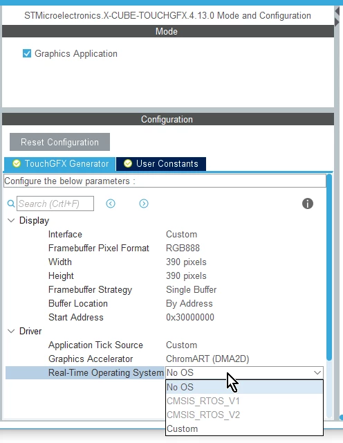

Starting from a CubeIDE project and adding TouchGFX, is it possible to integrate TouchGFX without FreeRTOS?
Note: I am using STM32F746-DISCO

Hi @JDant.1​,
Simply choose "No OS" when selecting an operating system in TouchGFX Generator, and be sure to not enable FreeRTOS in CubeMX view of course.
And read this for tips on working with TouchGFX and no RTOS: https://support.touchgfx.com/docs/basic-concepts/operating-system
/Martin

JDant.1
JDant.1Author
May 4, 2020
Thank you very much for your answers. It worked without RTOS correctly!

I have the same problem, trying to use TouchGFX with no RTOS on a STM32F429-DISCO board. I created a project called MyApplication in TouchGFX Designer 4.15.0 by selecting the board and a blank screen app, which used FreeRTOS. I couldn't find any examples that used no RTOS. I added a single button. The project simulated and ran OK in TouchGFX Designer.
When I opened the project in STM32CubeIDE, It has a strange structure, with what looks like a subproject called STM32F429I-DISCO on the folder list. The .ioc file following this is called STM32F429I-DISCO.ioc. When I try to open this file, the IDE tells me that it is not the application's active .ioc file, and that I should be using MyApplication.ioc, but there is no such file.
Then I opened the STM32F429I-DISCO.ioc file in standalone CubeMX, removed FreeRTOS support, defined a few GPIO's with an interrupt on one of them, and generated the code. When I reopened the project in CubeIDE, the changes were there. Then I followed the advice in the the TouchGFX online documentation where it says that when you don't use an RTOS, you must launch the graphics engine by calling "touchgfx::HAL::getInstance()->taskEntry();" in main.c. I tried this but the compiler failed with the error:
