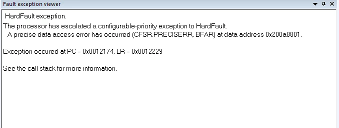

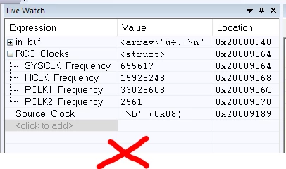

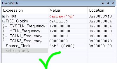

I'm using IAR Embedded Workbench IDE & STM32F207xx with TFT LCD Display, I configured the SysCLK to 120Mhz & HCLK to 120MHz & PCLK1 to 30MHz & PCLK2 to 60MHz, When I debug or execute program all frequencies change automatically to the random values and the HardFault exception execute.
how I know when the problems come

I think the scrambling of those clock values and the hardfault are both symptoms of the same thing: Your program crashing.

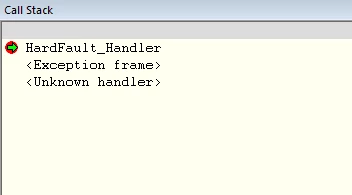

You might be able to get some information about the crash from what's reported by the fault exception viewer - for example is 0x08012174 a valid address in your program code?
I don't have much experience of analysing these but I would have expected an odd address not an even one (this is a historic artefact of the move from 32-bit ARM instructions to 16-bit THUMB ones). But maybe IAR hides this from you.
LR is the top subroutine return address - which is odd as I expect. Is that just after a call?
But most likely things have gone wrong well before the hard fault. Perhaps you ran out of stack space so then stack and other variables interfered with one another. Or there was a bug relating to pointers or writing beyond the ends of an array.
It's also possible that you're being too aggressive with clock speeds / wait-states (if you didn't stick within the limits in the Reference Manual or use a configuration tool that follows those limits such as Cube) so the processor can't reliably read program instructions.

In addition to Danish, you seem to have a starting point:
> Precise data access error at 0x200A8801
Cross check the map file (if necessary, re-build to create one), and observe the variable/data at this location in the debugger.
It is an odd address, so perhaps an unaligned access.

Please how can I get the problem where is exactly, same function or something in IAR Systems can I get the last instruction where the crash is up

The "precise error" data address of 0x200a8801 sounds like the "middle of nowhere" - by which I mean I don't expect any memory to exist there. So any read / write of that address is an error.
