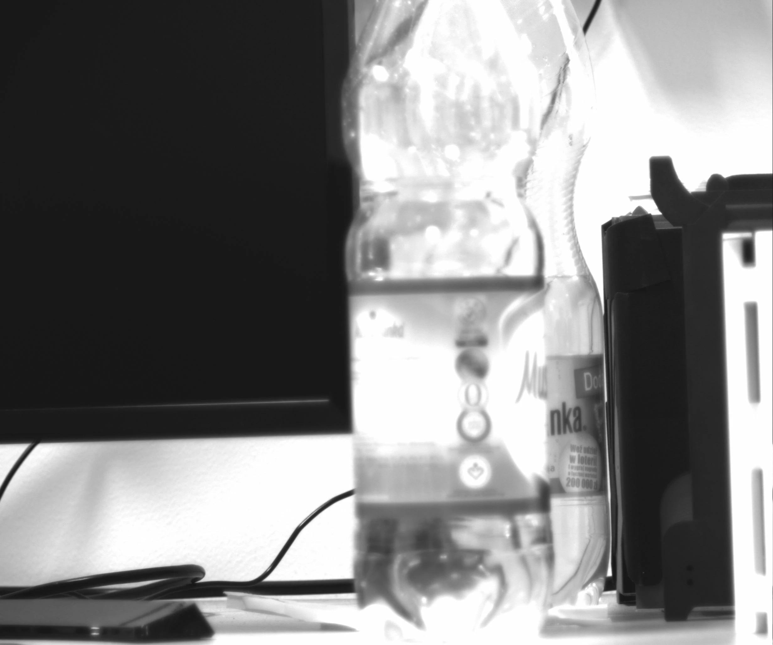

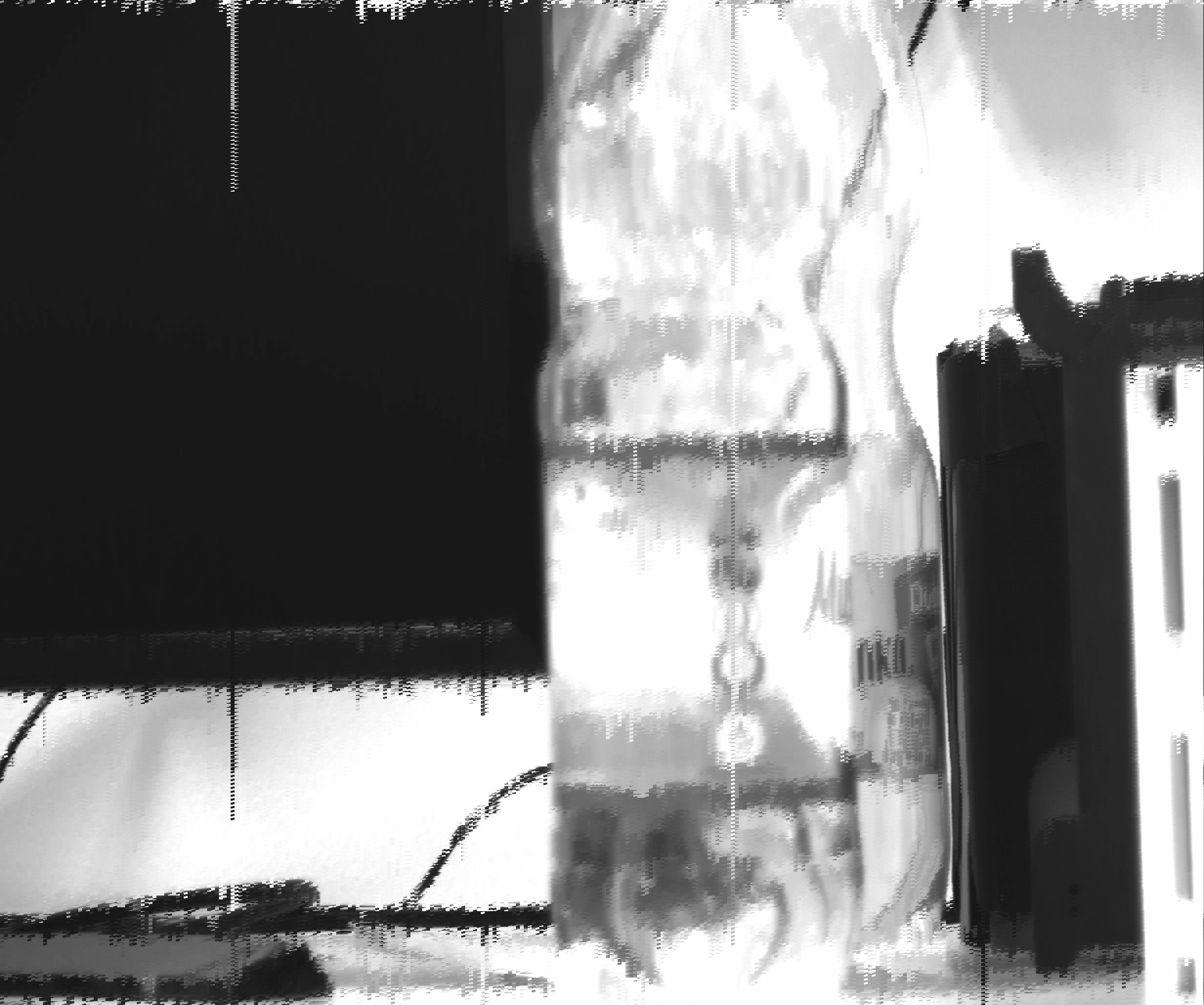

I am using STM32F7-Discovery board. I've written my project in freeRTOS. The JPEG DMA encoding is implemented the same way as in HAL examples.
Everything works fine until I will change freeRTOS heap size. In this case JPEG file size is much bigger than the 'correct one' and it is demaged.
There is a preview in attachments:
OK ONE  - filesize [216KB]
BAD ONE - filesize [318KB]
Is a heap-size has an influence on DMA process? Did I forget about something?
Thanks in advice.
#dma #jpeg #encoding #freertos

Hi Pawel,
I'm having the same issue as you. I'm using STM32F767IG with FreeRTOS and no matter what i do I can't get the correct JPEG file. I tried to diagnose the problem with JPEGSnoop diagnostic software and i get the following error:
*** Marker: SOS (Start of Scan) (xFFDA) ***
OFFSET: 0x0000024F
Scan header length = 12
Number of img components = 3
Component[1]: selector=0x01, table=0(DC),0(AC)
Component[2]: selector=0x02, table=1(DC),1(AC)
Component[3]: selector=0x03, table=6(DC),11(AC)
ERROR: SetDhtTables(comp=3, TblDC=6 TblAC=11) out of indexed range
Spectral selection = 3 .. 107
Successive approximation = 0x00
Did you manage to solve your problem? Does it have something to do with the Errata sheet section 2.13.1 (
