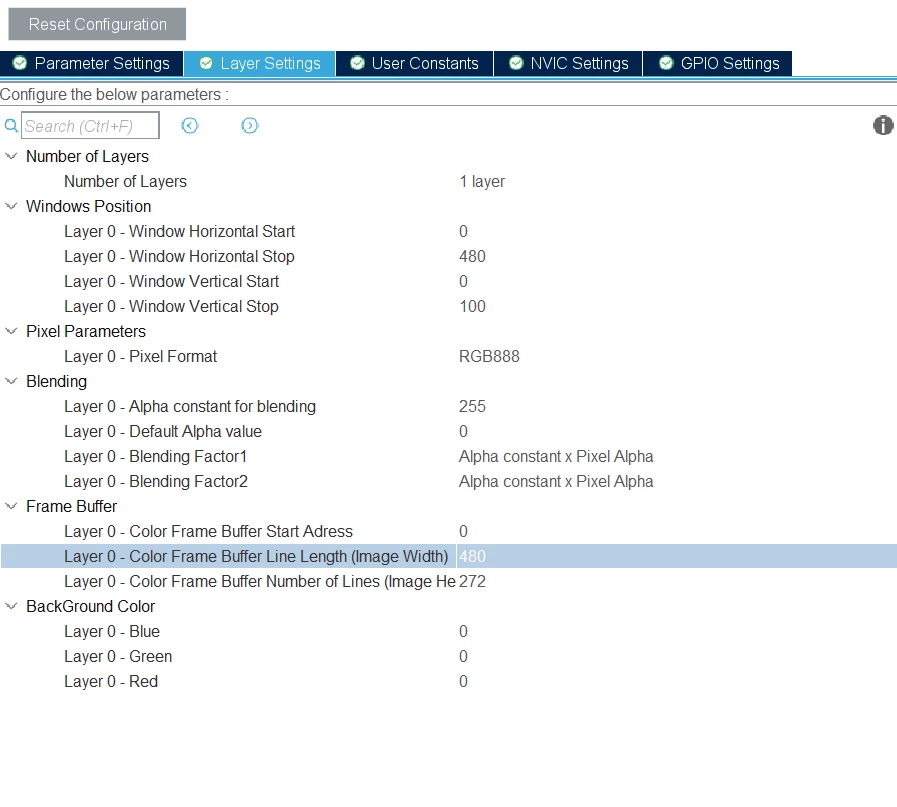

Try explain this FYI RGB888 is 3 byte format not UINT32 pointer format
uint32_t *framebuffer[480*100];
and show LTDC layer config.

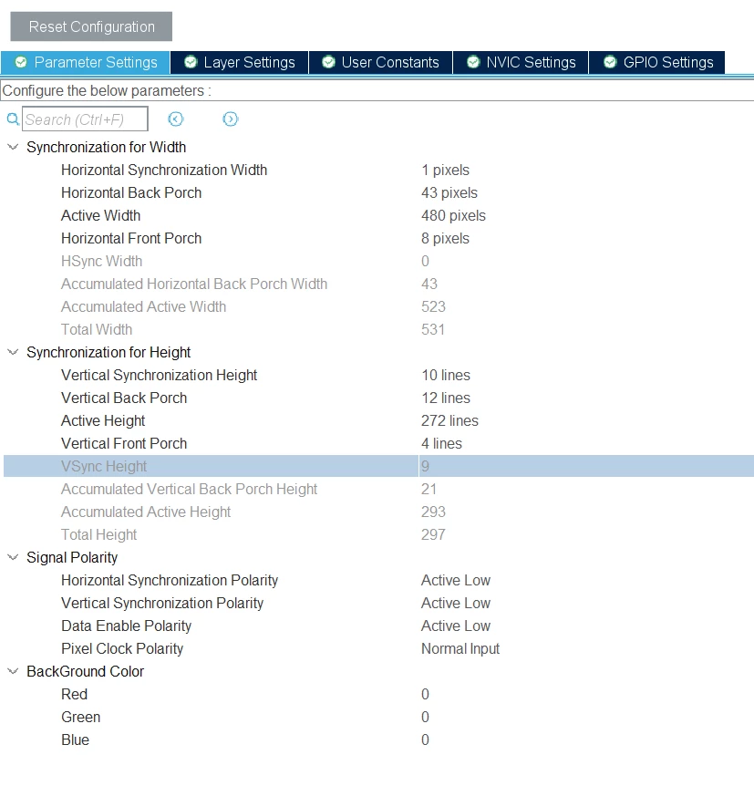

Nov 26, 2022 3:34 PM UTC
Many thanks for your reply.
Please see attached screenshots for LTDC config.
I am probably mixing something up in regards to store RGB888 3-bytes into the 4-byte format. According to Color Formats | TouchGFX Documentation a purple color RGB(255,0,255) should be represented using: uint32_t brightPurpleRGB888 = 255 << 16 | 0 << 8 | 255 << 0;
But I just can't get it to work..
Southbranch
Senior
Nov 26, 2022 3:36 PM UTC
And here is the remaining LTDC config.

Your code is complete bad. You set RGB888 for layer then data need place in memory every 3 bytes.
#define BUFFERSIZE 480*100*3
uint8_t framebuffer[BUFFERSIZE];
static void FillDisplay(void)
	// any collor
	for (uint32_t i = 0; i < BUFFERSIZE; i+=3)
		framebuffer[i]= 0x00; //R or B collor
		framebuffer[i+1]= 0x00; //G collor
		framebuffer[i+2]= 0x00; //R or B collor
