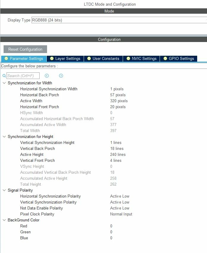

i try to start application on STM32F7 with external RAM.
I setup frame buffer and cache in external RAM, but touchgfx not loading screen to FrameBuffer, Cache is loading.
I check if image will render when a set start address of cache and FrameBuffer the same and it worked.
What may be source of the problem?

By LTDC configuration i also mean timings / porch settings - Do you have that right as per the display datasheet? is 0xc0000000 also set as the start address for touchgfx in the generated code? Is touchgfx configured to use LCD24 as its display driver? (given the RGB888 configuration ?

  • By LTDC configuration i also mean timings / porch settings - Do you have that right as per the display datasheet?
YES
  • is 0xc0000000 also set as the start address for touchgfx in the generated code?
YES
  • Is touchgfx configured to use LCD24 as its display driver? (given the RGB888 configuration ?

Could be your refresh count then. From your previous images it is set to 1752 - This value is greyed out so it's set somewhere else.
I recall that I ended up changing this manually. If you got the SDRAM example running then check the SDRAM settings up against the ones you're using on your touchGFX implementation.
Do you know that the display is working? Ie. did you try to load a static image up from the internal memory first? if not it could be the display timings. App not 4861 is a good place to start for this if you need more info.

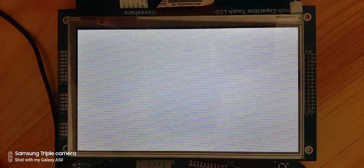

GMano.1
June 20, 2021
Hai...,
I am also facing same problem.
STM32F746IG (waveshare Development board) with 7 inch display.
I done every thing @HP​ (Community Member)​ but still have a same problem.
pLayerCfg.FBStartAdress = (uint32_t) & Image_data_image_Text; it work fine.
But if i change bellow address.
pLayerCfg.FBStartAdress = 0xD0000000; not working display image below (i am using bank2 so that use this Frame Buffer Start Address).
What are cause of this issuse?
Martin KJELDSEN
Principal III
June 21, 2021
Can you inspect that memory? Is anything actually being drawn? Maybe the display is showing the correct content (garbage).
TouchGFX HAL will set up the start address of the LTDC layer automatically based on what you set up TouchGFX with, so you shouldn't need to do this.
Can you show me your TouchGFX Configuration? If TouchGFX does not know about this address as the framebuffer address it won't render anything to it.
Let me know-.
