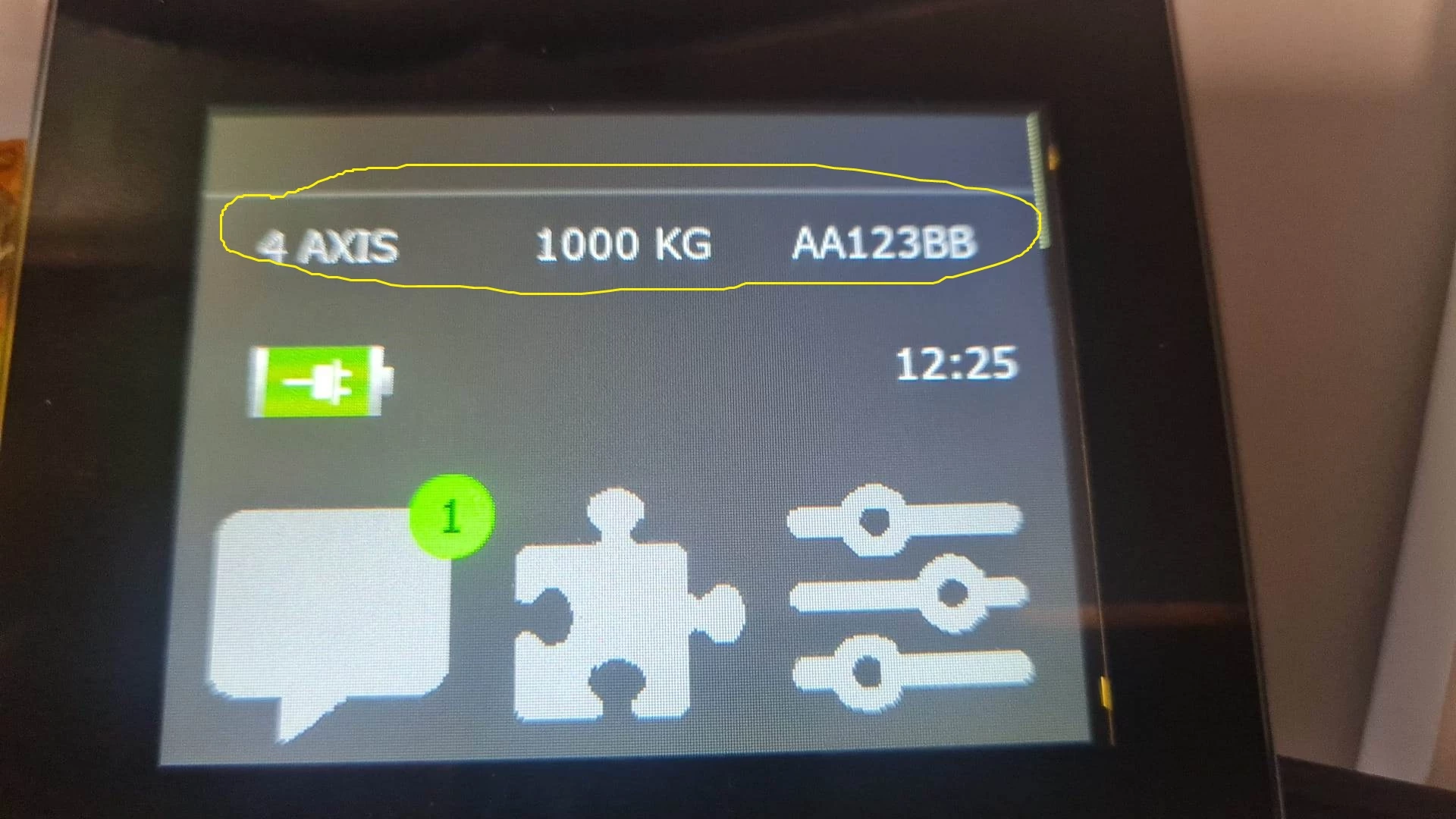

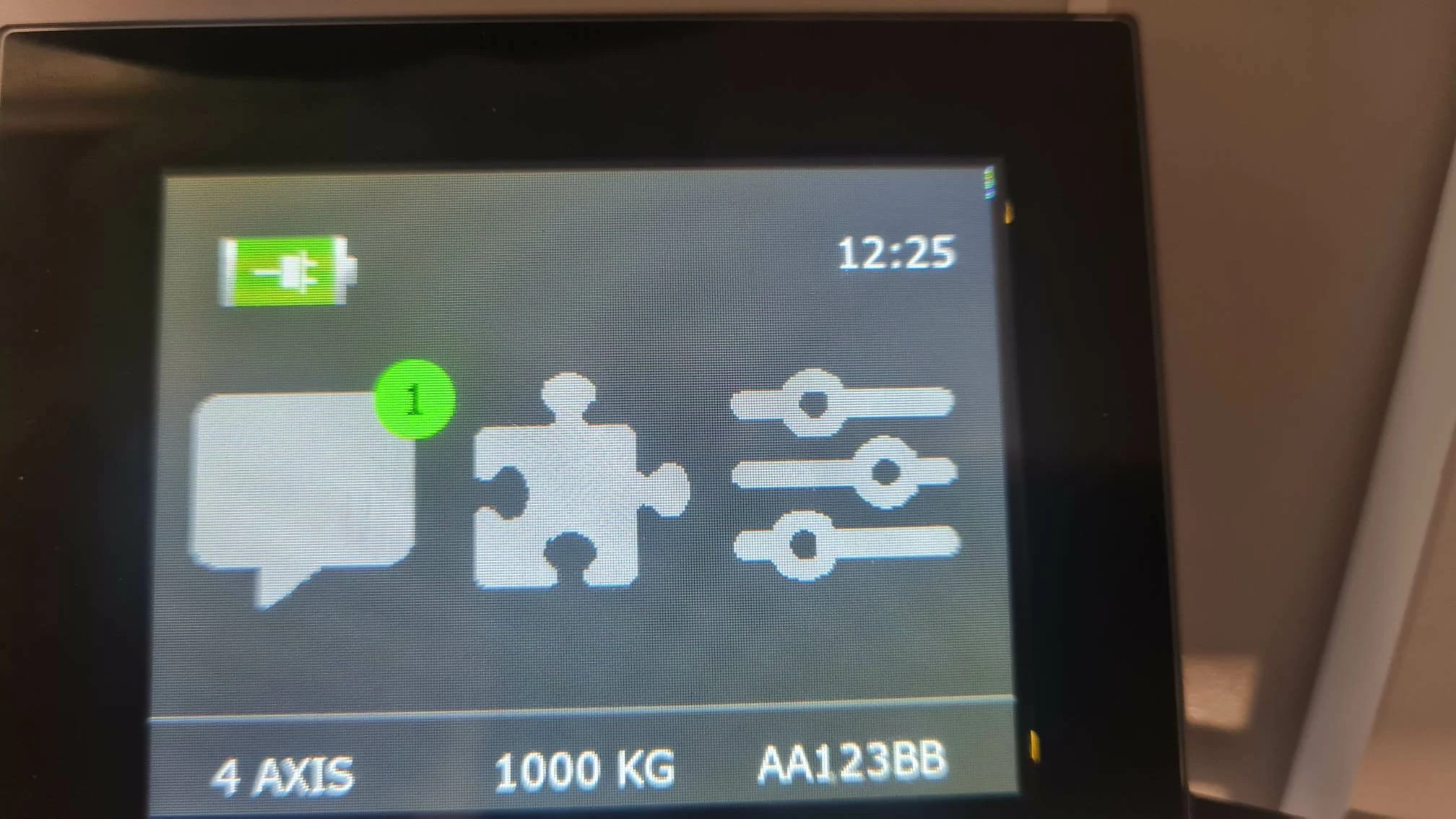

FrameBuffer corrupted (shifted horizontally to the bottom, and the part exceeding appears on top (the frame buffer rotated??) with STM32L4P5

When I now add some global variables in my source code, as the application is run, the first image displayed is immediately wrong: it is shifted horizontally to the bottom, and the part exceeding appears on top (the frame buffer rotated??)
Please note that the global variable that is changed has nothing to do with the display and it’s not used as the application starts. It’s an array of struct that I increase from 2 elements to 3 or more.
I state that the main cycle calls nothing but TouchGFX functions, and global variables are not used yet when the problem appears (immediately when the display is first drawn)

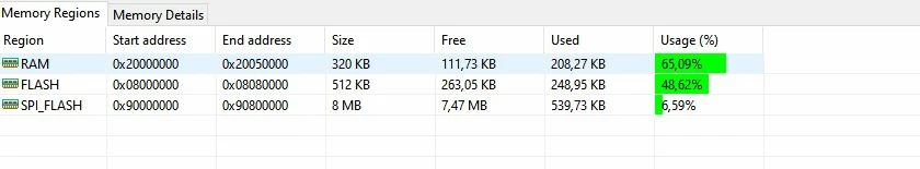

This is my configuration
- STM32CubeIDE 1.9.0
- TouchGFX 4.19.0
- STM32L4P5ZETX
- FLASH SPI 8 Mbytes per immagini TouchGFX
- DISPLAY 320x240 16 Bit (RGB565)
