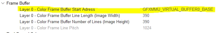

Am currently working on STM32L4R9AI-EVAL board and i have so many doubts about frame buffering....
1.when we have to use single frame buffer,when we use double frame buffer,and partial frame buffers and rendering time is less for single buffer or double.....
2.Can we access the frame buffer,if it is yes and how to do that i need a procedure to do that because i don't know anything about it....
3.Do the touchgfx supports vertical swipe and how to enable it...

In the similar way i want to know the "frame buffer name" exactly where they are storing the whole screens so that i want to access that buffer and i want to write all pixels value zero to make (LCD off) after i want to make all Pixels ON by writing 0xffff...how do i do this...
thank you in advance

Alexandre RENOUX
Visitor II
Mar 5, 2020 2:46 PM UTC
The framebuffer name for the L4R9-EVAL is GFXMMU_VIRTUAL_BUFFER0_BASE. You can find it if you open the ioc file in LTDC -> Layer Settings
I don't think just writing zero to all values will literally turn off the LCD. If you just want to make the screen black, doing it in the Designer is much easier and recommended.
/Alexandre
