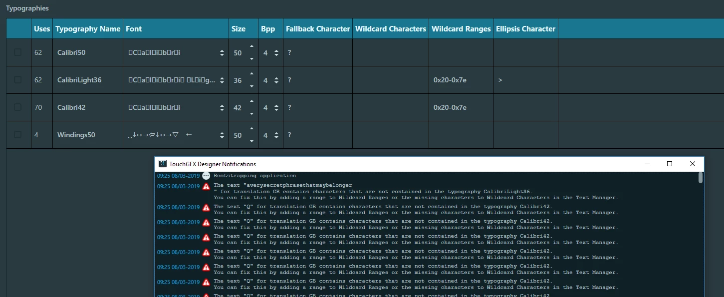

I'm getting errors (image attached) reporting that characters are not part of the typographics.
For both fonts reported i have a range of 0x20-0x7e entered for wildcard range (also shown in attached image)
Cant run simulator or target while in this mode, what am I missing?

Hi @brianshankland9​,
Could you send me your project?
brianshankland9
March 11, 2019
