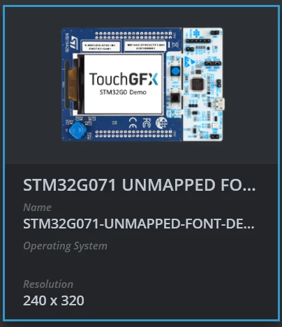

Hello V.H,
For your typography, do you use 4bpp? Is the problem also there if you use 8bpp ?
Have you set the ByteAlign bit (previously known as A4) ? You can refer to this link if you're unsure.
I can suggest you to try a similar configuration as our TouchGFX Designer demo : "STM32G071 Unmapped font demo" for your project.
/Osman
