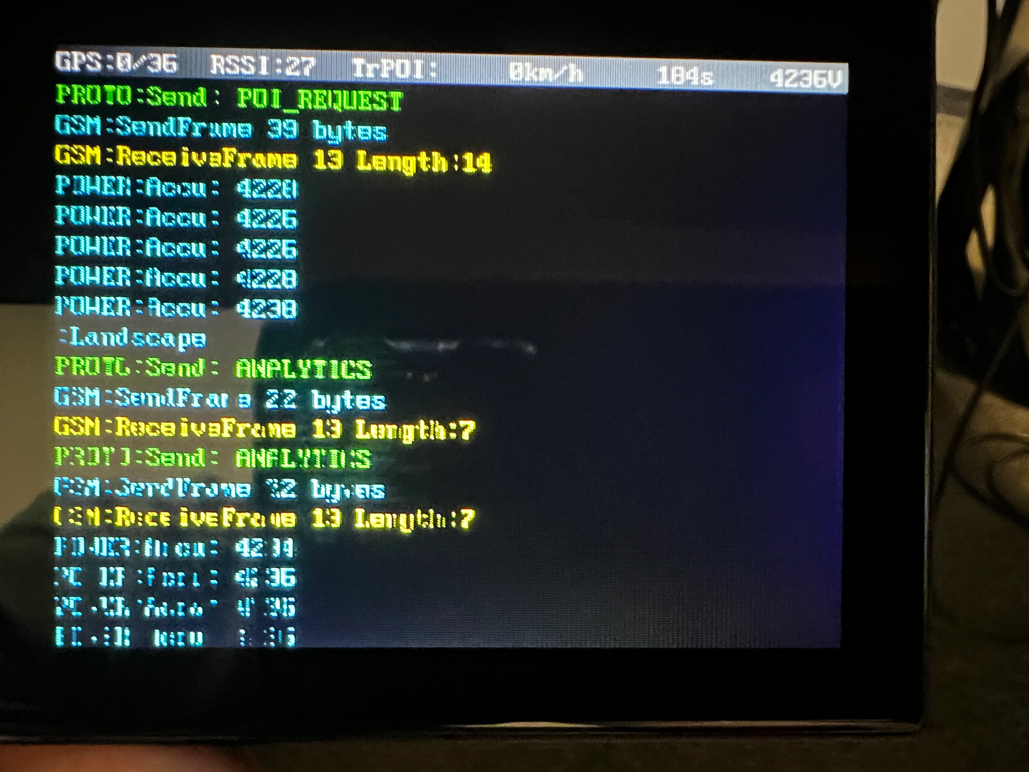

I decided to update TouchGFX in my project from 4.20 to the newest 4.23. I noticed some artifacts in font rendering from time to time. Below I attached a photo of the issue.
Do you have any ideas why this is happening?

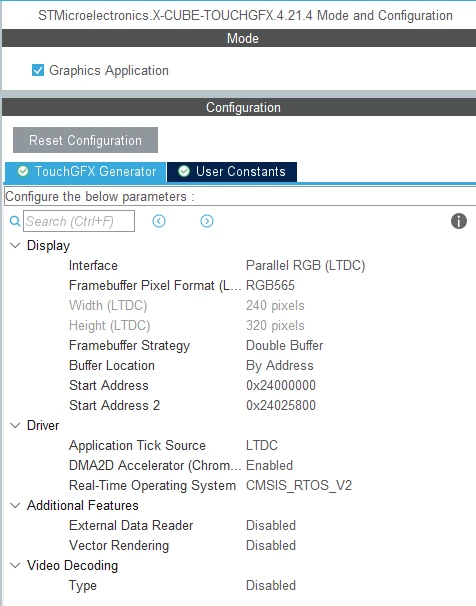

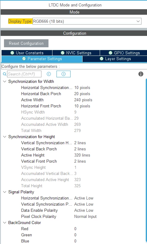

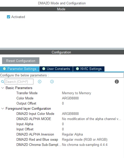

I'm back to the topic. I upgraded to TouchGFX 4.23.0 mainly for SVG images. I checked if the issue persist on older versions of TouchGFX which still have SVG images. I stopped at 4.21.4 and unfortunately artifacts in the font rendering are still in place.
I cannot share with you my whole project (confidential) but I created some sample screen using ST stock images. Below you can find a video and also my configuration you asked about:
The board is custom. We use parallel RGB LTDC RGB666 to drive the LCD. We also use DMA2D. The configuration of the peripherals:
DMA2D:
LTDC:
TouchGFX:
"text settings and typographies":
I attached the video describing my problem and also source code of the screen.
