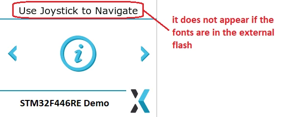

I have ported the Application Template for NUCLEO-G071RB+X-NUCLEO-GFX01M1 to NUCLEO-F446RE+X-NUCLEO-GFX01M1.
When i use external Flash for fonts, I do not see on the display all the text "relating to the language" (like "Use Joystick to Navigate" etc.).
If I use the internal flash for fonts, i see texts that i didn't see with the previous configuration!
Attached an image that I hope better explains the problem I have.

Solved!
In TouchGFX Designer -> Config:
1 - disabled TextureMapper in Framework Features
2 - select Unmapped storage format instead of Mapped storaga format in Text Configuration
