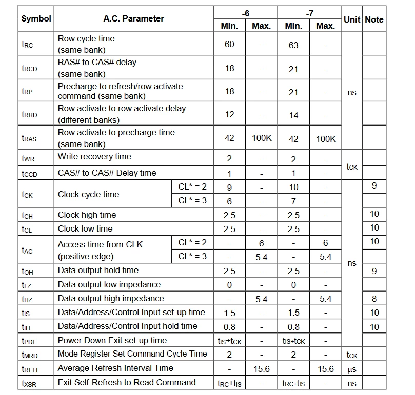

I have made a board with AS4C4M16SA for the SDRAM, datasheet here: https://www.alliancememory.com/wp-content/uploads/pdf/dram/64M-AS4C4M16SA-CI_v3.0_March%202015.pdf
The timing information is on page 20.

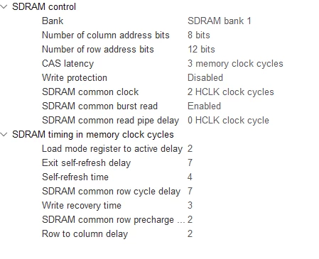

More specifically I am looking for a way to figure out the timing setup from the datasheet:
0690X000009k4zLQAQ.pngThose are the value for the SDRAM supplied with the STM32F746G-DISCO board.. is there any pointers on how to adjust these values for a new chip?

To work from datasheets you need to convert the cycle counts into nano-seconds, based on how you're clocking the interface, and then make sure these are adequate to meet the specifications. If CubeMX were more useful it would show you the cycle count AND ns speed.
You need to initiate a refresh at 64ms/4096 intervals, at bus clock

I'm running at 200MHz, which should bring my interface to half or third of that - depening on what I choose in 'SDRAM common clock' - right?
that means either 100MHz or 66.6MHz. I'm going with 100MHz. that gives me a period of 10ns - easy to calculate with
refreshing time:
if I first find how many times 10ns can fit into 64ms - that is 6400000 times. I need to refresh 4096 times in that interval, so each 1562.5 cycle. got it. i'll just set it to 1562. (1041 for the 66.6MHz version)
Now I need to find the right numbers for all the other parameters - Most of them are minimum values so maybe I can just be on the safe side?
this is the timing values from the datasheet.
Load mode register to active delay:
I have no clue which number this is.. any clue??
Exit self-refresh delay:
datasheet says 'Trc +Tis' which is 60ns+1.5ns - if I set this to 7 I'm good (70ns)
Self-refresh time:
No idea..
SDRAM common row cycle delay:
is that the same as the Trc? if that is the case it could be set to 6..
Write recovery time:
datasheet says 2 cycles - that is 20ns.. I'll put 2 in CubeMX
SDRAM common row precharge delay:
looks like the Trp in the datasheet? setting to 2.
Row to column delay:
is that the Trcd in the datasheet? then it should be 2.
Does that seem about right?

Load mode register to active delay -> Mode Register Set Command Cycle Time
