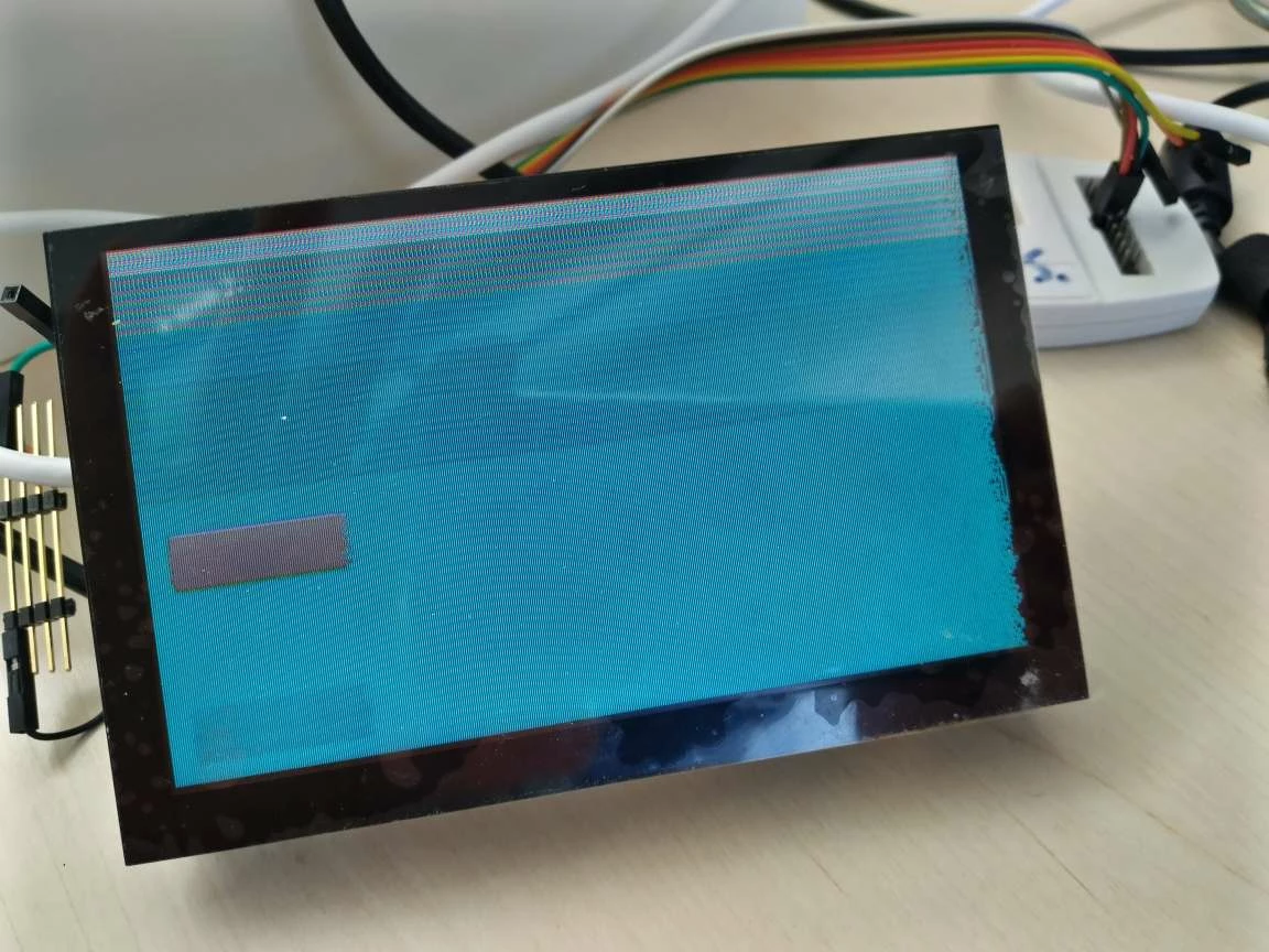

The issue i'm facing now (before delving more in depth on the touch screen driver as next steps) is about a "flickering" starting to appear some 30 seconds later after program running.. see the video below (complete "idle" framework, Model.cpp tick() is called, empty, nicely..)
it looks to me some kind of "hardware FIFO/DMA" is trashing.. but i'm puzzled because it does NOT happen at start, but at a later time.. and it goes worst along time
i'm just wondering if you have seen something similar before.. and/or have a clue about where to look more in depth.. i'm planning to check the MCU instrumentation binding, just to check "how high is the CPU load".. what do you think?

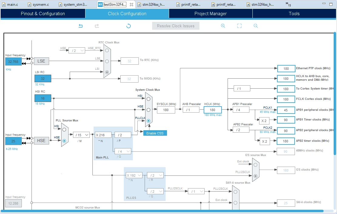

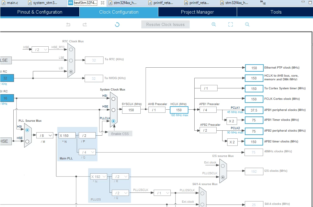

just to add some more info, the clock cfg in the CubeMX prj
0693W000001qIlwQAE.pngand another later short image about artifacts becoming worst.. still running and not stuck, anyway
let me finally add we are talking about a 800x480 display with RGB888 (3 byte) pixels.. so i know it's quite taxing the SDRAM.
i used the SDRAM params from the BSP of the vendor, and it works ok for the first 30 secs, so that's quite puzzling me..

thanx Alexandre for your reply.
as sometime happens, when one starts talking about, some light is shed on the right spot!
i checked the clock tree, it looks like i'm using the internal HSI (too high RC jittering when SOC warming?) and not the external HSE (a 25MHz crystal..)
when i moved to the HSE, indeed, the flickering is no more..
now i've got also 30MHz of CPU cycles for free! :)
sorry for the noise on the forum..
