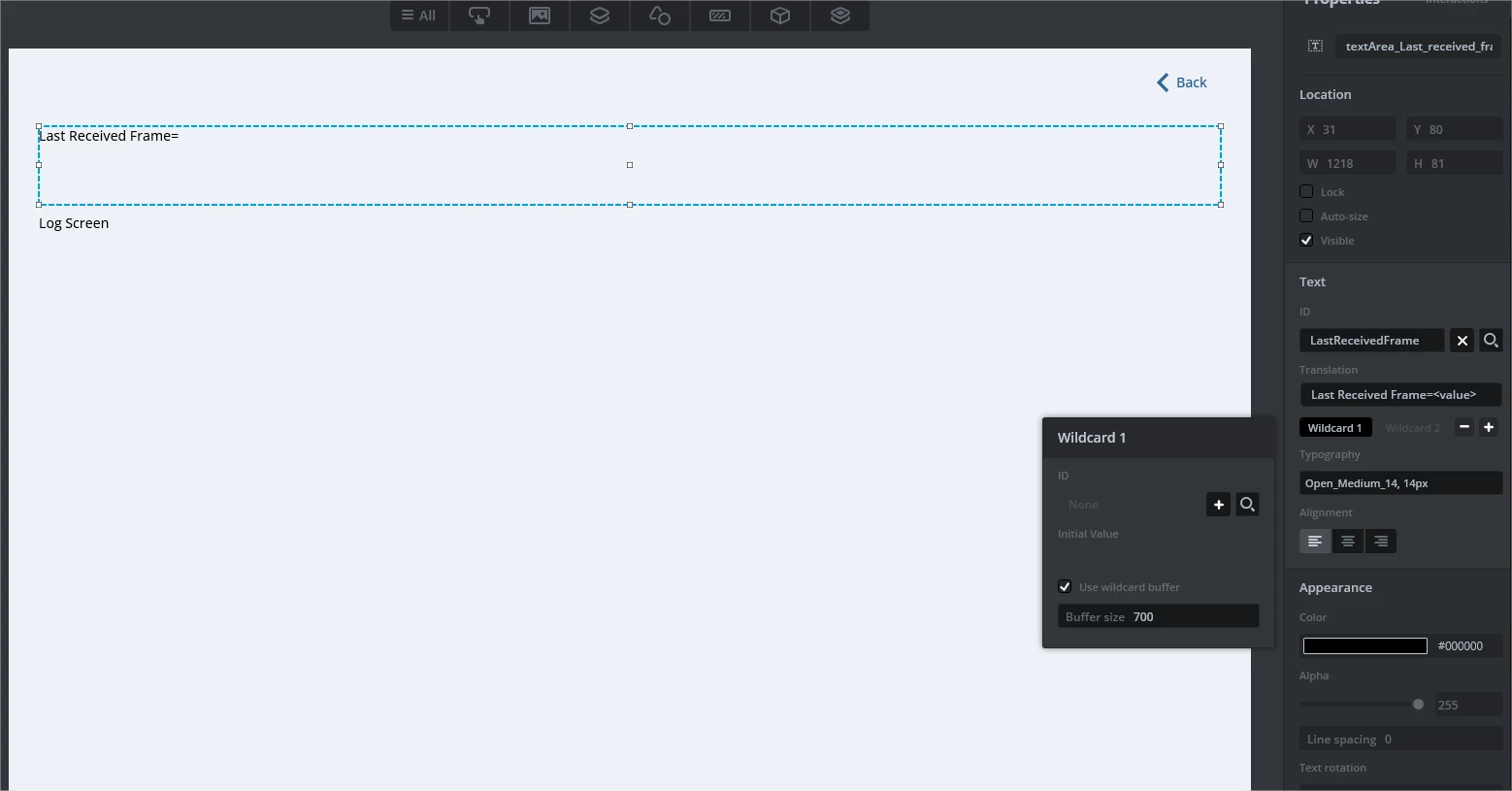

I'm also experiencing 2 different behaviors for the text (staying in the same screen here)
I have a screen with 2 texts zones, one small and one big and the biggest zone flickers when I update it with invalidate. The smallest one has no problem. They do not superpose.
Here's my tick function handling the text zones:

	memset(&textArea_Last_received_frameBuffer , 0 , TEXTAREA_LAST_RECEIVED_FRAME_SIZE);
	Unicode::strncpy(textArea_Last_received_frameBuffer,(char *)Serial_Frame,strlen((char *)Serial_Frame));
	textArea_Last_received_frame.setWideTextAction(WIDE_TEXT_CHARWRAP);
	//textArea_Last_received_frame.resizeToCurrentText();
	textArea_Last_received_frame.invalidate();

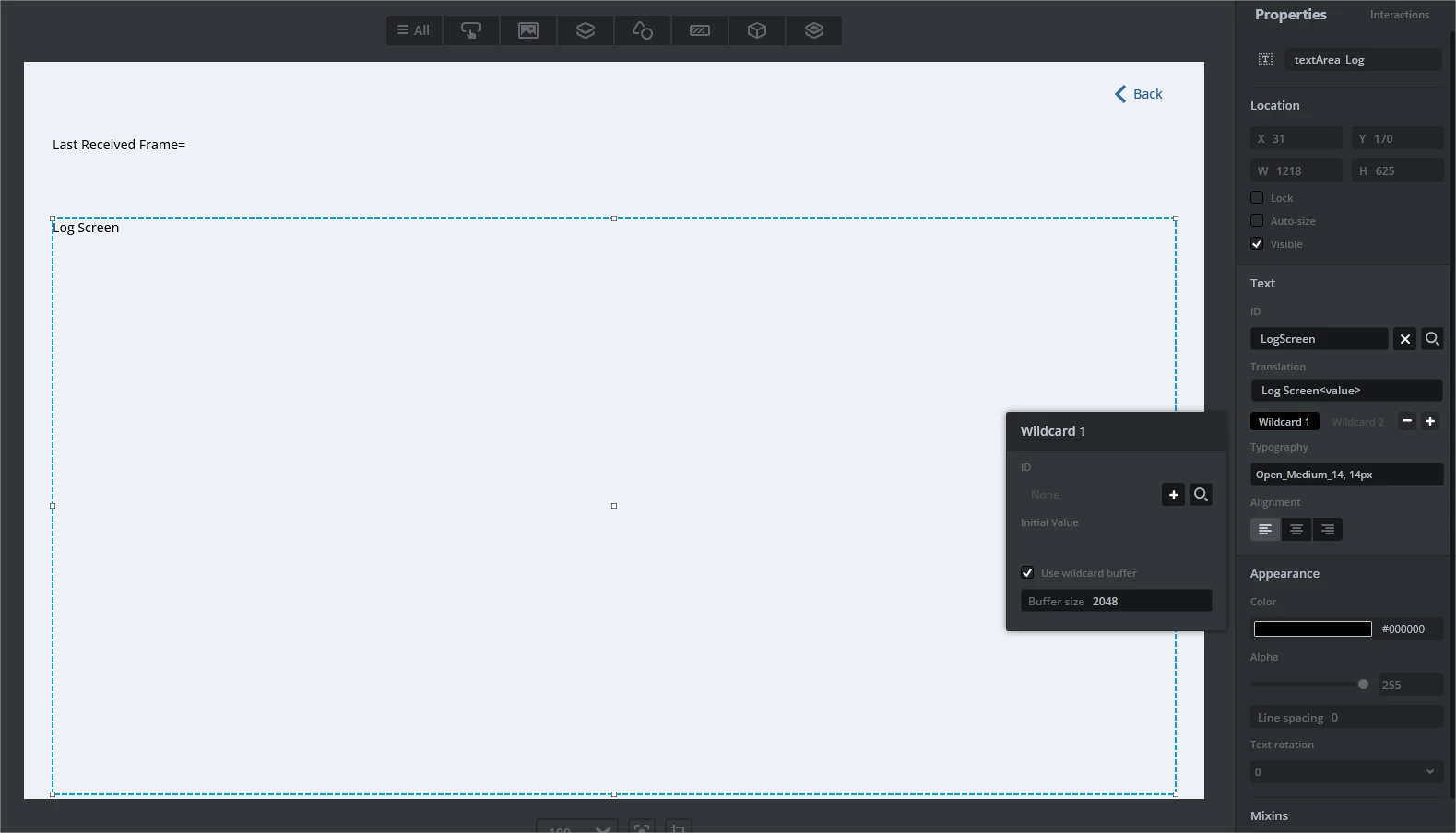

	memset(&textArea_LogBuffer, 0 , TEXTAREA_LOG_SIZE);
	Unicode::strncpy(textArea_LogBuffer,(char *)HMI_Full_Log,strlen((char *)HMI_Full_Log));
	textArea_Log.setWideTextAction(WIDE_TEXT_CHARWRAP);
	//textArea1.resizeToCurrentText();
	textArea_Log.invalidate();

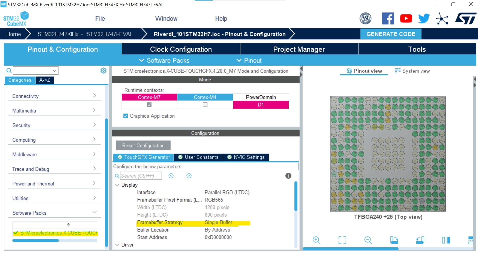

The framebuffer strategy that MM..1 is talking is about your display configuration; if you open your project ioc file with STM32CubeMX, you can get this information. If it's a single framebuffer strategy, you can try to change it to double instead to prevent your flickering images. I invite you to follow this guide to change the framebuffer strategy.
/Osman

I have tried what you said, but it doesn't change a thing. I've also looked at the screen closer and it seems like the first text flickers too but it's less noticeable.

You realy switch to double buffer ? How address1 and 2 used? Regenerated projects in TGFX and CubeIDE? ...
