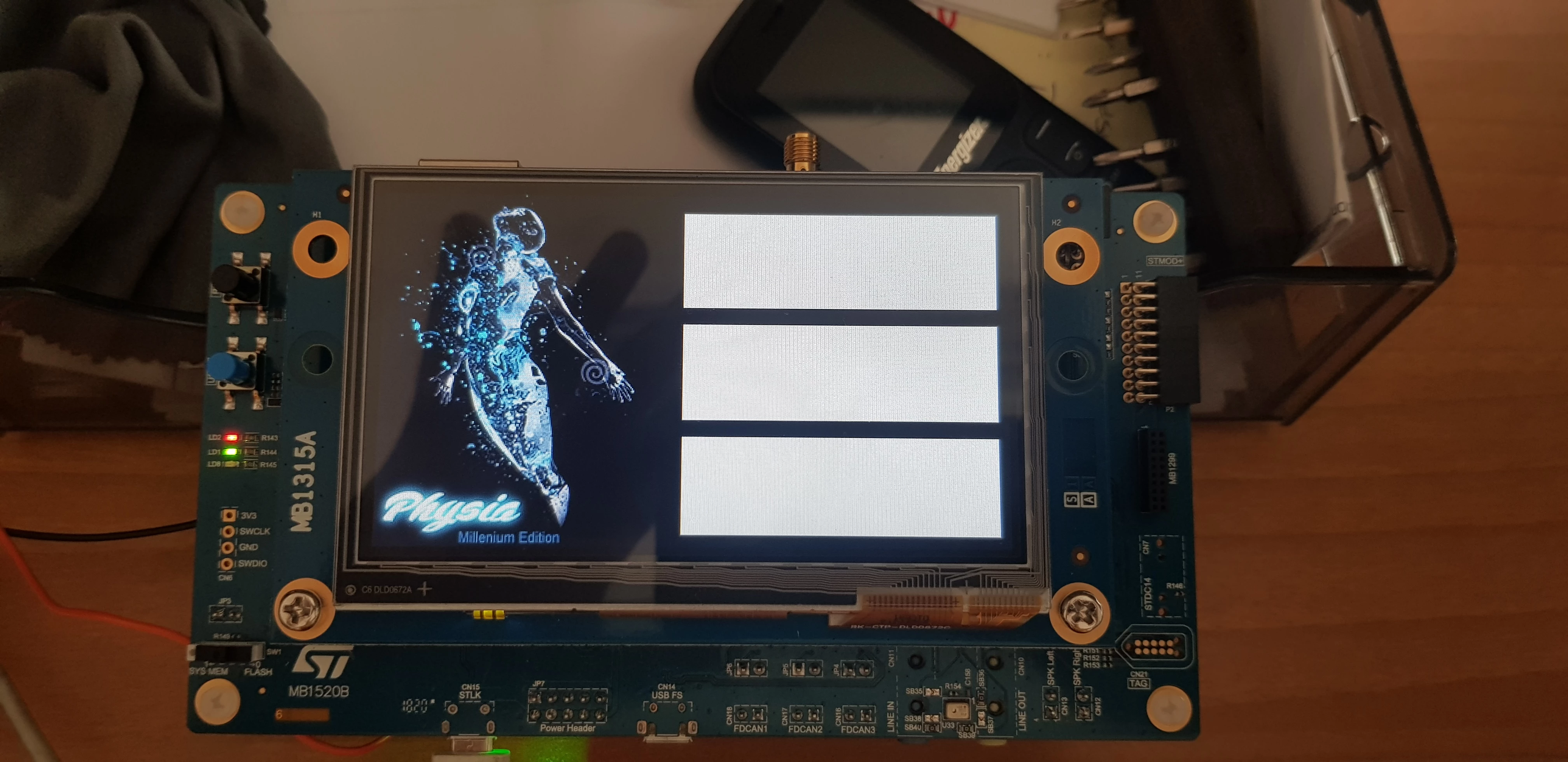

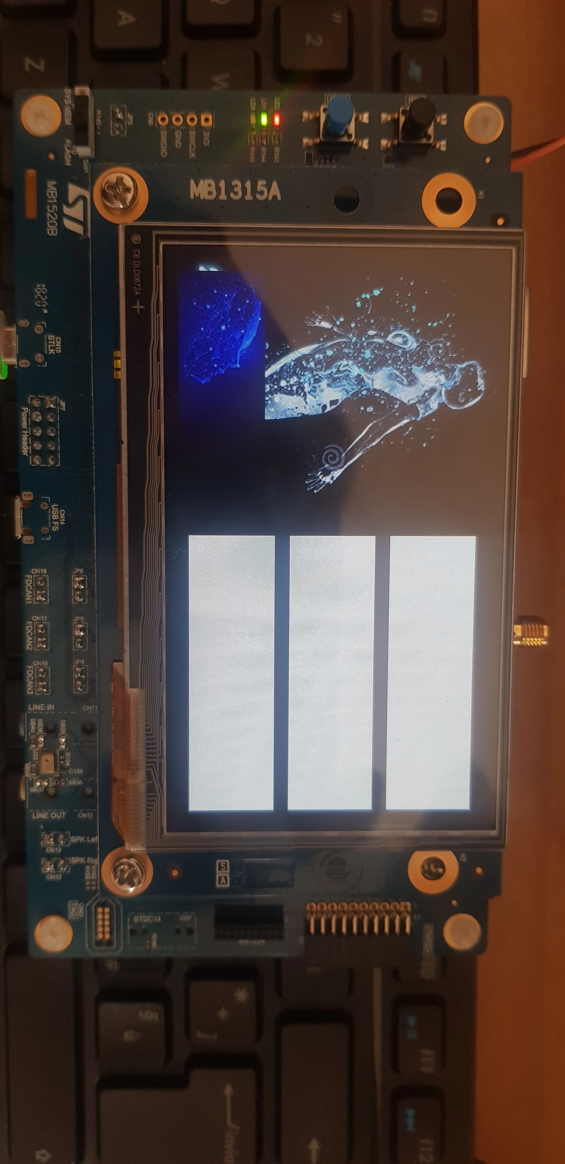

Hi all,
I'm trying to use flexbutton having three layers (text, image, box with borders).
Everything looks fine on the designer (4.17.0) but when i flash the target device (stm32h735disco) the images aren't shown.
This happens flashing both from designer 4.17.0 or IDE 1.6.1
Any advice ?
Thanks!

Can you display those images when using a Image widget instead of a flex button ? are they stored in internal or external flash ? Could you share one of them so that I can try to replicate it ?
/Romain

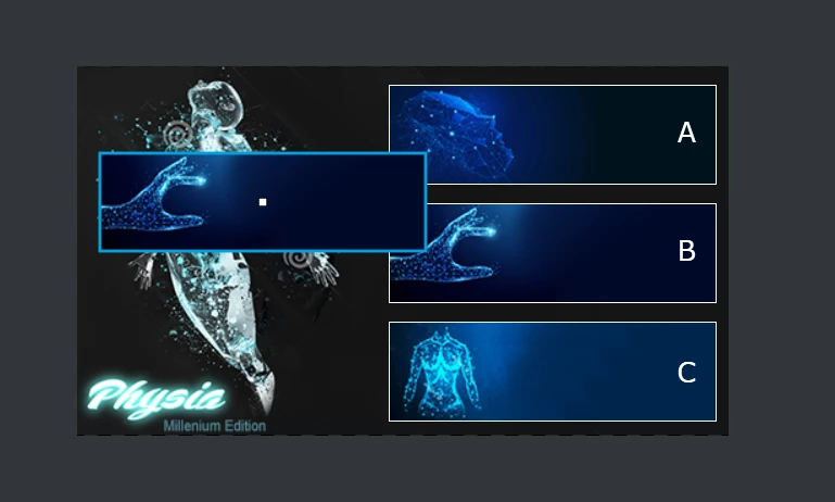

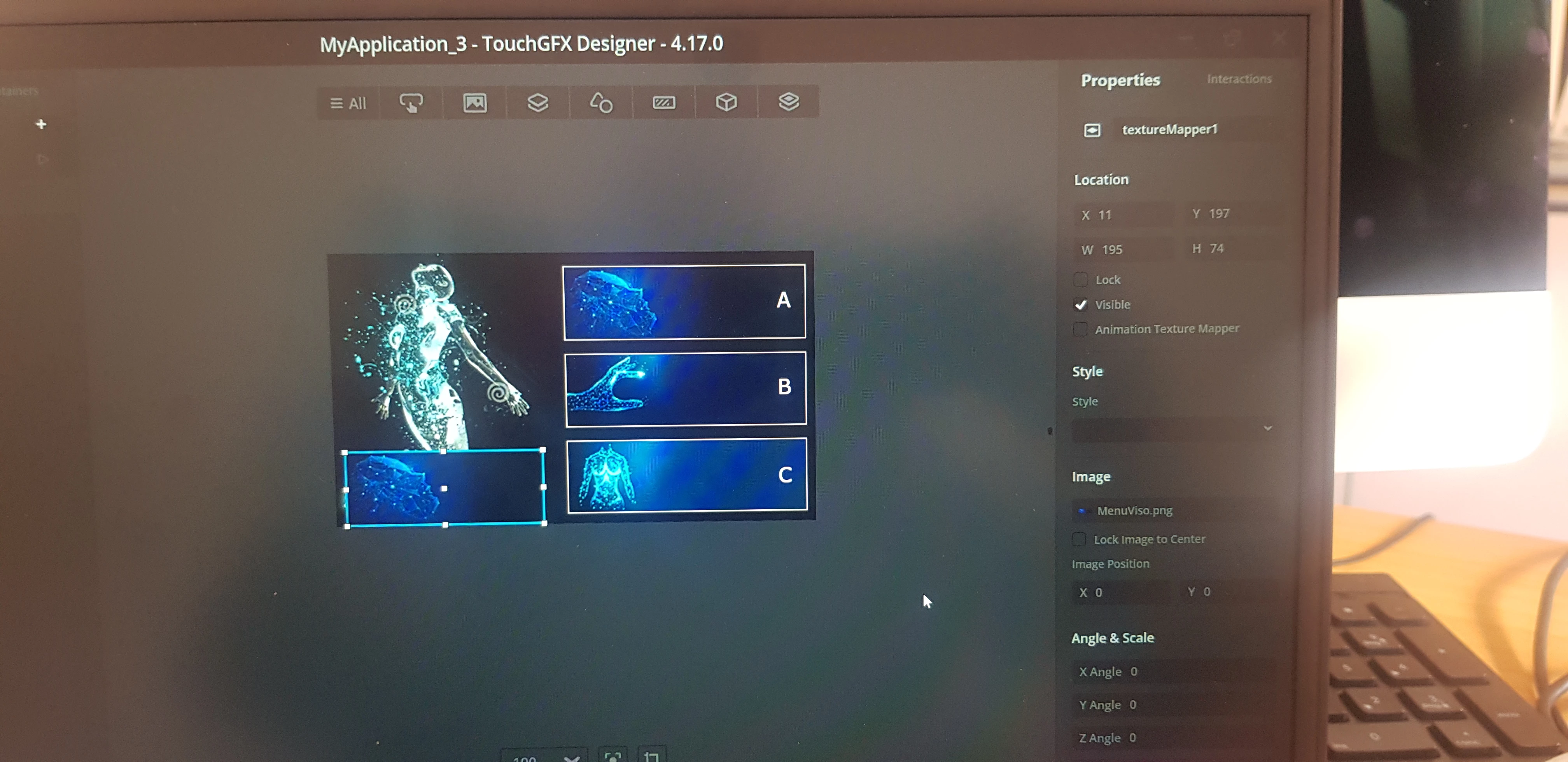

0693W00000Dn8Z5QAJ.png0693W00000Dn8ZTQAZ.jpgHi Romain, thanks for your interest.
Yes, the Image widget works fine, you can see it in action in the attached files.
I also attach the png file I used for this example.
Thanks

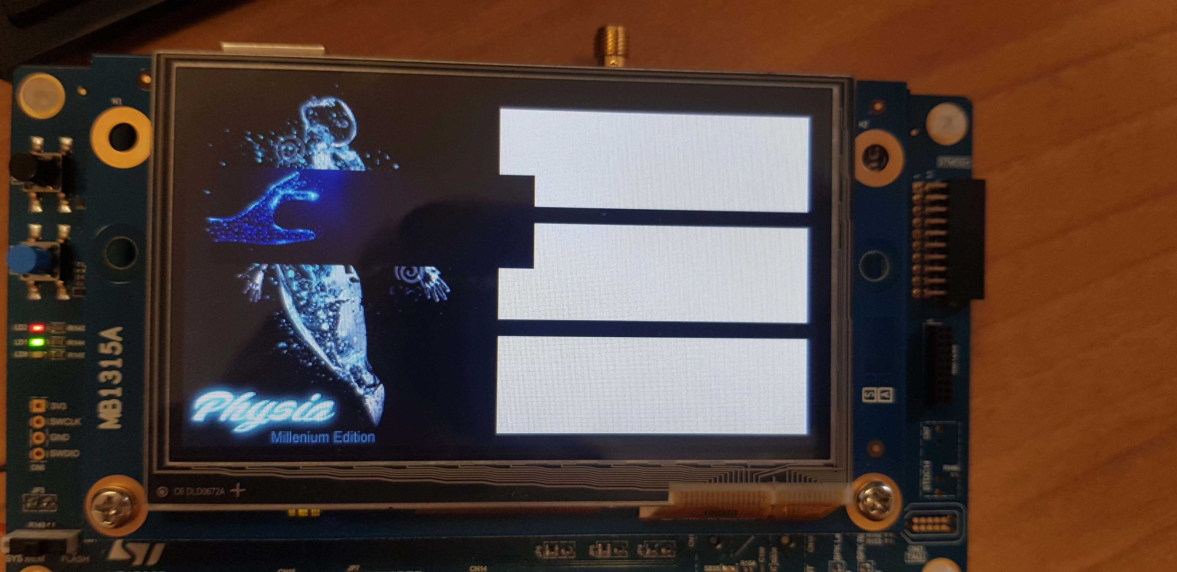

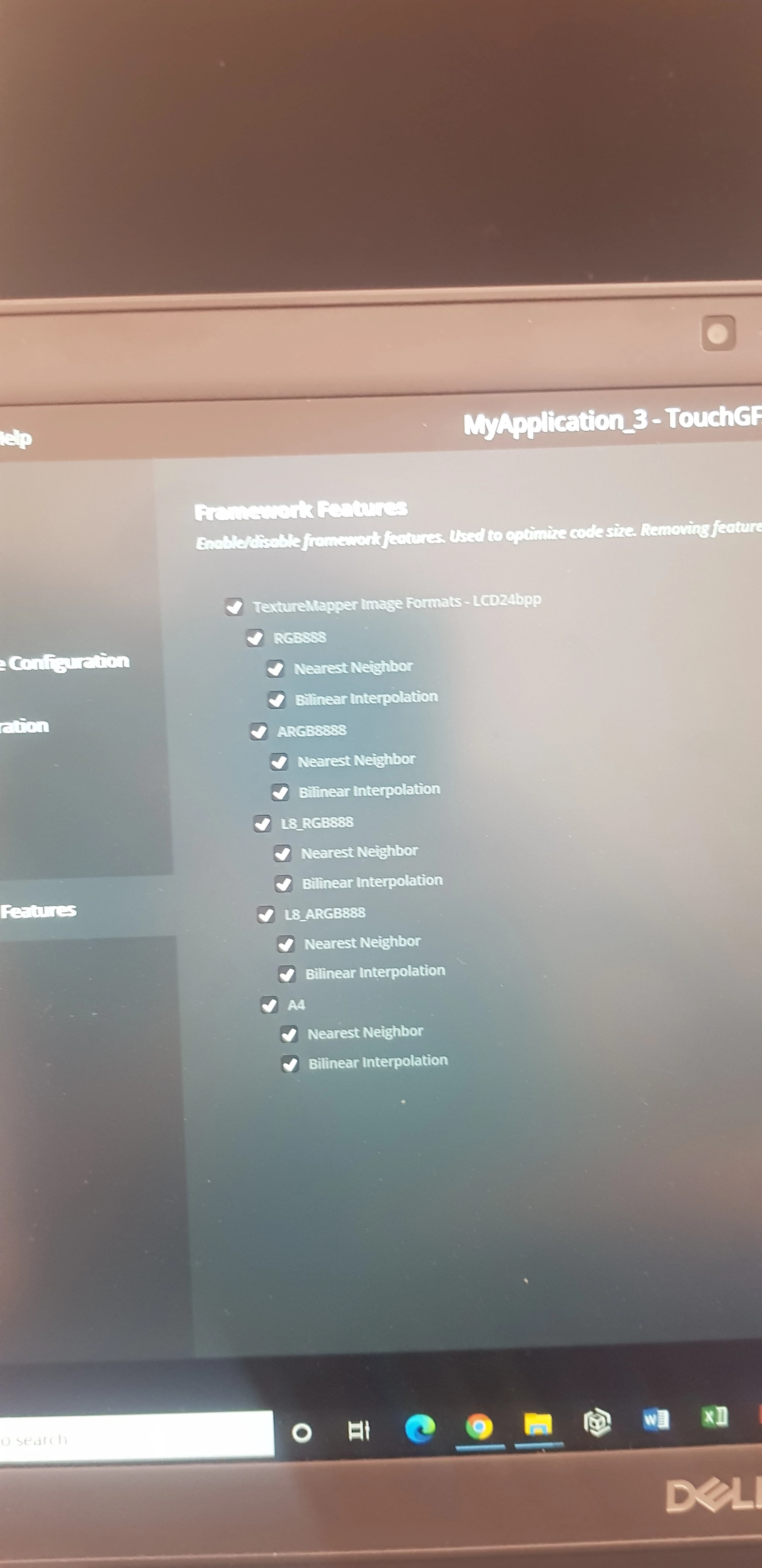

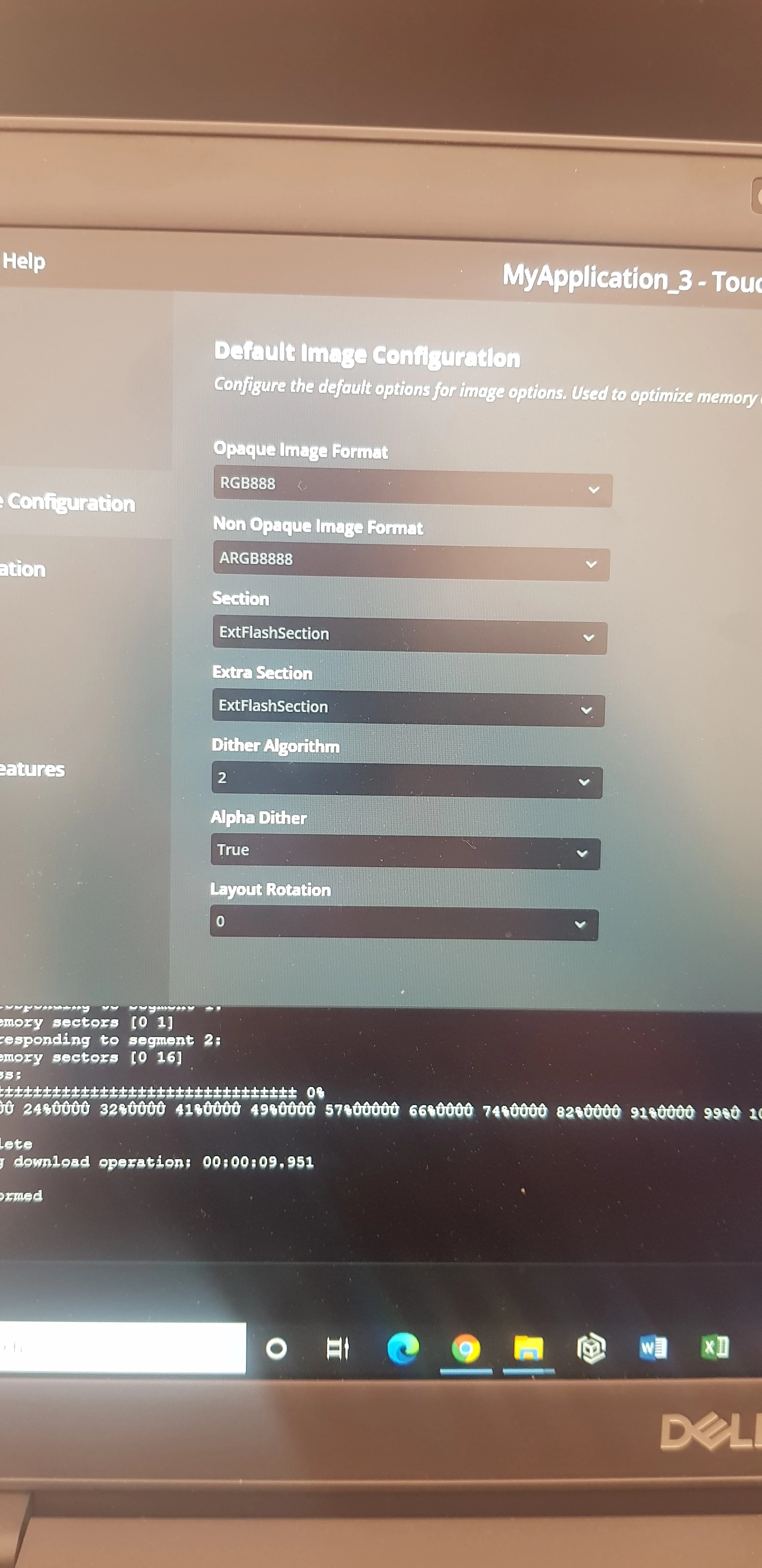

Hum it does work on my side this is strange. Did you start your project from the available TouchGFX Board Setup for the STM32H735disco or did you start your project from scratch from STM32CubeMX or STM32CubeIDE ? Could you go to the "Config" settings (click on the "Config" tab on the left of TouchGFX Designer) ? There go to the "Framework Features" settings and make sure the relevant features are set. The Flex Button widget uses texture mappers unlike the Image widget, so maybe try to use a Texture Mapper widget (found in the same group as the Image widget) to see if my suspicion is correct.
/Romain

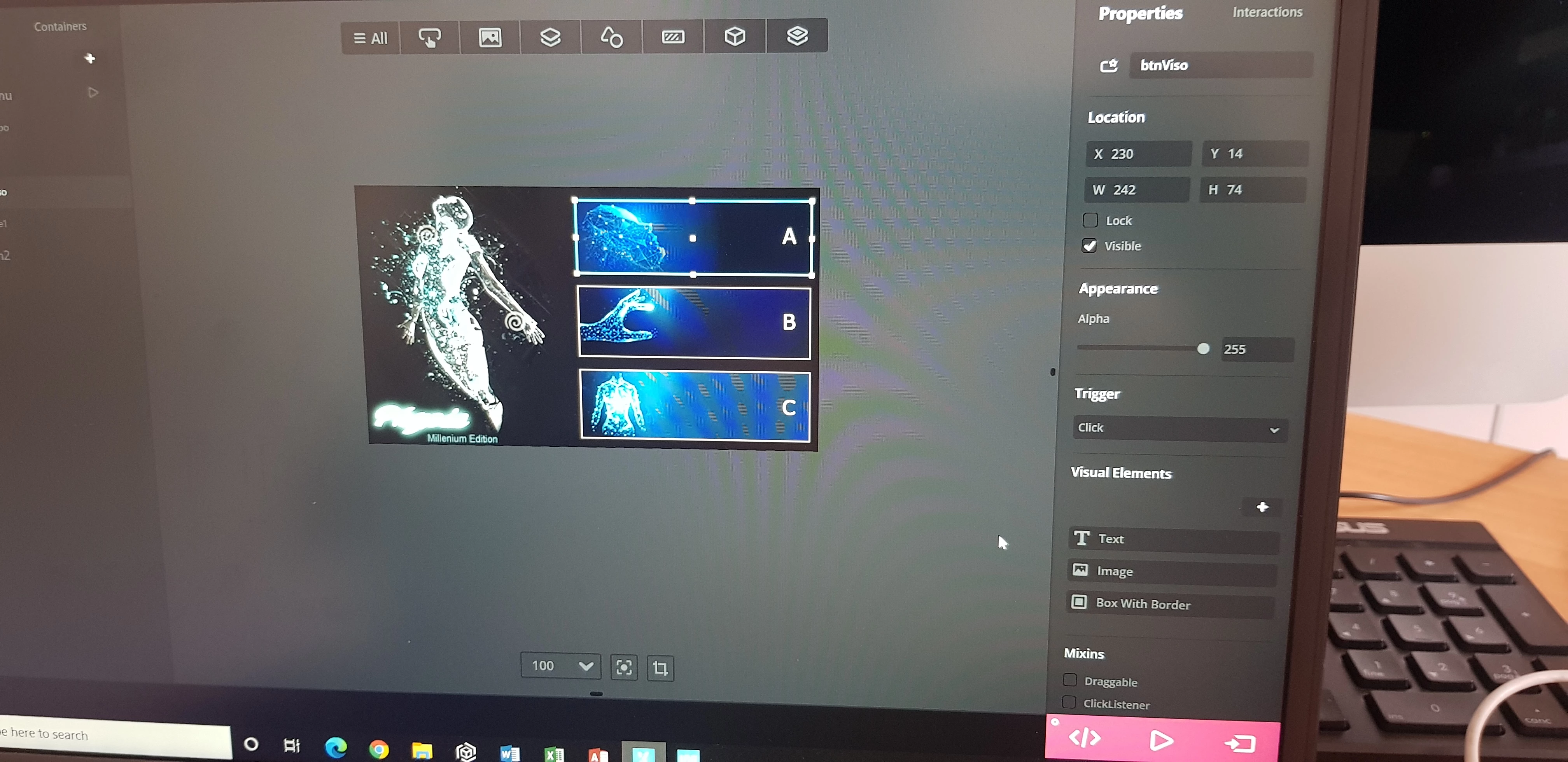

0693W00000DnDiVQAV.jpg0693W00000DnDdNQAV.jpg0693W00000DnDvZQAV.jpgI started a brand new project from TouchGFX Designer using a blank project ( I mean from scratch) selecting STM32H735disco as target
The control you can see in the attached picture is a texturemapper widget, it seems to work fine....
More, all of the checkmarks in the framework features tab are checked.
I agree with you, this sounds really strange...

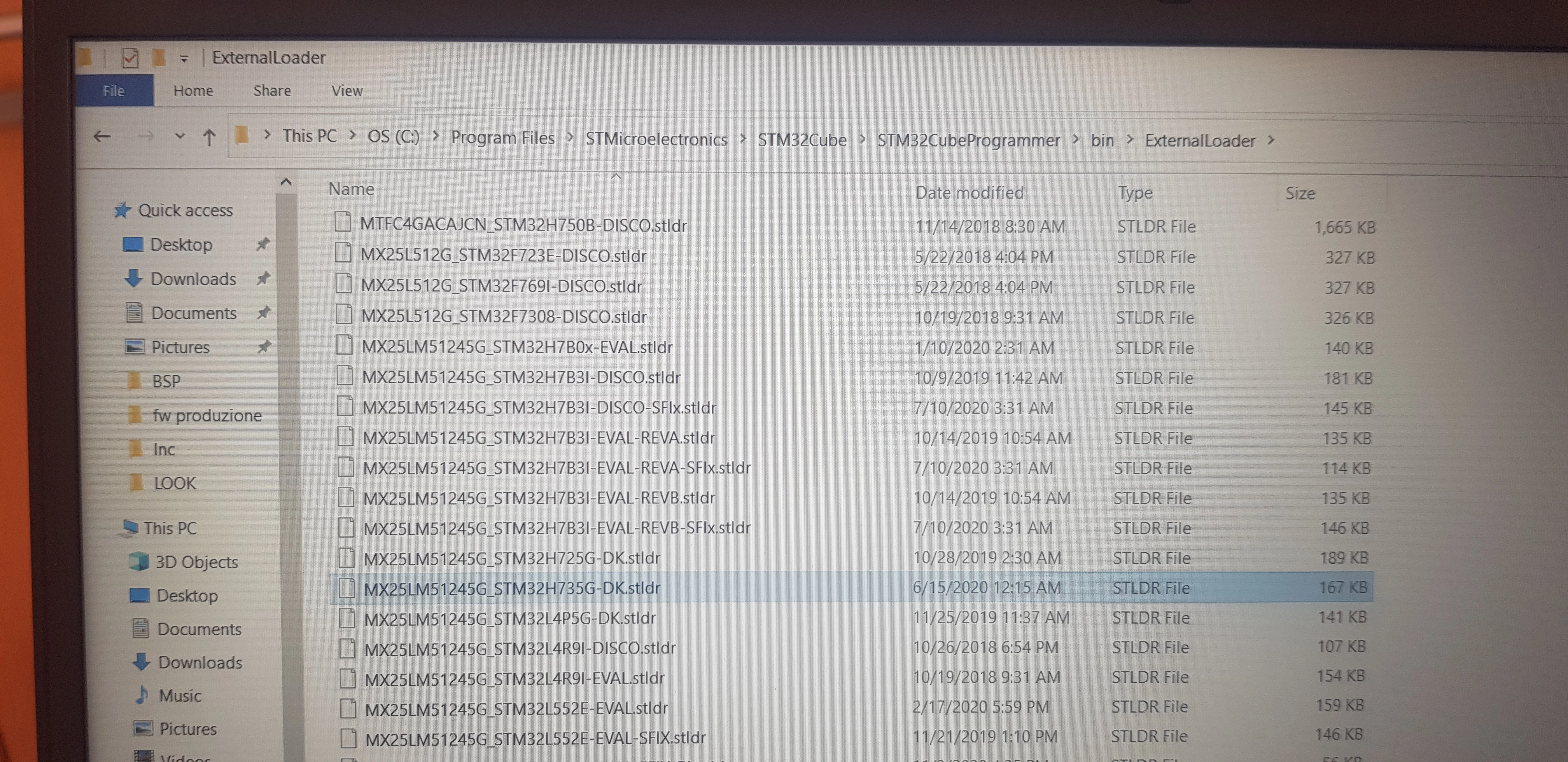

Could you also navigate to the C/Program Files/STMicroelectronics/STM32Cube/STM32CubeProgrammer/bin/ExternalLoader folder and look for MX25LM1245G_STM32H735G-DK.stdlr ? I want to make sure you have the external loader available (even though you already are able to flash images.
/Romain

The loader seems to be in it's place

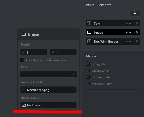

OK so I think I have found the issue (I hope it isn't just an error from ziping and unziping the project). In the settings of the image in the flex button you have not set the "pressed" image. Because of that the code was never properly generated for the image as you can see in MainMenuViewBase.cpp in the TouchGFX/generated/gui_generated/src/mainmenu_screen (fix the issue for one of the flex buttons and generate code, you will see that the code is different for the button fixed)
It is surprising that you (at least I) did not get an error message from this.

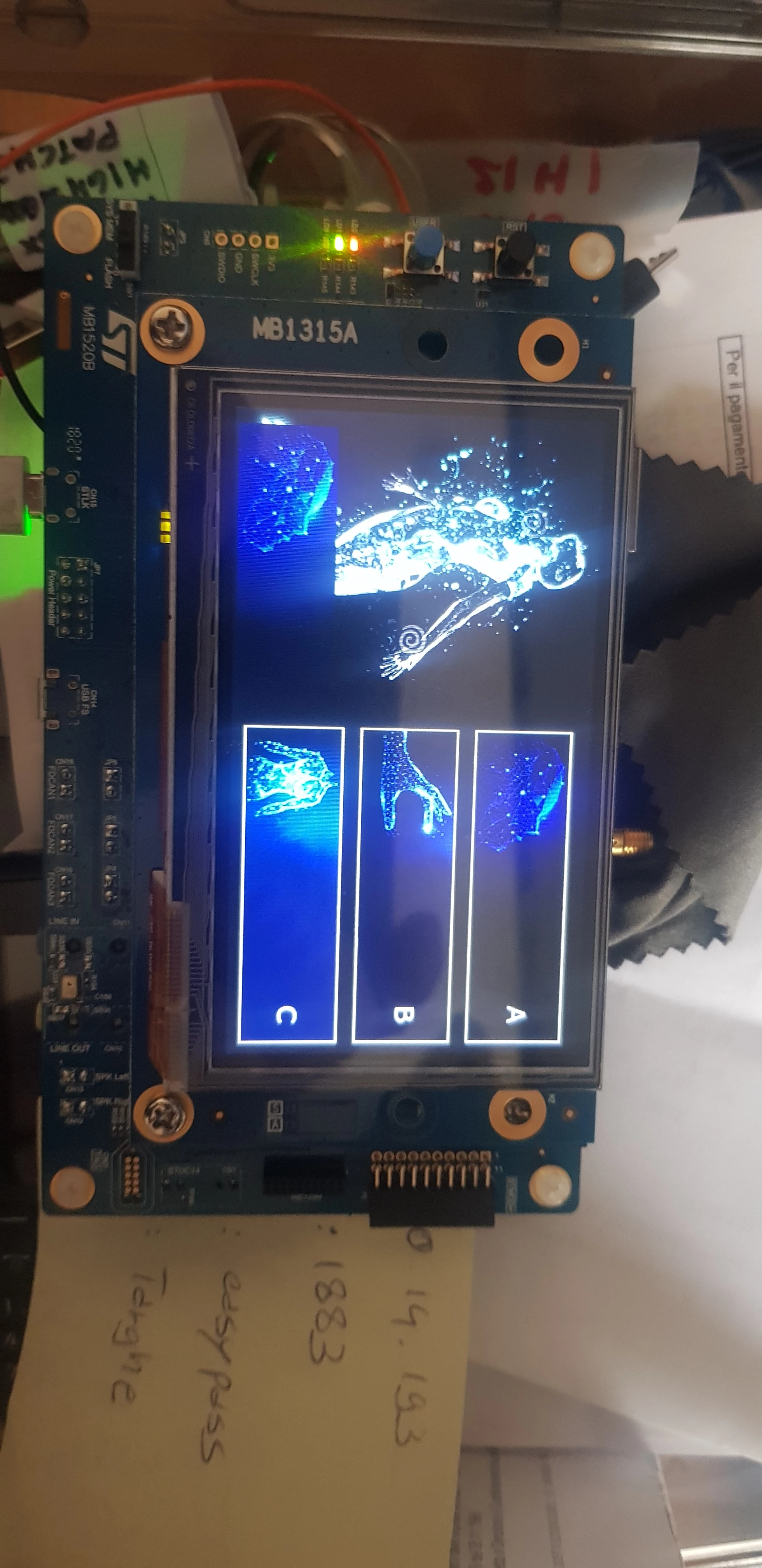

0693W00000DnHMTQA3.jpgBINGO !!!
I'd have never tought to this because i usually work on c# and delphi and if you don't specify a pressed image the controls simply use the released for both.
Thank you so much for all your help, Romain !
