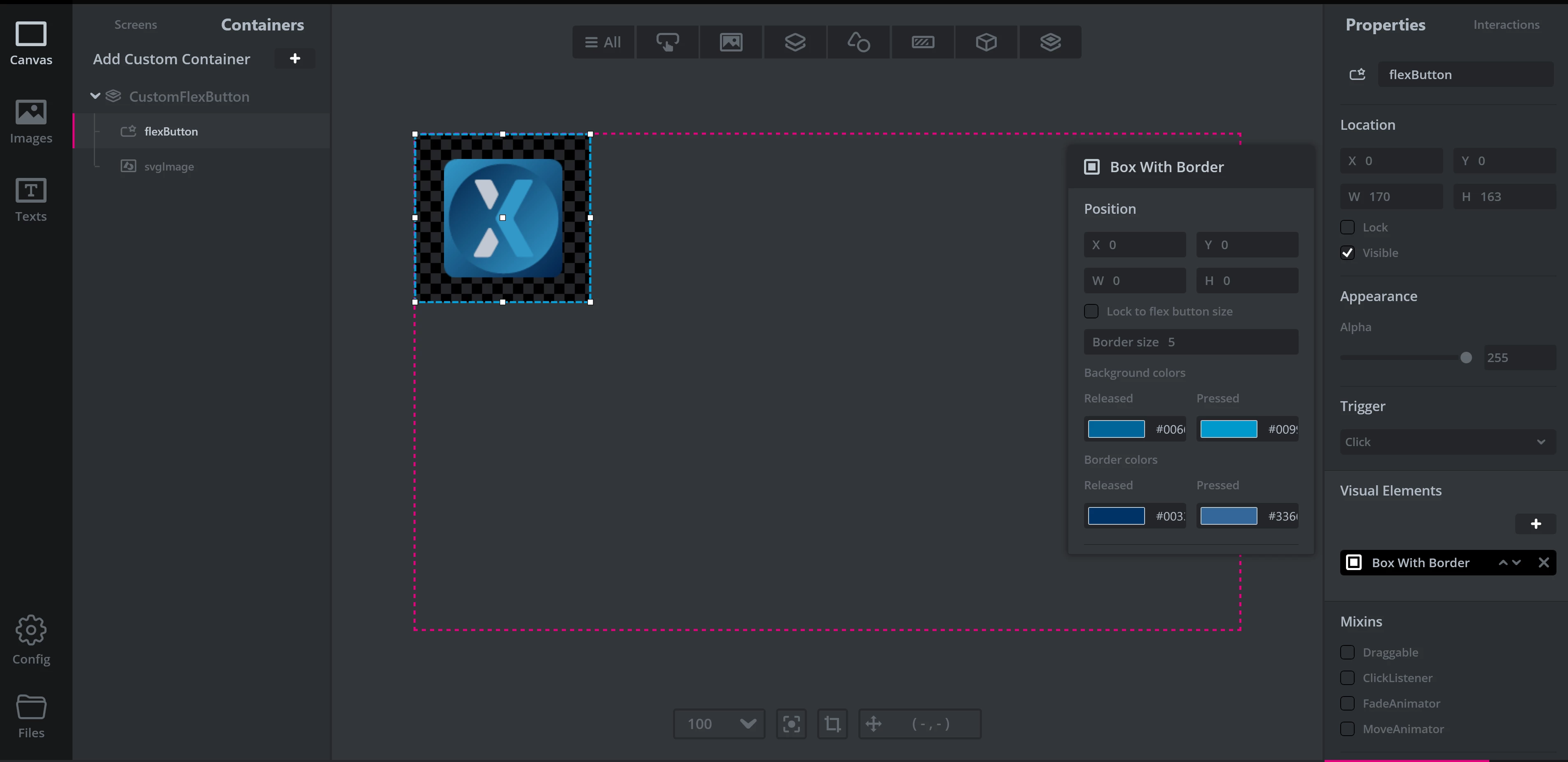

June 26, 2024
Hello @codebuk ,
Sorry for the late response.
After discussing with the team, we have decided not to implement this feature for now. So, I suggest converting your SVGs to PNGs, or creating a custom container with an SVG and a flex button where the width and height of the flex button's Visual Element is set to zero.
Setting the visual element of the flex button to 0Setting the visual element of the flex button to 0
I hope this helps!
Mohammad MORADIST Software Developer | TouchGFX
