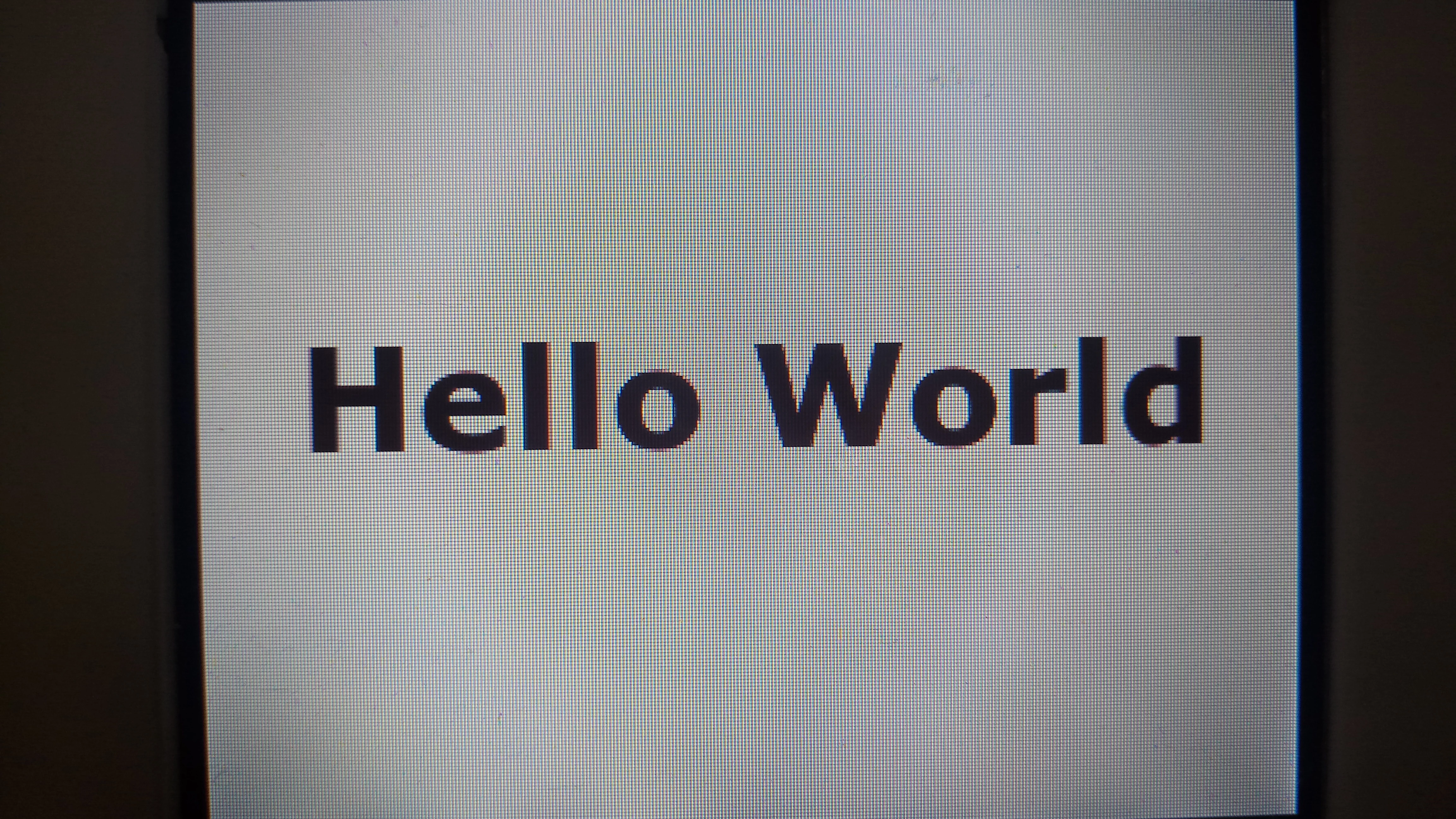

I have used the STM32F769 - Eval Board application template and modified resolution, & colour depth in MyApplication.touchgfx file, also made changes in stm32f769i_discovery_lcd.c & .h file since I'm using 24 Bit Parallel RGB .
i have verified the lcd driver file, it is working fine with atollic studio. My aim design and run target using the touchgfx designer .

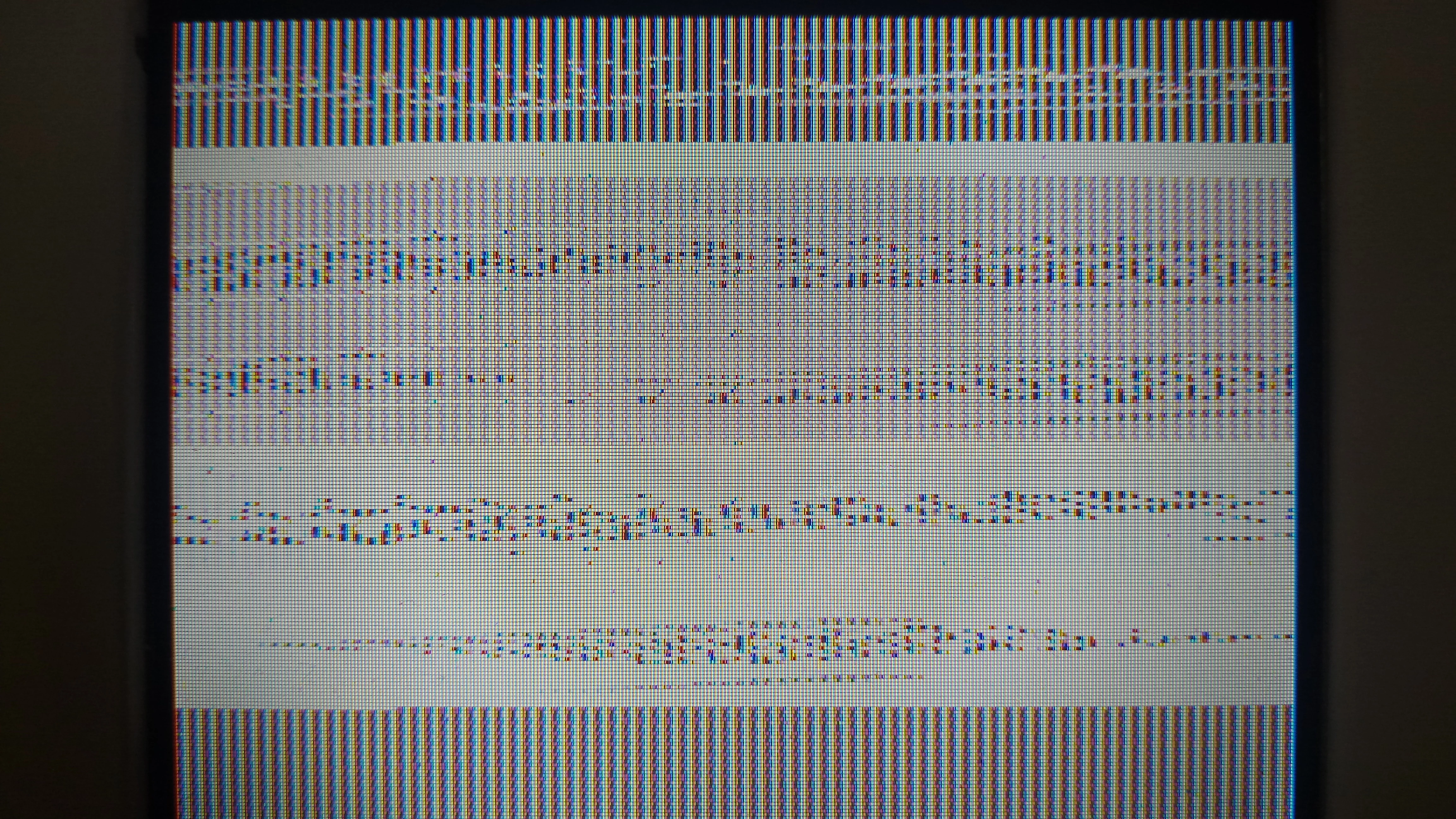

The Application works fine while using basic widgets like text & box, and i'm getting the output in LCD. If i try to add any image or icons the LCD becomes blank.
I have verified the application.map file the images are mapped correctly, also i have also verified initialization of NOR Flash and SDRAM. Also changed the corresponding External Flash Loader in MakeFile.
While flashing the target.hex file using STM32 ST Link Utility the result is same (Blurred Image).
PBU
PBUAuthor
February 21, 2019
Blurred Image
