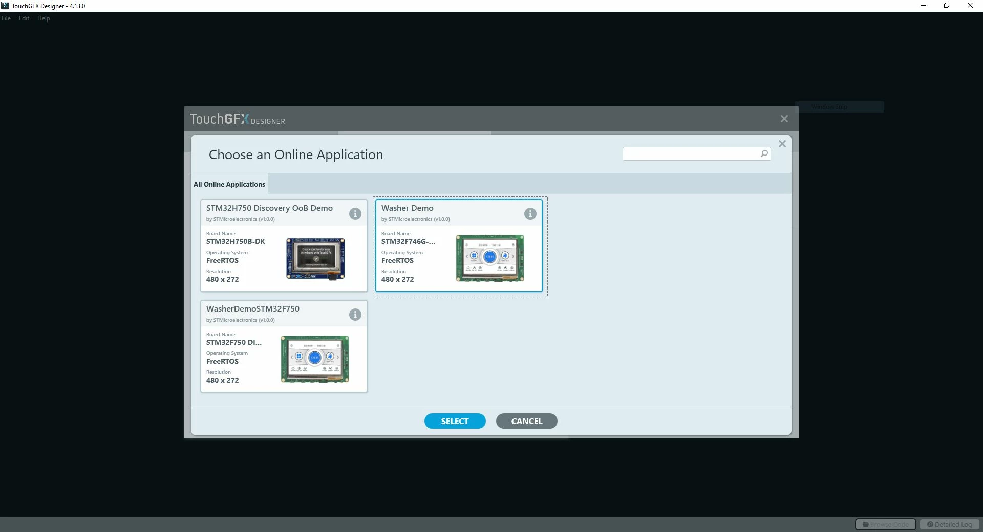

tushar_tp
January 23, 2020
Hello Martin,
I have installed TouchGFX 4.13 and I am not able to see the V3.0 templates in the online applications.
Where can I see the V3.0 templates?
Thanks,
Tushar
tushar_tp
January 23, 2020
Sorry Martin, I forget to change the board from Simulator to specific boards. After Changing to Specific boards I am able to see v3.0.0 templates

chaaalyy
Senior II
March 4, 2020
Strange... I built a template for CubeIDE 1.3.0, based on the blank ui. When it comes to choose another template in designer (file -> new), on the left i can choose "application template" STM32F746Discovery Kit in V3.0.0 but on the right side all the ui templates are 1.0.0, 1.1.0 or 2.0.0... Absolutely nothing in V3. Also in "online applications" i see just one app for the H750B-board and two washerdemos in V1.0.0 (as in the picture above). Of course i changed from simulator to my f746-board V3, but the shown apps and templates never change ...
