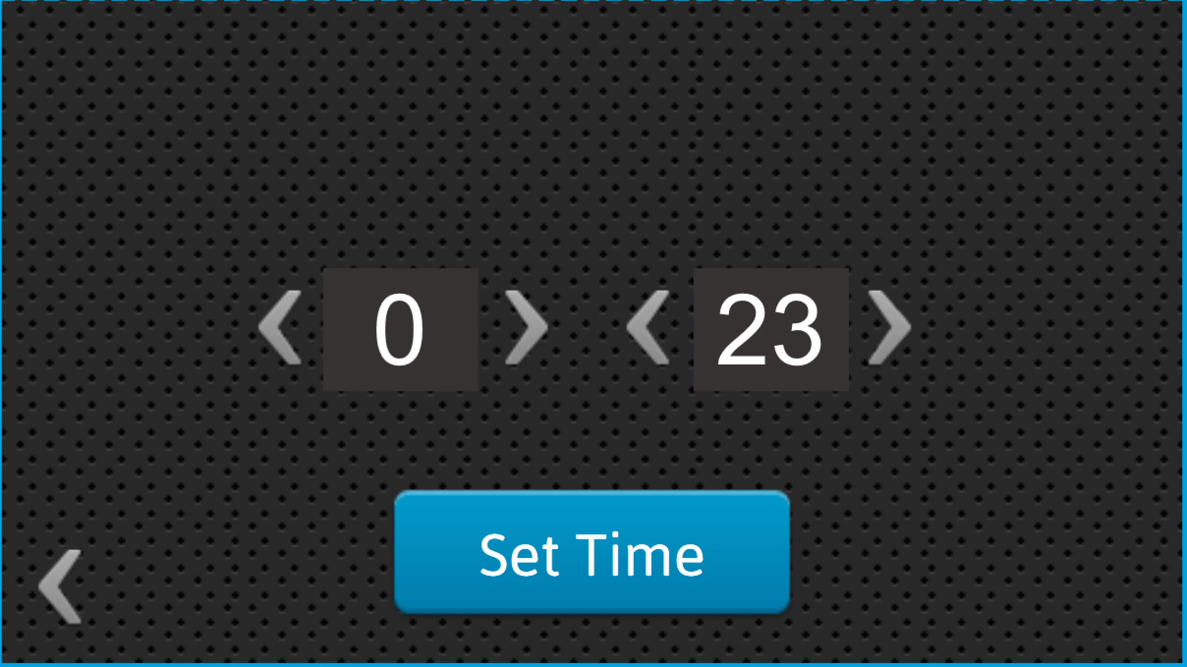

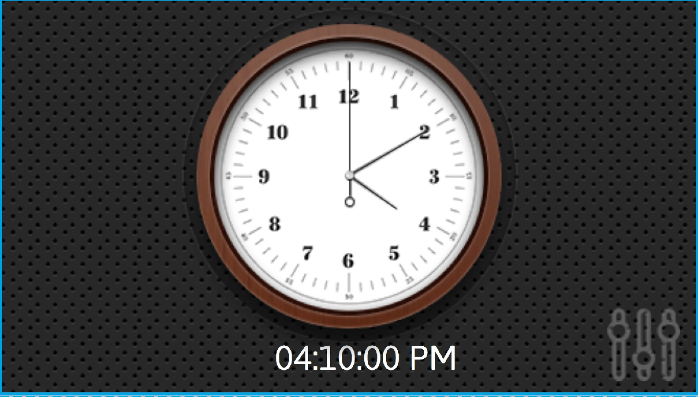

Hi I need help, I'm trying to learn your development ecosystem and I'm testing the Designer.
I was modifying an existing UI project that of the clock making the modification to create a second screen to make the modification settings of the clock. I quickly created the necessary keys and two text fields to be able to change the clock time.
Just to facilitate understanding, I attach the images of the first and second screens.

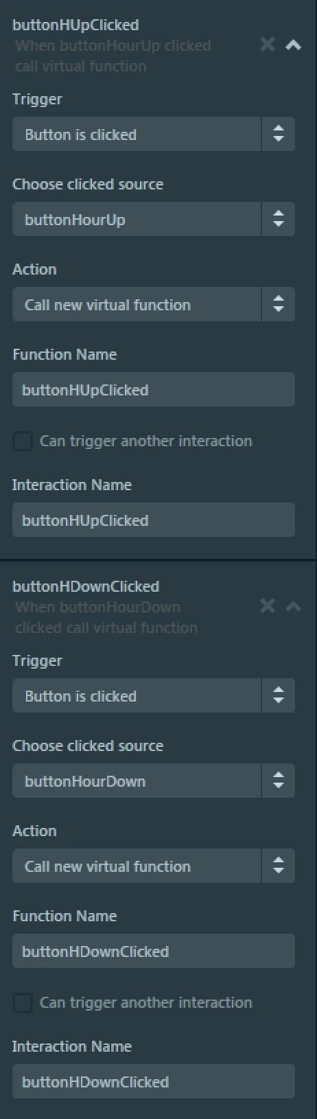

The problem is that I am unable to implement the various functions described in the tutorial that I report: https://support.touchgfx.com/docs/tutorials/tutorial-02, logically changing the names of the variables and anything else.
My problem is that while creating the interactions and setting new virtual function calls, I don't find them in the generated MainViewBase.hpp file as described in the tutorial.
I will certainly make some mistakes .......

Could you start creating an entire new project ?
Add a button to the GUI and create a interaction that calls a virtual function when you click the button. Generate the corresponding code.
Tell me if this generates the correct virtual function prototype in the Screen1ViewBase.hpp.
You are using TouchGFX Designer 4.13.0 right ?
/Alexandre

Thanks Alexandre for the reply,
I did as you said I created a call called ButtonCallPush and now generating the code I find it in the file.
So it works on the new file but not on the old one, I use version 4.13.0 exactly.
The file could be damaged then ???
Roby
