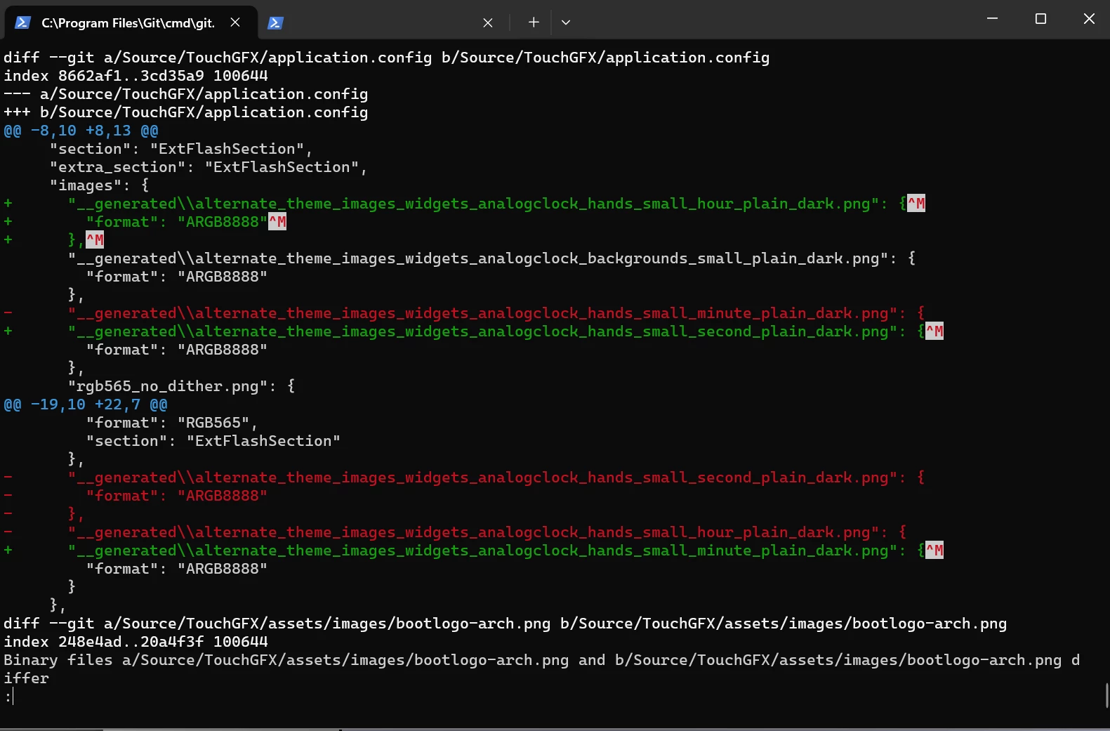

Feature request: preserve image order in application.config
In TouchGFX 4.26.0 image order changes in application.config even if those images don't change.
This causes unnecessary changes to show up in git:
Feature request is to either preserve the order or to have them always lexicographically sorted.

    Osman SOYKURT
    Apr 16, 2026 1:35 PM UTC
    Hello @unsigned_char_array ,
    Thank you for reporting this issue. We were already aware of it and are working on a fix. It appears to be a regression compared with earlier versions, as a side effect of the improvements made to speed up TouchGFX code generation.

    Osman SOYKURT
    Osman SOYKURTBest answer
    Oct 7, 2026 10:52 AM UTC
    Hello ​@unsigned_char_array  and ​@Marc_LM ,
    This issue has been fixed in the latest version of TouchGFX 4.27.0.
