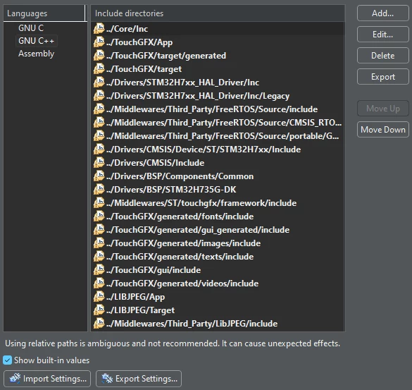

Make sure the project's Include Path points to the HAL include directory.
If auto-generated and not copied over at that time, use your file manager to copy over from the Cube directory to the project's.
VH-techAuthor
Jul 11, 2024 2:42 PM UTC
Yes, my projects include path points to the STM32H7xx_HAL_Driver/Inc... Is there any other file that I might be missing ?

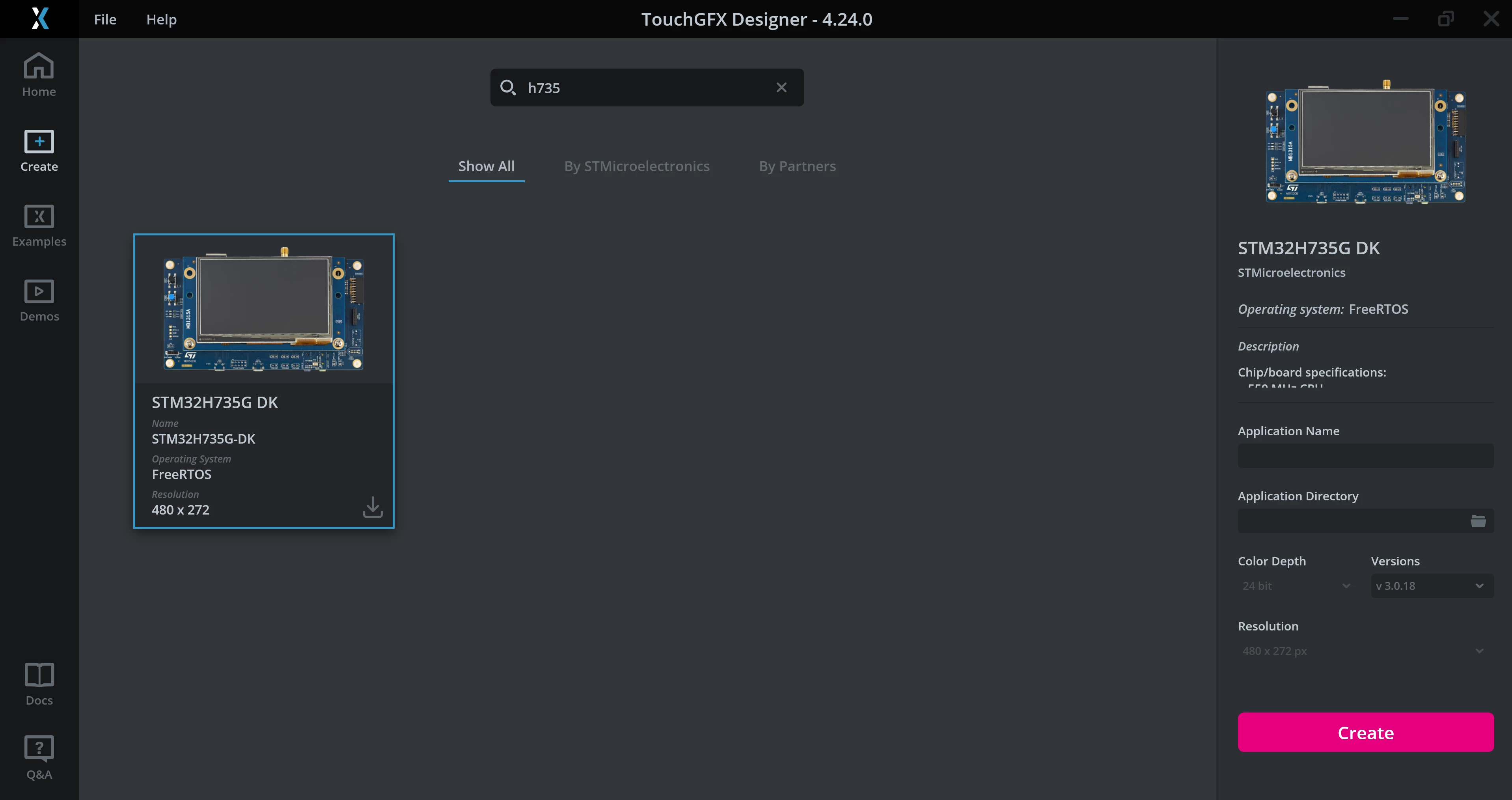

Hello @VH-tech,
I suggest using STM32CubeMX to open the .ioc file, and then you can enable I2C from there and generate code. Then, add your code through STM32CubeIDE.
So, you select the STM32H735G-DK from the TouchGFX designer and create a project:
STM32H735G-DK TouchGFX Board SetupSTM32H735G-DK TouchGFX Board Setup

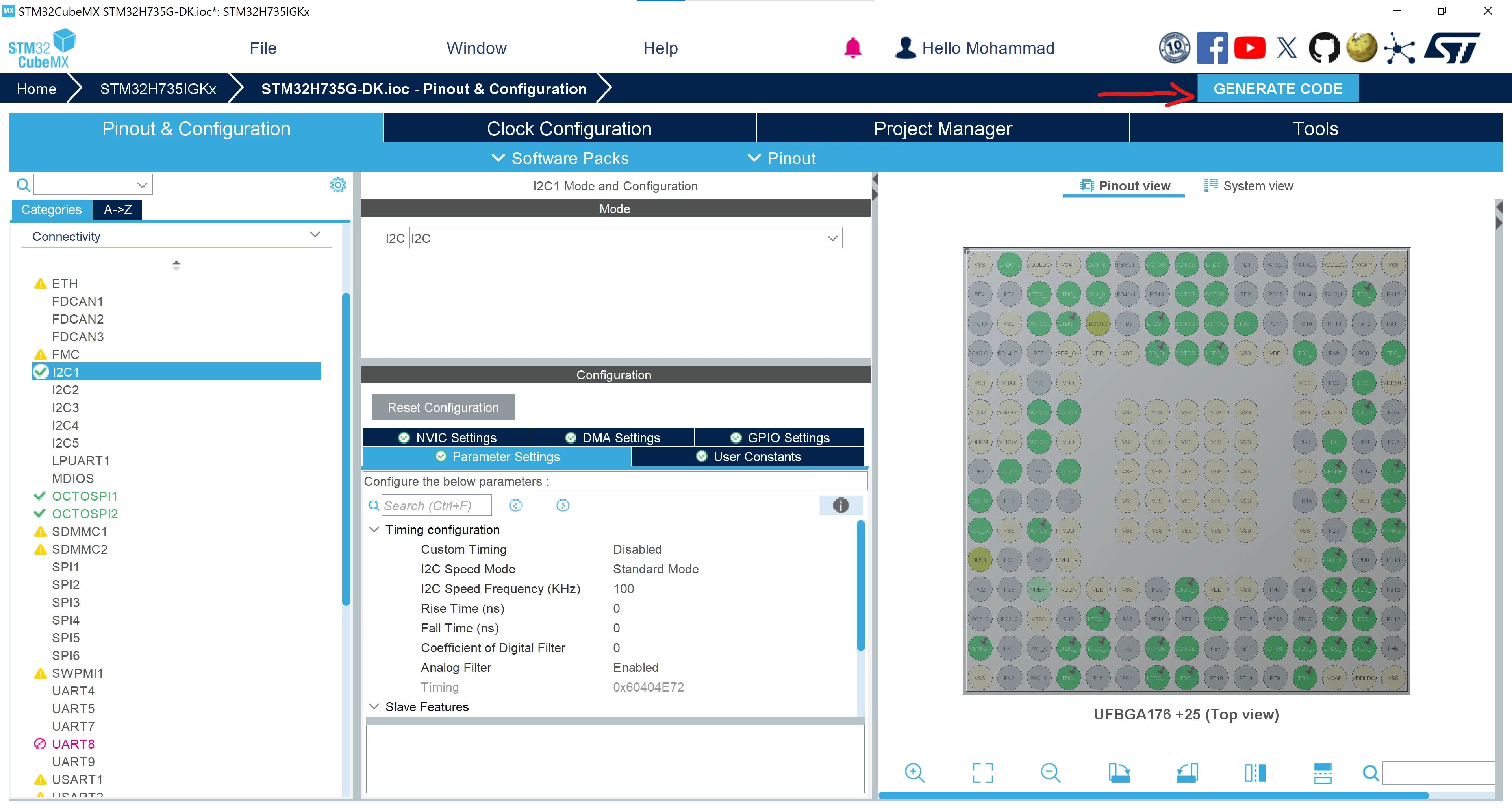

You navigate to one previous level of your TouchGFX project directory, and open the .ioc file using STM32CubeMX:
.ioc file.ioc file
Then, you enable I2C1 and press Generate Code:
Enabling I2C and generating codeEnabling I2C and generating code
After that, you need to regenerate code from TouchGFX as well, and then you should be able to compile the project from STM32CubeIDE without any errors.
