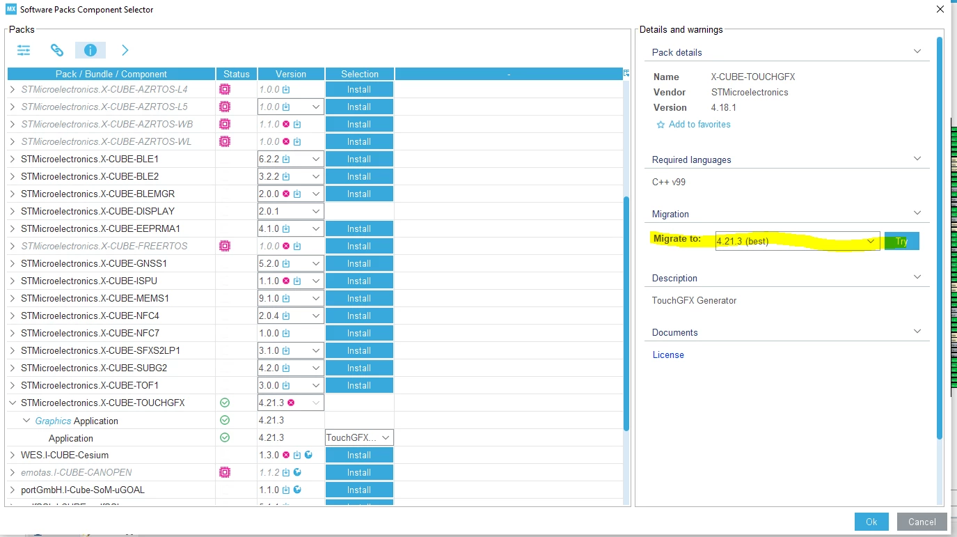

MM..1
Mar 28, 2023 3:39 PM UTC
I use other steps.
  1. IDE project open ioc
  2. Software package add latest TouchGFX if isnt allready here
  3. On selecting packages click on TouchGFX and open migrate panel (little hiden feature)
  4. Press migrate 18 to 21...
  5. Check and set TouchGFX 21 part all this in MX wizard
  6. Close wizard and generate code
  7. Open TGFx project or template generate
  8. Build

Your steps are the ones on my second attemps
Step 1,2,3,4

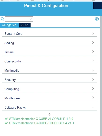

0693W00000aPMuPQAW.pngStep 5 I can see that the SW package is selected correctly in th .ioc

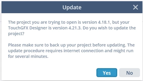

Step 7: I try to open the .touchgfx file with the designer:
0693W00000aPMvXQAW.pngAfter clicking yes it fails with the "Application.Toolchain" error
