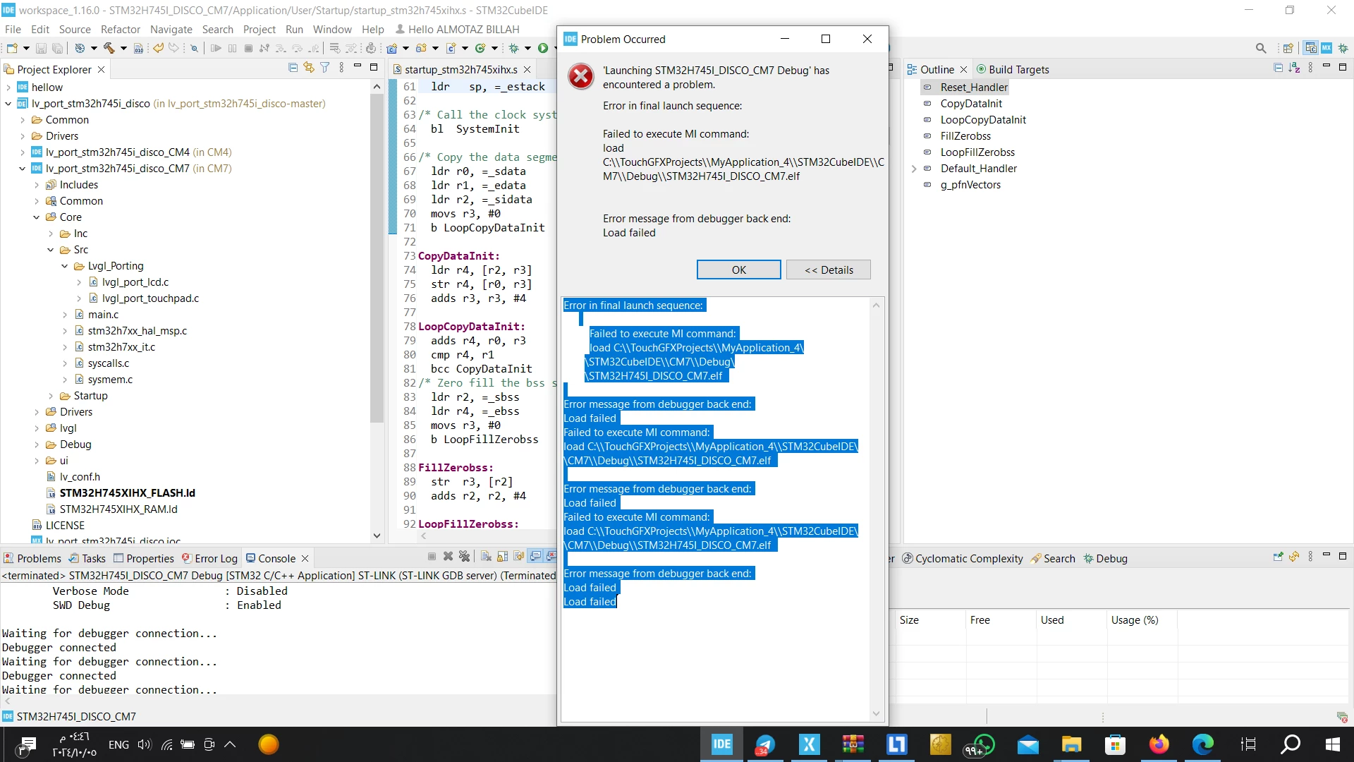

Failed to Upload Project to Microcontroller in CubeIDE
I create interfaces using the TouchGFX application and export them to CubeIDE. However, when attempting to upload the file to the microcontroller, an error occurs, even though the TouchGFX application can upload files successfully.

    But same question: are you sure your are configuring the Power mode in SMPS and not in LDO config?
