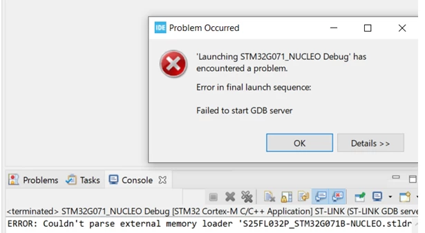

Im trying to start ith TouchGFX with the X-Nucleo-GFX01M1.
with CubeProgrammer I have the error : failed to download Segment[1].
Using TouchGFX 4.18.1 Designer is possible to download the GUI. So, there is not problem of comunciation with the PC.
Using STM32Cube come the error Failed to start GDB server. I have read on internet that this error is connected to window dll bla bla bla. ok. fine. I have reinstalled all Window10. No solution and the same error.
Using CubeProgrammer and load the file example provide from ST: GFX01M1_HelloWorld.hex I have the error failed to download Segment[1].

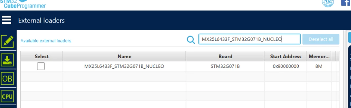

Are you using the external flash ?
If so, do you select the proper external loader in the STM32CubeProgrammer "EL" panel ?
If you do not find it in the STM32CubeProgrammer external loader list you need to :
  • close STM32CubeProgrammer
  • copy the MX25L6433F_STM32G071B_NUCLEO.stldr file from the gcc folder of your project to the folder : C:\Program Files\STMicroelectronics\STM32Cube\STM32CubeProgrammer.2.9.0\bin\ExternalLoader
  • relaunch STM32CubeProgrammer.
Note that STM32CubeIDE has its own embedded CubeProgrammer so the .stldr file must be copied to :
C:\ST\STM32CubeIDE_1.8.0\STM32CubeIDE\plugins\com.st.stm32cube.ide.mcu.externaltools.cubeprogrammer.win32_2.0.100.202110141430\tools\bin\ExternalLoader
see : https://support.touchgfx.com/4.18/docs/development/scenarios/touchgfx-on-lowcost-hardware#flash-loader

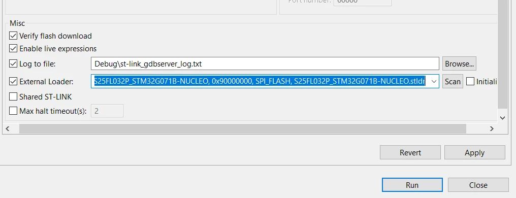

Hi
the CubeProgrammer has the file stldr  I don´t know if there was also before
0693W00000JMloZQAT.pngI follow your advice but I have still the same issue. I got it is diifficult to understand the issue, so i try to give you so much infot as possible. Following step by step. I have also attached a file word with the images.
  1. Create a prj with TouchGFX called Prj_v1 (it is just a white screen with a button)
  2. Generated the code
  3. I open with STM32CubeMX the file .ioc in Prj_v1 /TouchGFX
  4. Check the library TouchGFX are loaded
  5. with STM32CubeMX generate the code
  6. Open the project generated by STM32CubeMX with STM32CubeIDE 1.8.0
  7. Compile
  8. close STM32CubeIDE 1.8.0
  9. move the MX25L6433F_STM32G071B_NUCLEO.stldr in the folder C:\ST\STM32CubeIDE_1.8.0\STM32CubeIDE\plugins\com.st.stm32cube.ide.mcu.externaltools.cubeprogrammer.win32_2.0.100.202110141430\tools\bin\ExternalLoader
  10. open again STM32CubeIDE 1.8.0
  11. compile
Thanks in advance
Fausto

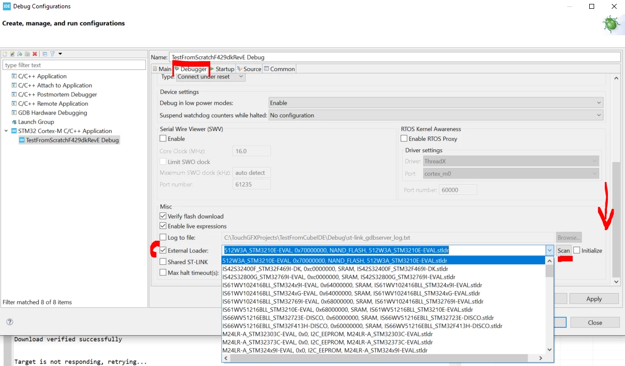

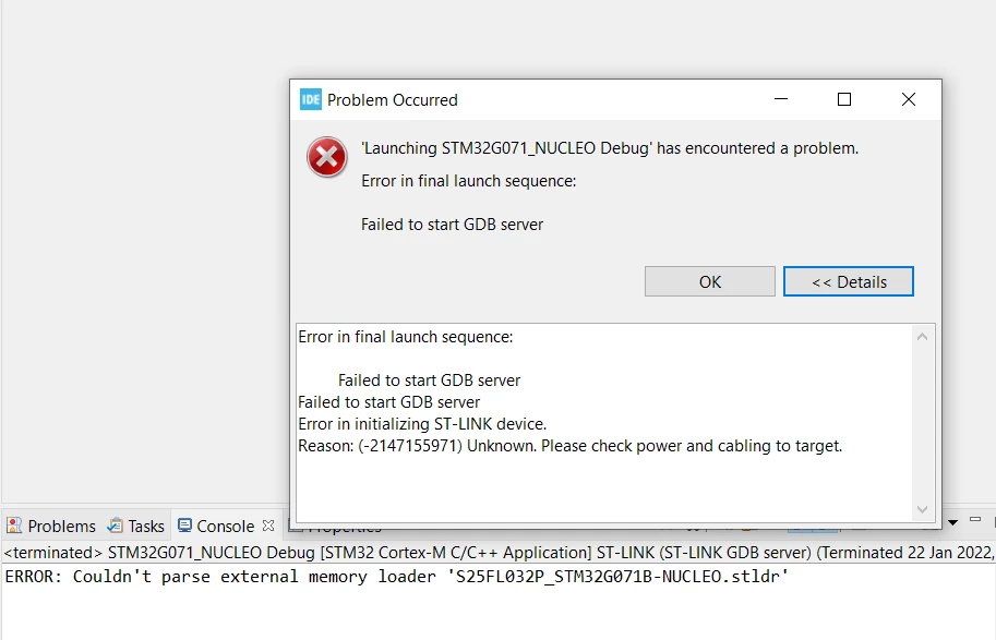

Romain DIELEMAN
January 21, 2022
You can see in the error message at the bottom of your last picture that the external loader used is the S25FL032P and not the MX25L6433F. So you have properly added the MX25L6433F to your repository but you have not actually set your project to use it. To do so, click on either the arrow next to the debug or run options and go to the "Debug Configurations" or "Run Configurations" menus (in the following picture I go to the debug one).0693W00000JMo15QAD.pngWithin that new view, go to the Debugger tab, scroll down to the bottom and check the external loader used. If nothing is shown press the scan option and go through the list to select the correct version.
/Romain
FTrom
FTromAuthor
January 22, 2022

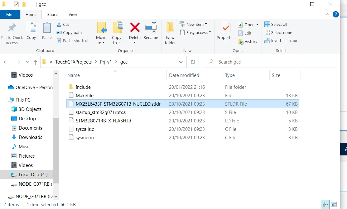

I have followed your instruction and the S25FL032P_STM32G071B-NUCLEO.stldr was already selected.0693W00000JMw7KQAT.pngI did anyway a scan again-
When I compile it , I have the same error.
0693W00000JMw7yQAD.pngin the prject folder there is MX25L6433F_STM32G071B_NUCLEO.stldr. Should I change it manually with S25FL032P_STM32G071B-NUCLEO.stldr ?
And where could I find this file?
For my curiosity I have selected MX25L6433F to see what could happen given that in my project folder i have only that....and something strange happened:

ST-LINK device status: RUN_MODE
Device not halted(0), performing Ctrl-C
GDB session, device event: 4
Device halted
ST-LINK device status: HALT_MODE
GDB session, device event: 0
GDB session terminated: Client connection lost
GdbSessionManager, session terminated: 1
GdbSrv, master session terminated, signal dispose
Shutting down...
Stopping port 61234
Received stop for port 61234, not accepting new connections.
GdbSrv, deInit entry.
GdbSessionManager, deInit entry.
GDB session disposed: 2
GDB session disposed: 1
GdbSessionManager, deInit exit
SwvSrv deInit entry
Stopping port 61235
Stopping port 61234
 is it correct all of these instructions?
Fausto
Romain DIELEMAN
January 24, 2022
You misunderstood my message. You should use the MX25L6433F_STM32G071B_NUCLEO.stldr and not S25FL032P_STM32G071B-NUCLEO.stldr which was the one set in your project.
I'm a bit confused about the "switching context" messages but it might be something expected.
/Romain
